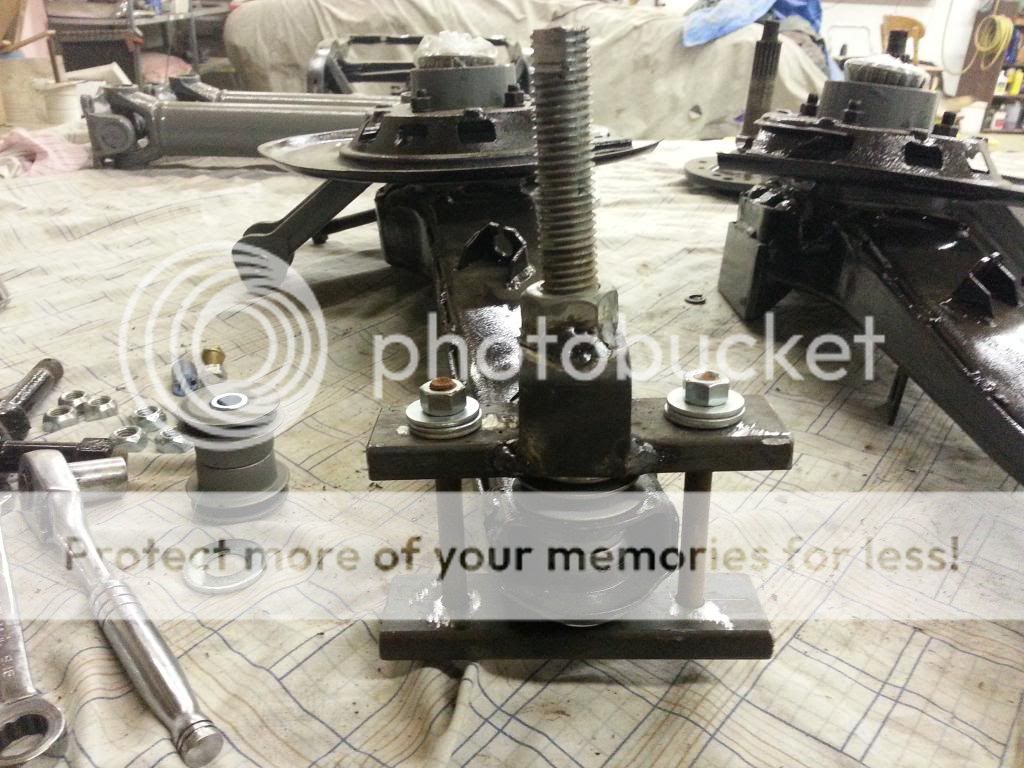

Well wife and kids were gone for the evening so of course to the car! Trailing arm bushings came in so I figured I would tackle that first. Made myself a install tool.
Thought I could thread the rod in to flare the pipe. Wrong. Ended up grinding off some of the thread in the middle so it could be hammered. Left the thread at the end though so it would hold itself up out of view when lining up.
Went well. Should have built it a bit beefier but it did the job.
