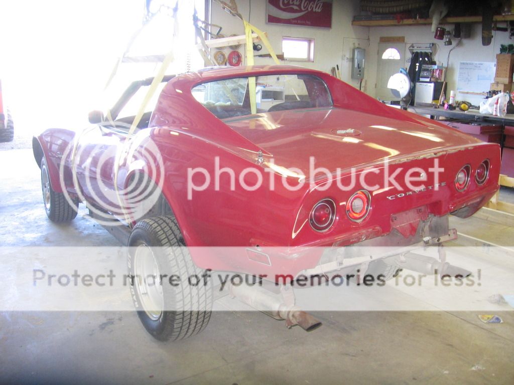

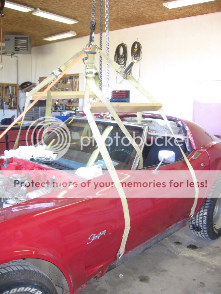

Well after the car not coming out of the garage all year I finally decided to pull the cover off. Connected the battery. Turned the key. 10 Seconds of cranking and fired up. Then I drove it 200ft into my shop and proceeded to make it not drivable for awhile. I was planning to start this in the spring but the summers are way to busy. So after disconnecting a wires, brake lines, steering, body bolts, removing hood, removing radiator and frame, draining fluids (or so I thought), disconnecting grounds, etc. this is the result.....
BEFORE:
DURING:
AFTER:

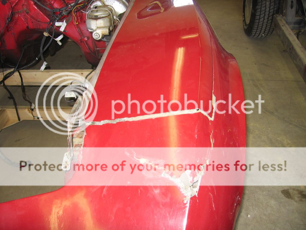

It went pretty smooth considering I did it by myself. However it was not flawless. The crack (that has been there since I bought the car) in the front clip wasn't strong enough to hold the front and let go, even with the strap to the front:
Needless to say when it gave away I thought the whole body was falling to the ground:eek:. Now like I said there was a crack there before so I am not surprised this happened.
All in all it went very well though. Now for the rebuild! This one will be slow and steady for sure so don't get upset if there isn't updates for a while.

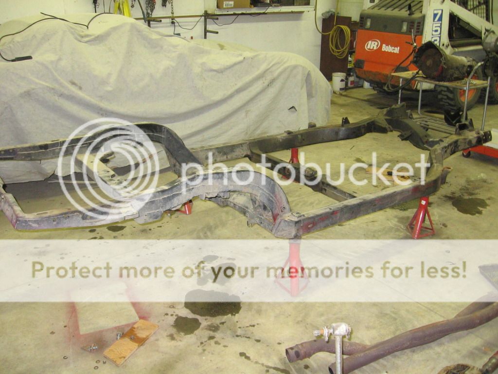

Ya the frame looks pretty good just some minor fixing and updating. The back of the main rails the cap is rusted out on both sides but the rail looks good so just a patch up. Like I mentioned in my original post I am going to make the trans. crossmember bolt in like the stock style while the body is off. The birdcage looks like it may have some problem spots though. I'll find out more when I get to the body (after the chassis). And ya I am lucky enough to have the shop space (separate from my garage) so I can take my time. Now if only I had a money tree.....

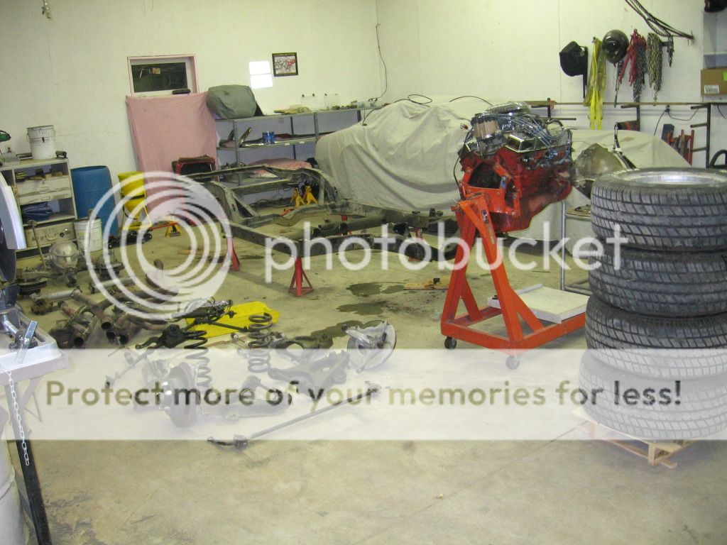

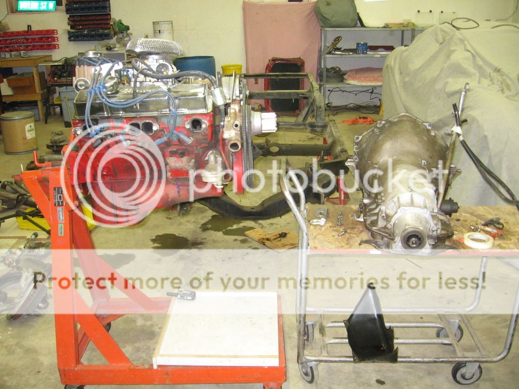

OK, more work done. Engine and tranny out and chassis stripped. Ready to weld and gusset. Going to change the tranny crossmember to bolt in while I am at it.
Just some proof!

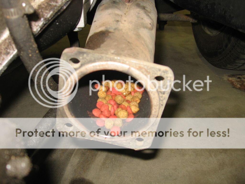

And some surprises along the way!
No wonder it was smoking out the right side exhaust. The mice carried in dog food!

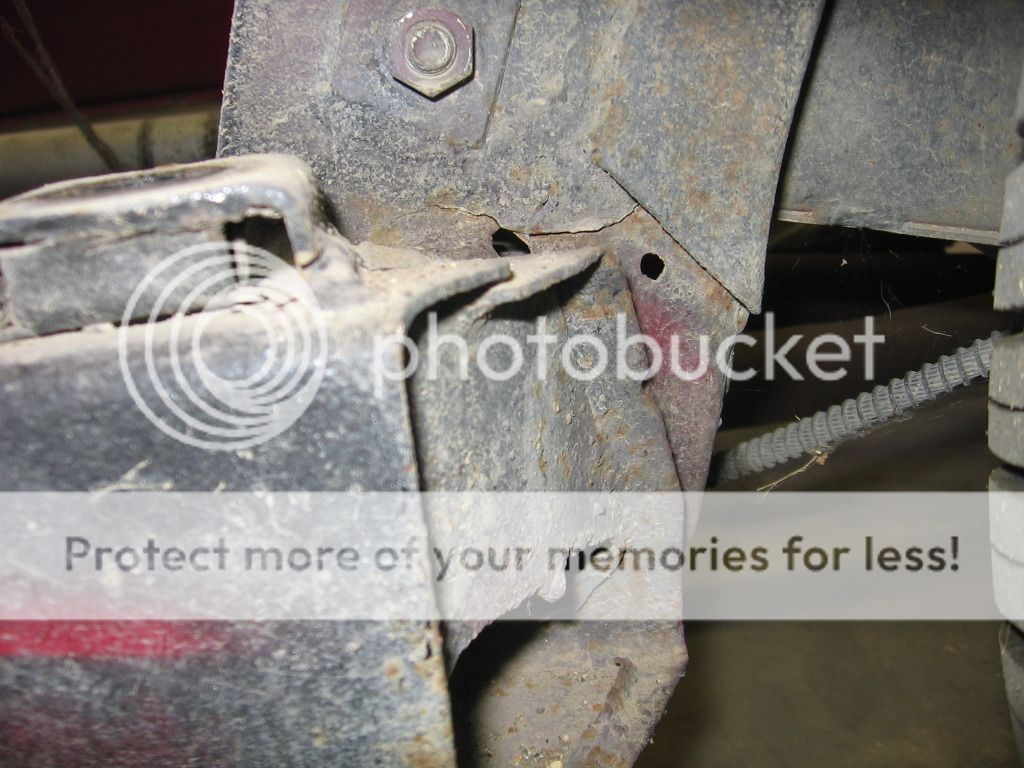

And I am glad I started this project. This crack probably would not have lasted much longer.

Cool...dog food in the exhaust. What will mice think of next?

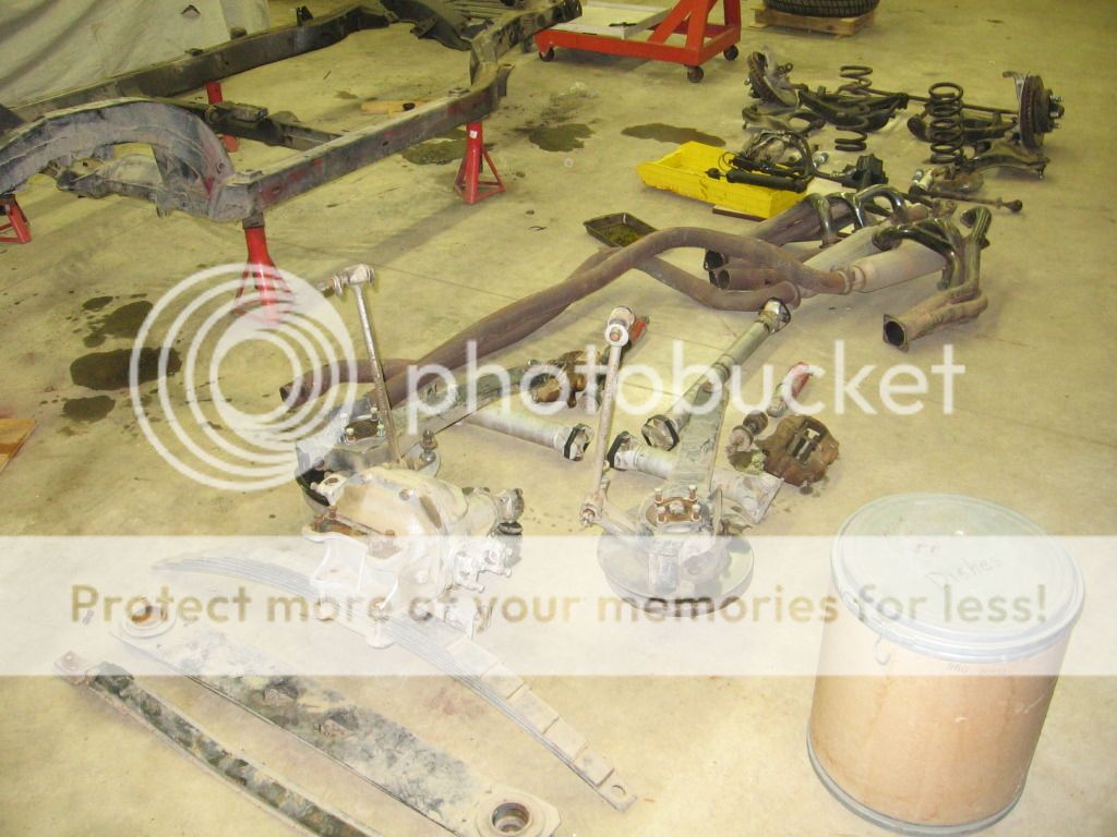

Just a quick update. Got the front Control Arms and spindles disassembled. Amazing how one bad (rust welded) bolt can cause so much problems. Took me about 2.5 hours to take apart the passenger side carrier because of one bolt. I had to cut it of and drill it out, after trying many other things. Then the drivers side carrier took about 10 mins. Good news though everything looks to be in good shape and re-useable. Will definitely be putting in ne rubbers everywhere though.
Anyway. Slow and steady getting it apart.
