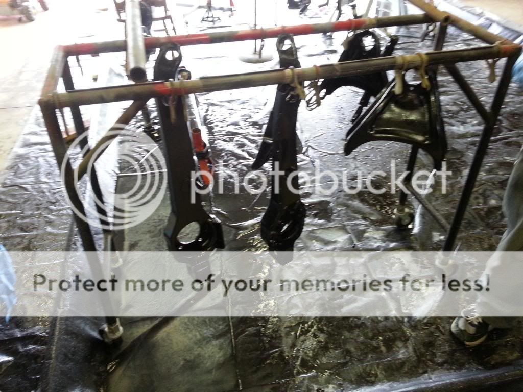

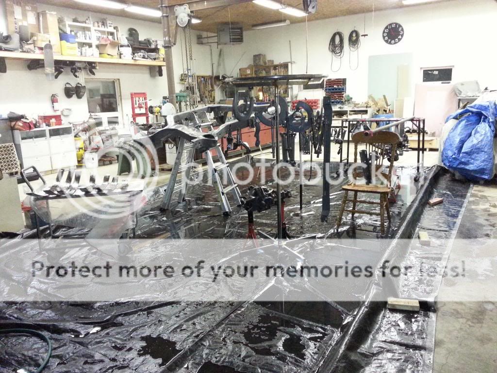

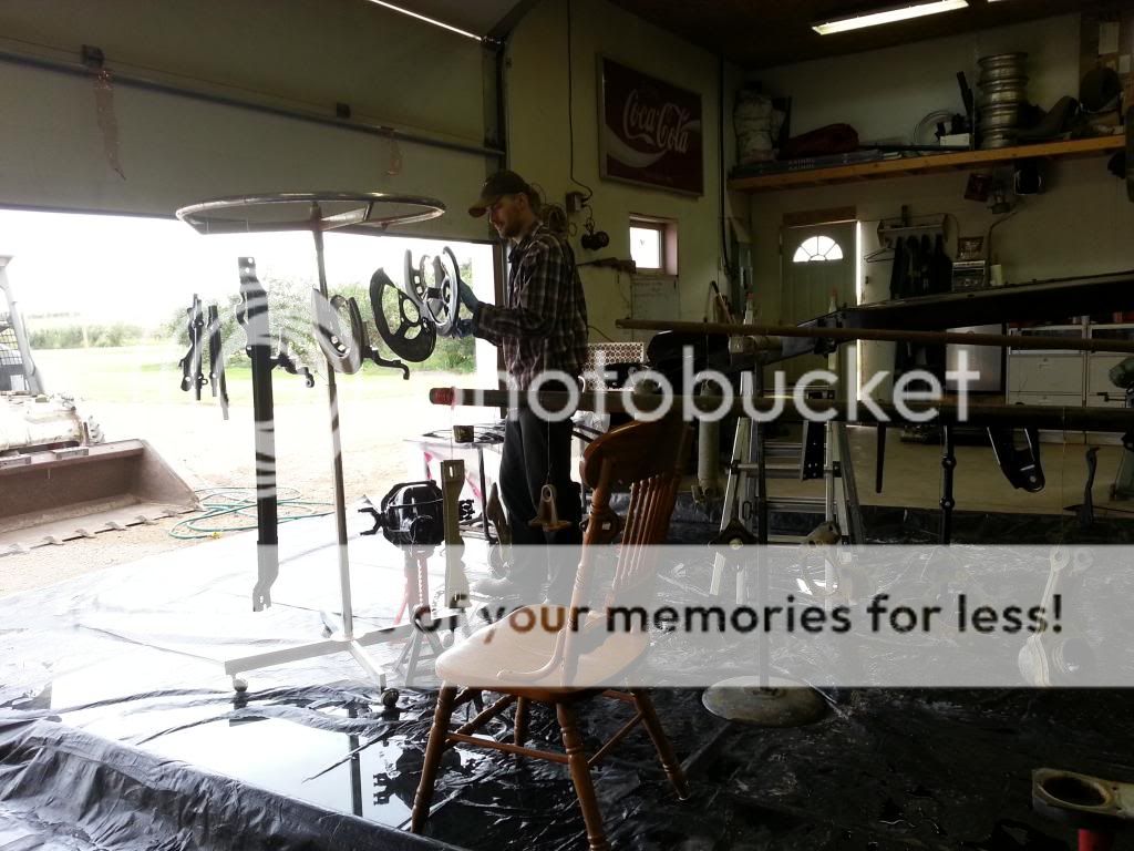

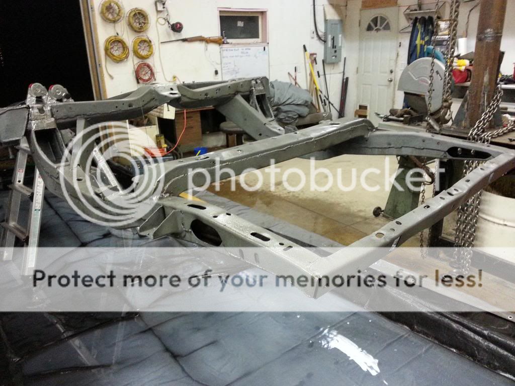

Was able to sneak in a weekend of painting. Started Friday night(after the kids were asleep and work late to get the first two steps of the POR15 process done. Then cranked the heat in the shop so it would dry by morning:

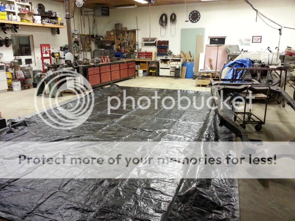

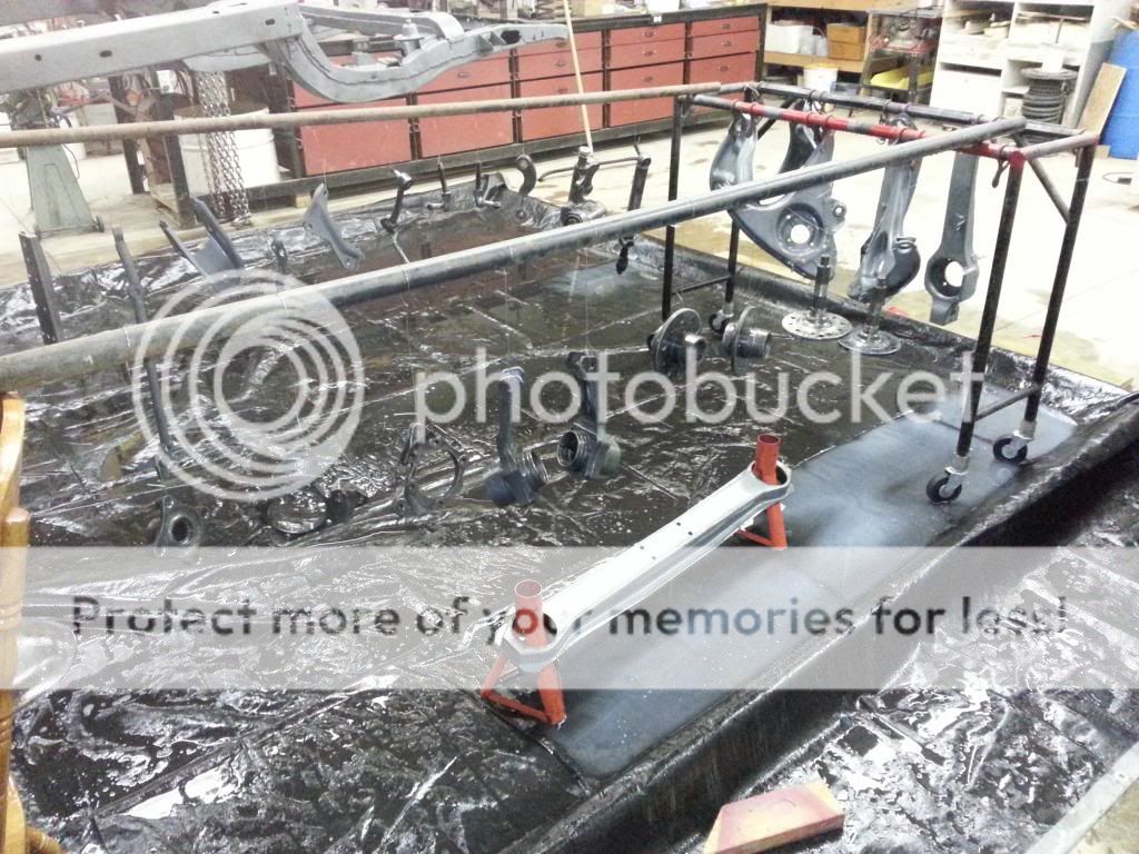

Had to make a wash down tray since my shop doesn't have a drain in it.

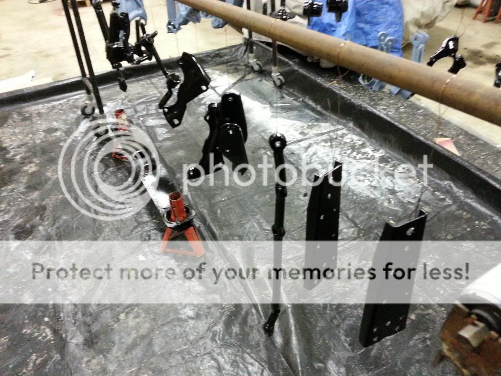

Then hanging all the parts up. Took up a lot of space. Luckily I have a very nice space to work in.

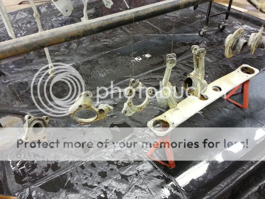

Mix Marine Clean about 5:1 with hot water and spray on using a spray bottle. Took about 20 mins to spray everything. Keep soaked for another 20 mins. Then wash off with hose. (this was painful to spray water on my blasted parts, but hey following directions)
Next put straight Prep & Ready into spray bottle and got to town on spraying everything. Keep soaked for 30 mins. Then wash off again.

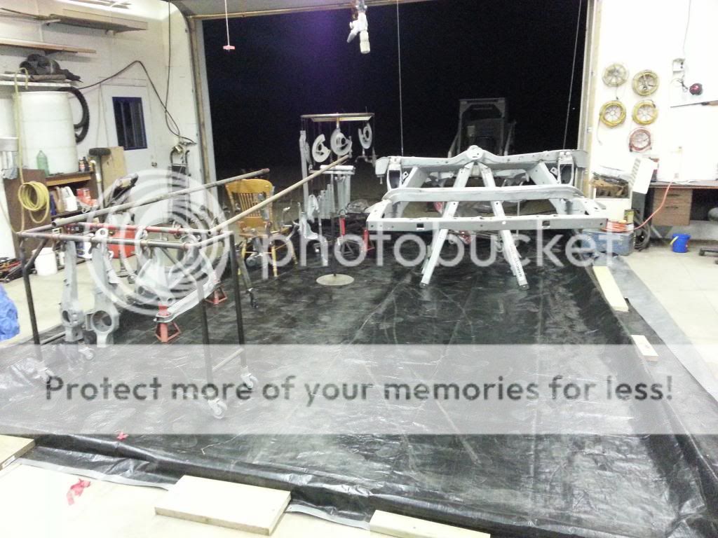

It was about 12:30 at this point and I told Riley to come out for a 7:00AM start on painting so I cranked up the heat for the night to get everything dry. I left some water in the tarp tray so the shop would be humid in the morning. POR say it cures better in areas above 70% humidity( or something like that)

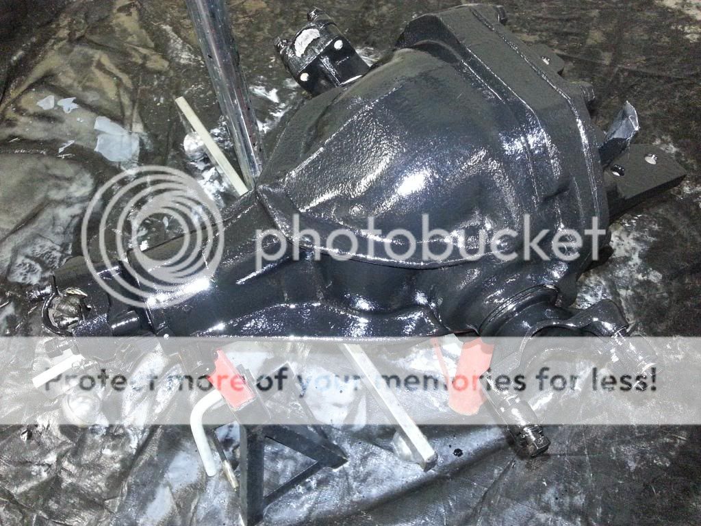

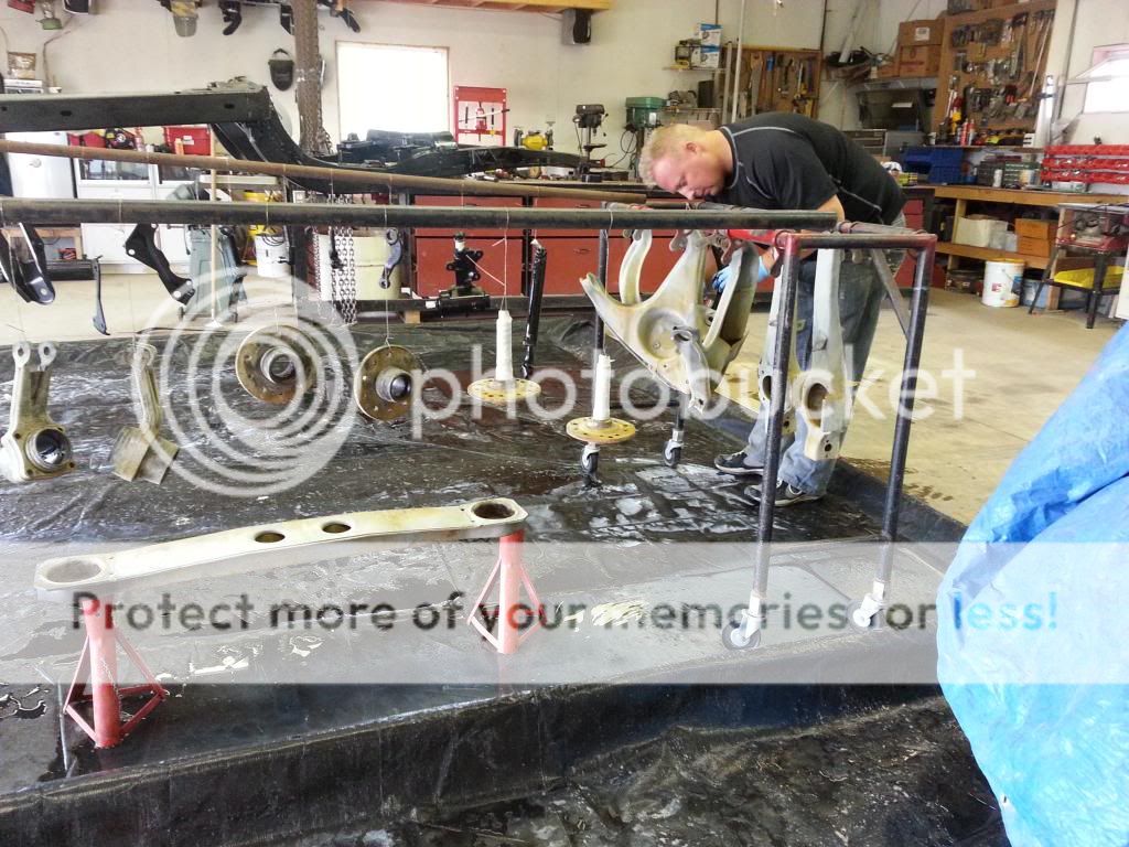

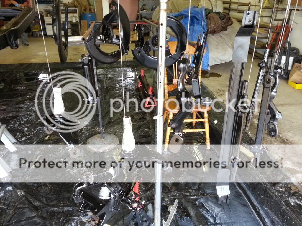

Started coating on the POR15. I was skeptical about the 1 quart being enough but this stuff is thin. Really thin. I was amazed how well it covered the metal though.
Proof that I do work on this car. (And Riley too)

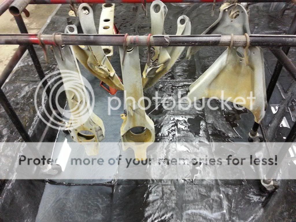

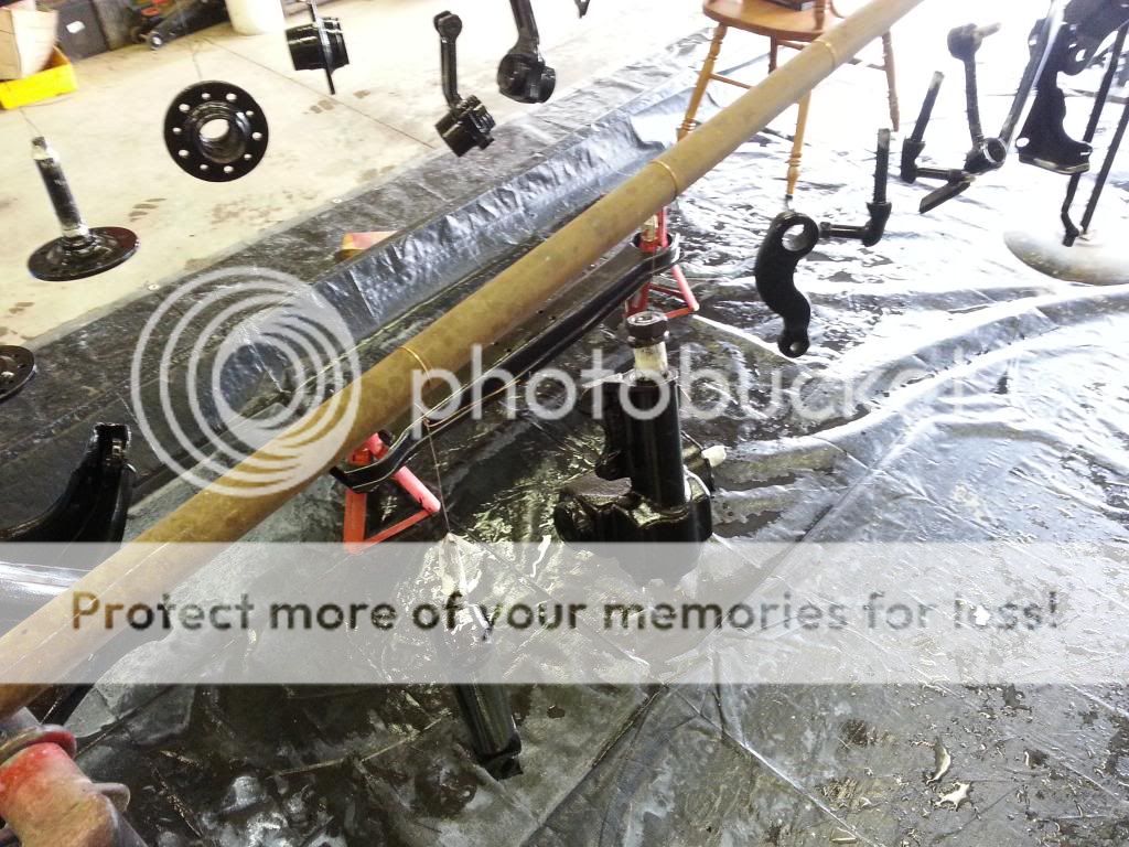

First Coat:
Second Coat:
Good enough for a Saturday. Gave Riley some lunch and called it a day.
Takes 24hrs to cure for topcoat so closed up shop and waited....

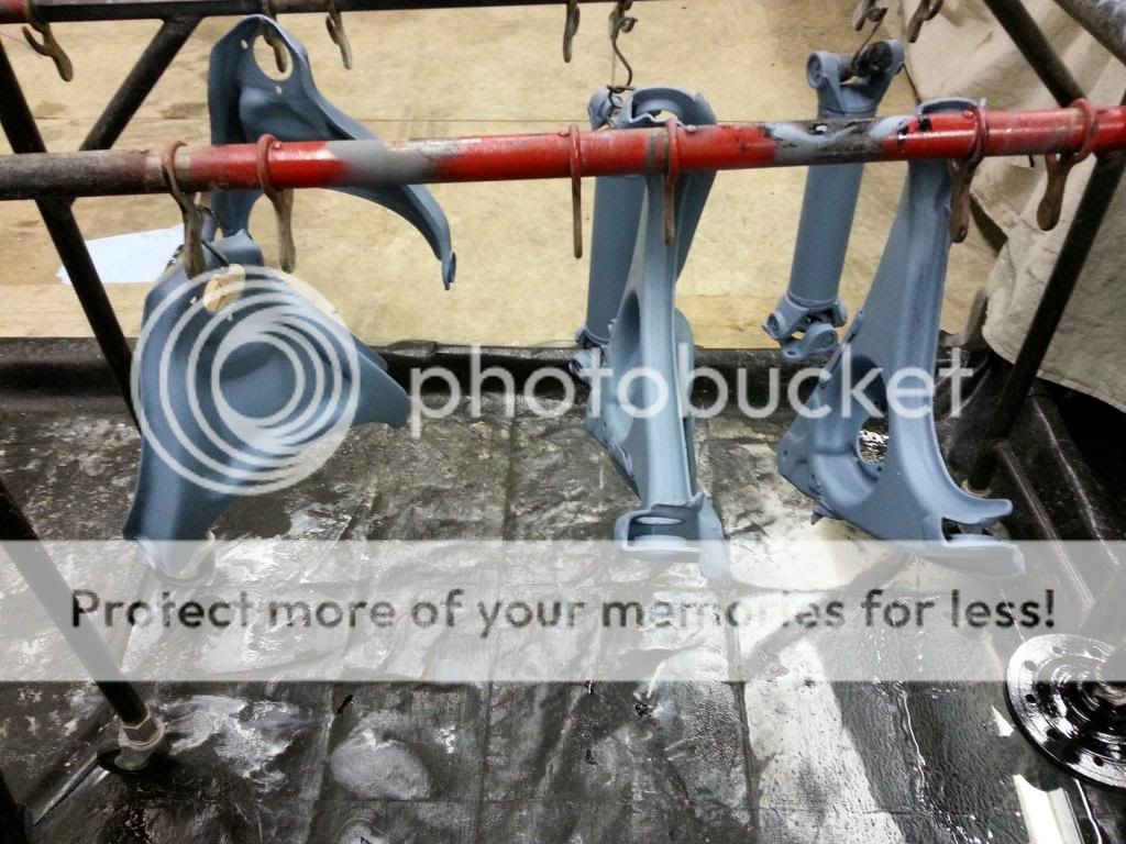

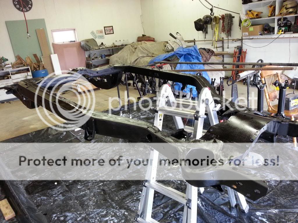

On Sunday I started with a light 320 grit sand down. Then I started priming the parts I wanted to be a contrast color (probably red). Used the primer made for POR15. I was not happy with how the primer covered the POR15. I was actually a little worried after this first coat. But the second coat filled everything in and it looks pretty good. just gonna have to sand out a few runs.

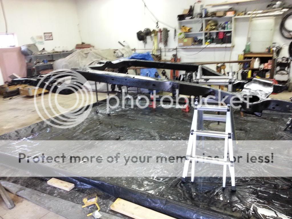

Than after the Rider Game I top coated the rest of the parts with the POR Black Cote. Went on nice. Hard to tell where I had been though. Should have POR'd a contrasting color. Oh well looked pretty good anyway.
Don't have a nice clear pic of the chassis. Will take some more when I get home and take a look at the finished product.
All in all a good process. Not a fan of the primer so if I ever did this again I wouldn't bother with another color. I painted a few random things around the shop with the little bit of left over POR15 as a test. Painted a hammer, trailer tire rim, Riley used a bit on his truck, and a little bit on the chop saw stand. I am curious to see what happens when I use the hammer.

Well painted the rest of the chassis parts. Smoke Grey. It isn't as dark as I thought it would be, but it will look good. Will get pics eventually, been busy planting trees at my house. Planted about 160 this weekend. Going to spray a coat or two of clear on top then just waiting for parts. Got a shipping notice so should be late this week or early next.
