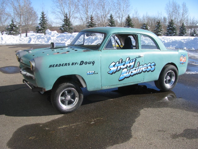

Perhaps you could look around for a deal on a vehicle which is built/setup for drag racing . They can be very reasonable in price and a lot of fun.
WILLYS GASSER DRAG CAR  Old school  just finished in Classic Cars in Red Deer
Like this one for example.
