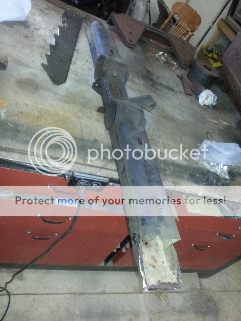

Well found some time again. Managed to stop by my old professor's house to borrow a trans. crossmember to mock up my frame with. He is just finishing restoring a 73 as well. And he even live between me and the city so it isn't out of the way at all!
Got the old crossmember cut out:

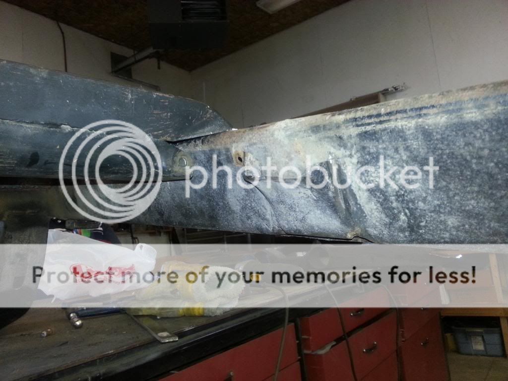

Bolt in crossmember to build top mounts. The frame sprung a bit on my from cutting out the old crossmember and welding so it ended up being a little wider than stock (1/8"- 3/16"). To fit the crossmember I had to pull the side rails in. Notice I purposely left some of the old welded section of the original crossmember. It will look good at the end.
Bend up a piece and fit it in. Weld and grind beautiful!
And now I can build my custom cross member to hold my yet to be determined transmission.

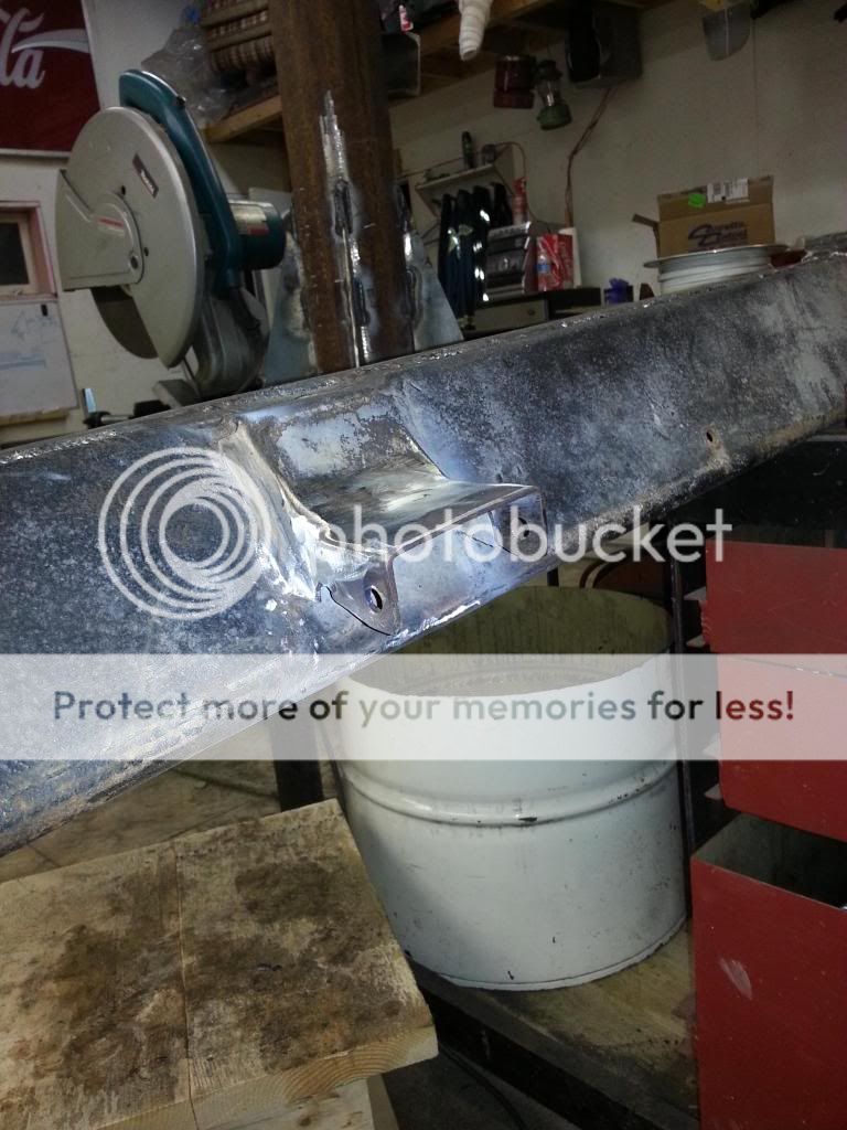

Well not painting yet but on my way. Chassis is blasted as well as some parts. Any parts with detailed or machined surfaces I opted to wire wheel myself. When I got the chassis back into the shop I noticed a few more fixes to be done. Nothing to major mostly small holes. I did however decide to redo the pass. side dog leg cap thingy. After blast it had plenty of holes and the welds were poor. So cut it off and manufactured a new one. Sorry didn't get a before pic this time.

beautiful job taylor....very professional looking. from what i can see all the bolt-on's appear to be in good shape. i don't think the clear coat would last like the por 15, do you ? a little anti-seize on the sombrero's will make any future removal of the rear c/m a bit easier. looks great brother !!! :D
Looking good Taylor. That will be one fine looking shark when your finished.
