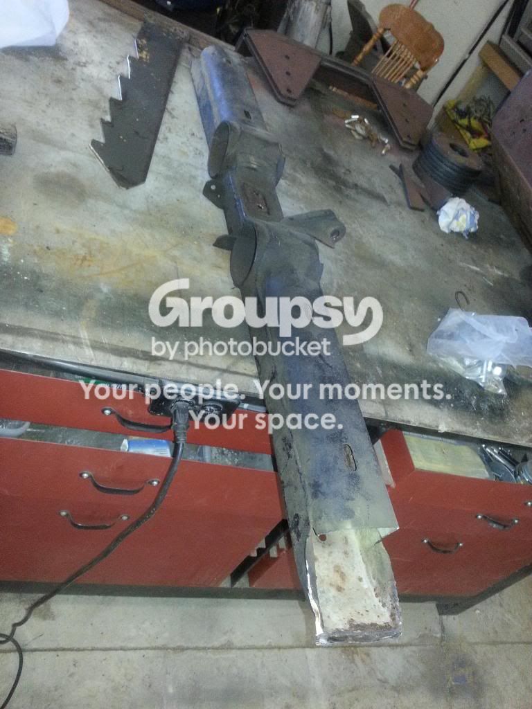

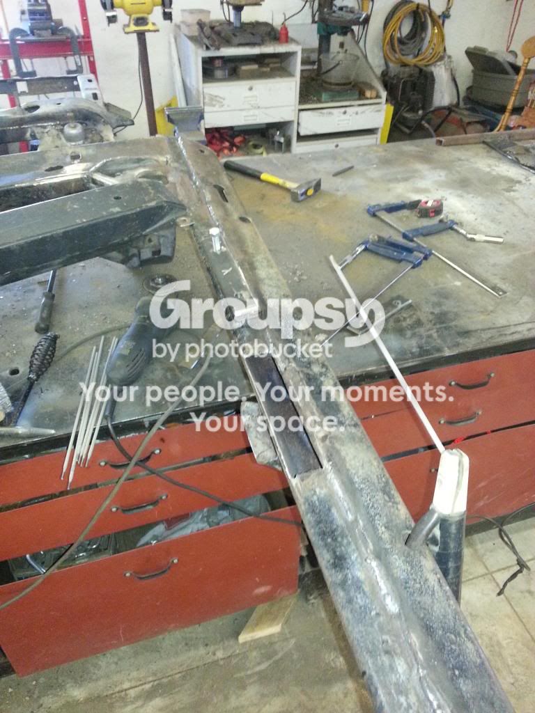

Got the old crossmember cut out:

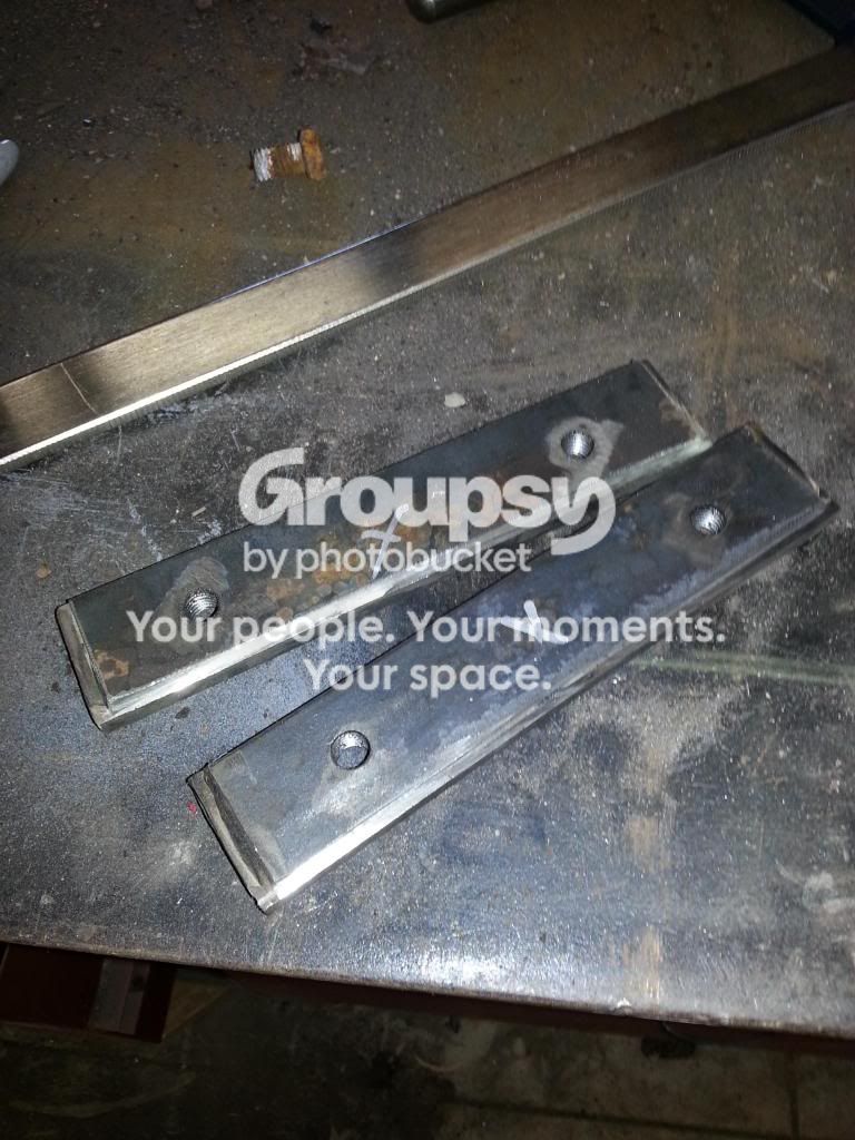

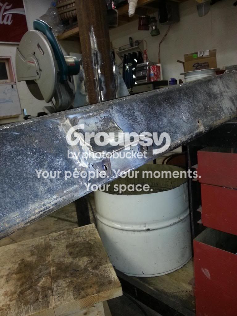

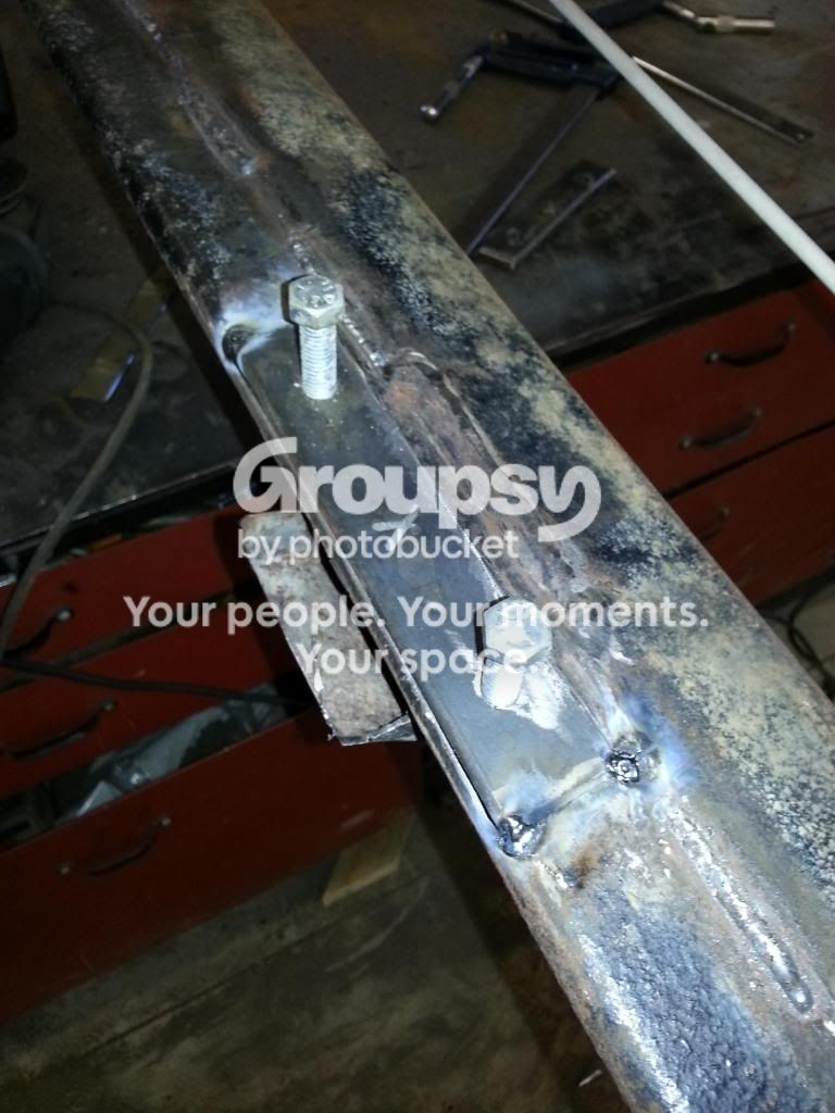

I manufactured some threaded insert plates to weld into my frame. Not my idea I have seen this done at least once before.
Cut hole for the inserts:
Tack into place and fit cross member:

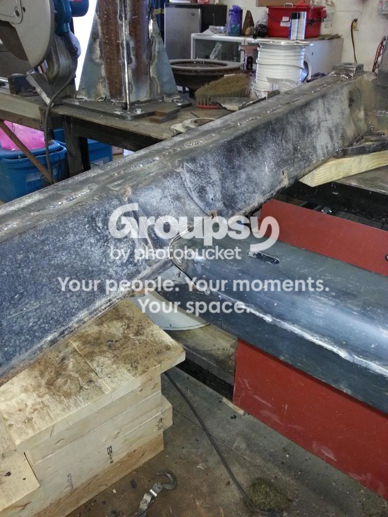

Weld and grind pretty:

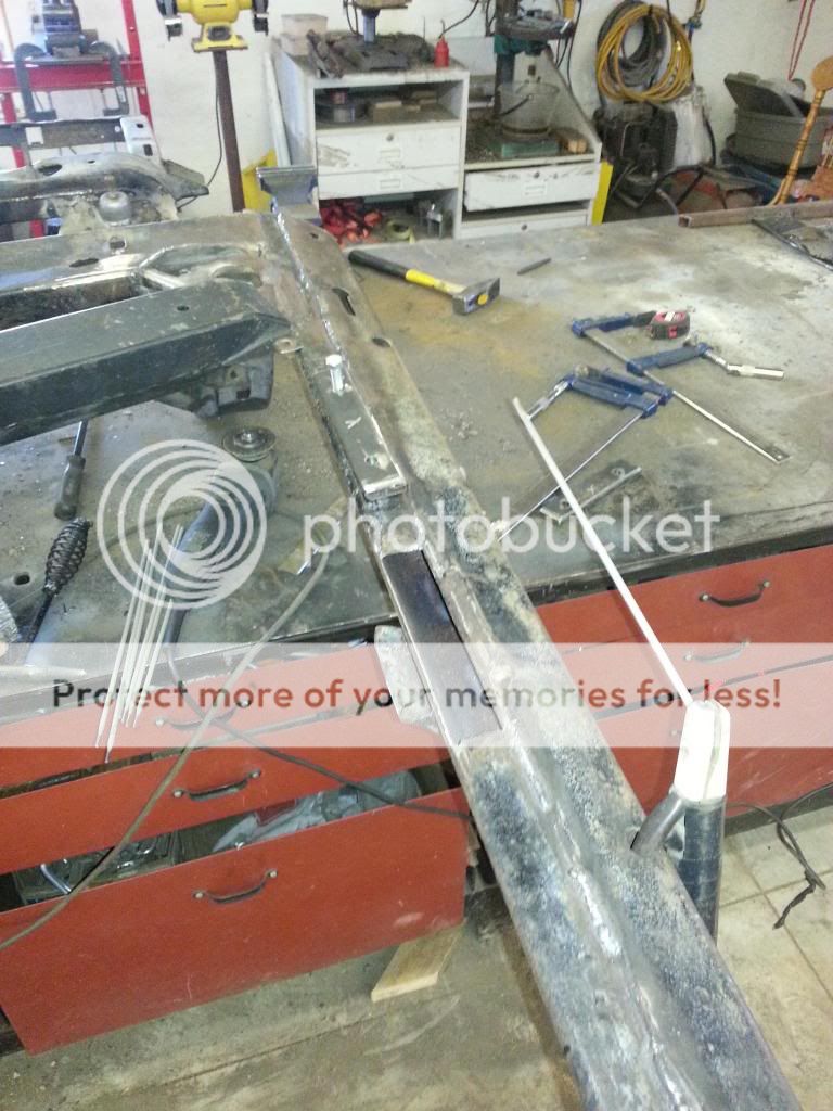

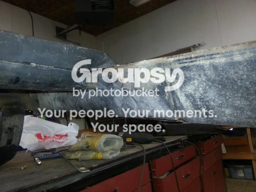

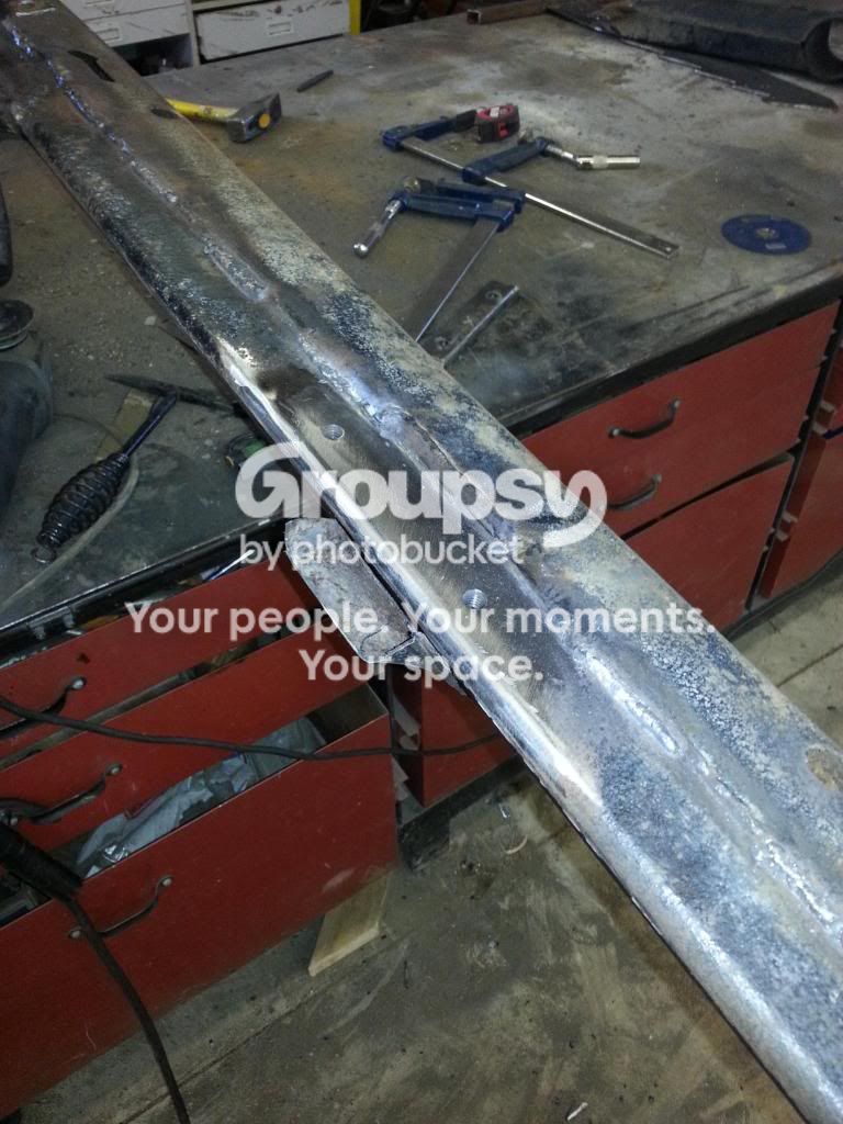

Bolt in crossmember to build top mounts. The frame sprung a bit on my from cutting out the old crossmember and welding so it ended up being a little wider than stock (1/8"- 3/16"). To fit the crossmember I had to pull the side rails in. Notice I purposely left some of the old welded section of the original crossmember. It will look good at the end.
Bend up a piece and fit it in. Weld and grind beautiful!

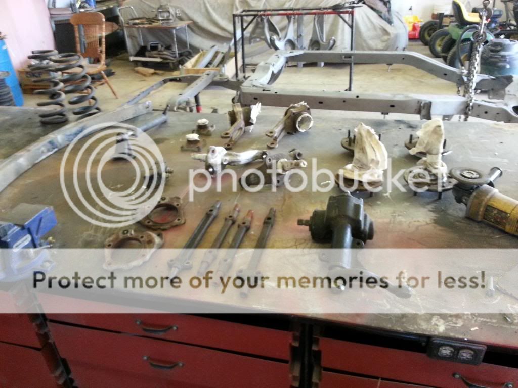

so will the c/m mount clamshell style to the frame rails ? that is a nice fab. table you have there taylor.
It mounts in just like the stock frames with removable crossmembers. The bench is from a machine shop who didn't want it any more 4' x 16' x1/4" top and roller bearing drawers. Just added the jib crane this month. Works great. I love having a bench that a car frame can fit on!!

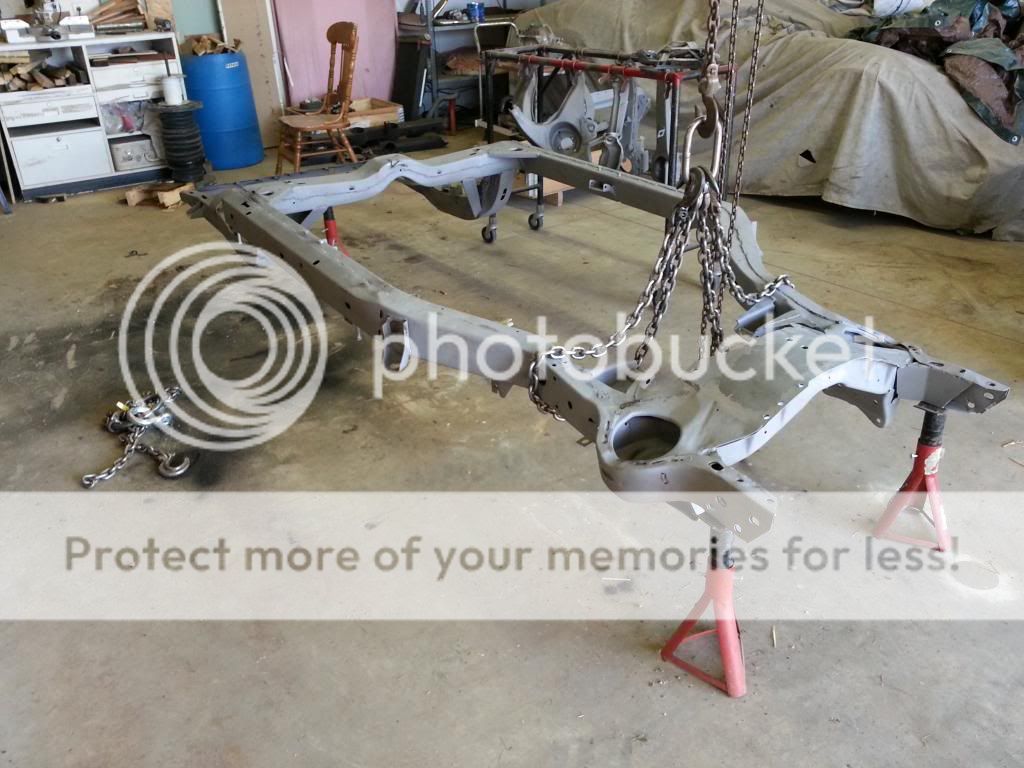

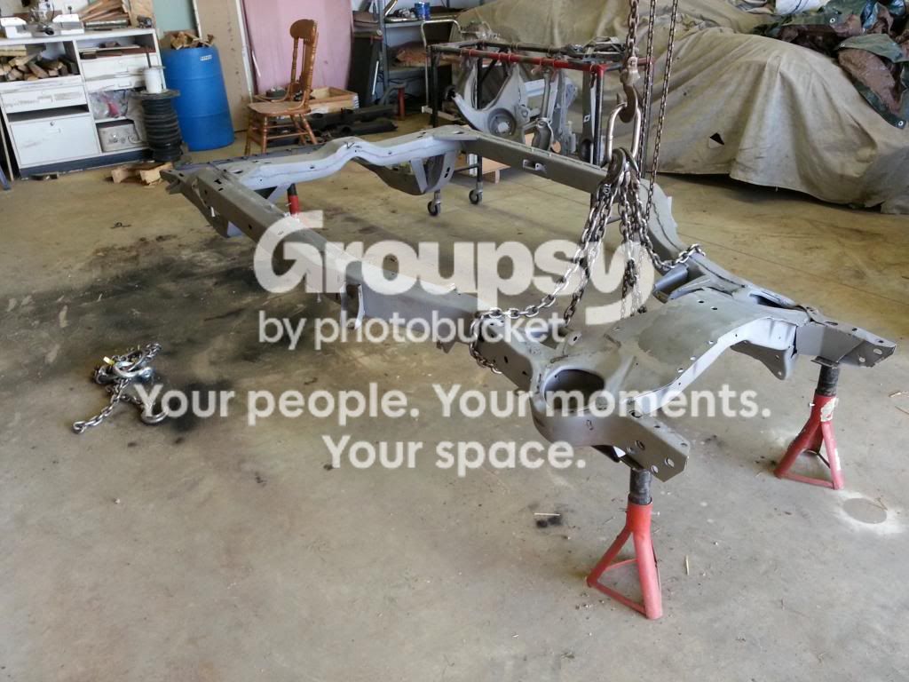

Well long time no post. Been a busy summer, damn acreage life. Chassis is ready to be prepped for paint and some of the small parts have been blasted. Just ordered the POR15 and cleaners to do the painting. Hopefully within this month I will find the time. Riley if you reading (which you are) I may requisition your help with painting one day. Hope to order parts next corvette central free shipping event and then assemble the chassis over the fall (and likely winter).

POR supplies are in. Chassis set to be blasted Monday. I actually might have the chassis painted before the end of the month!

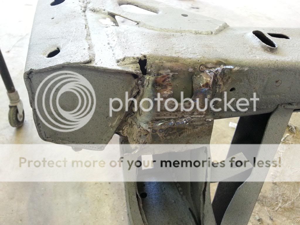

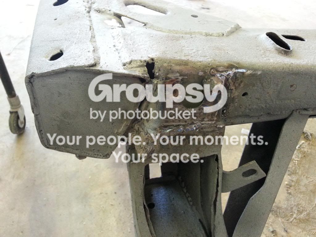

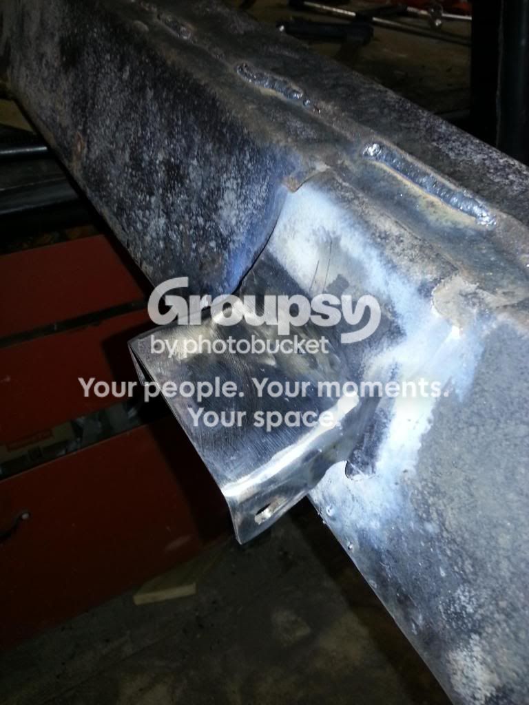

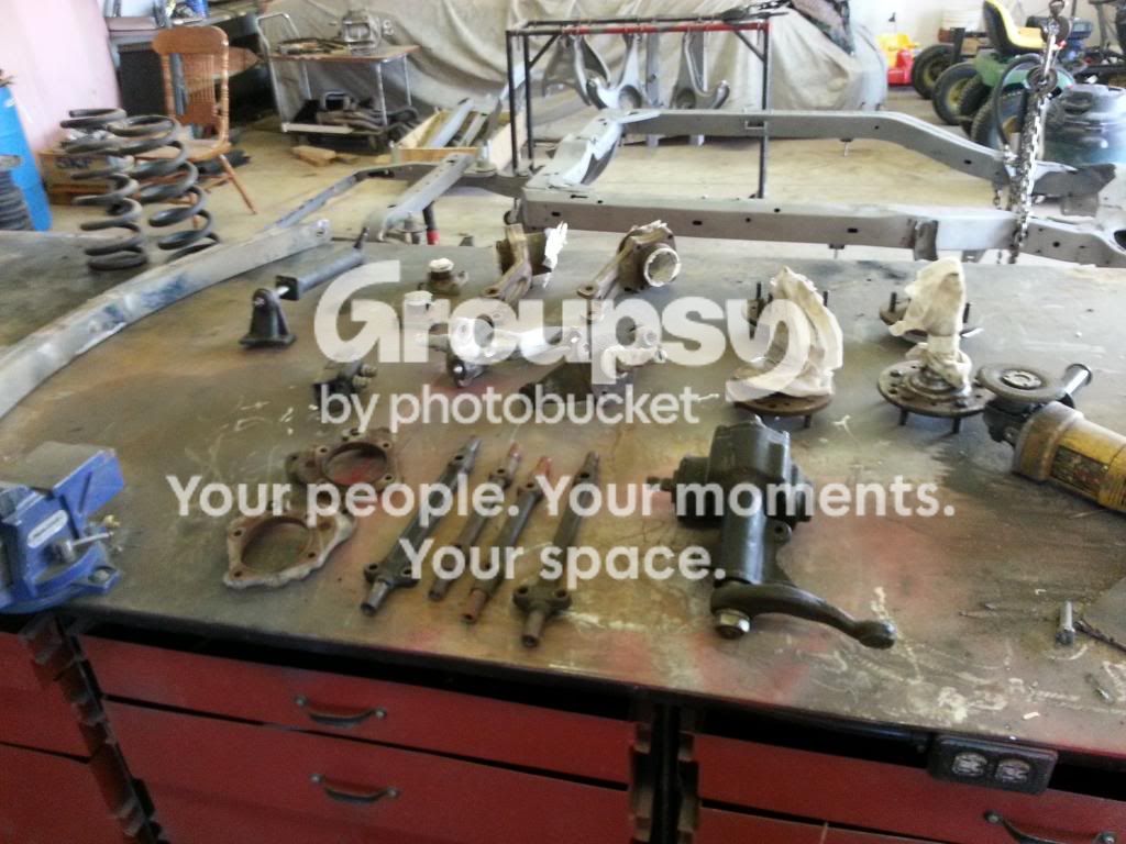

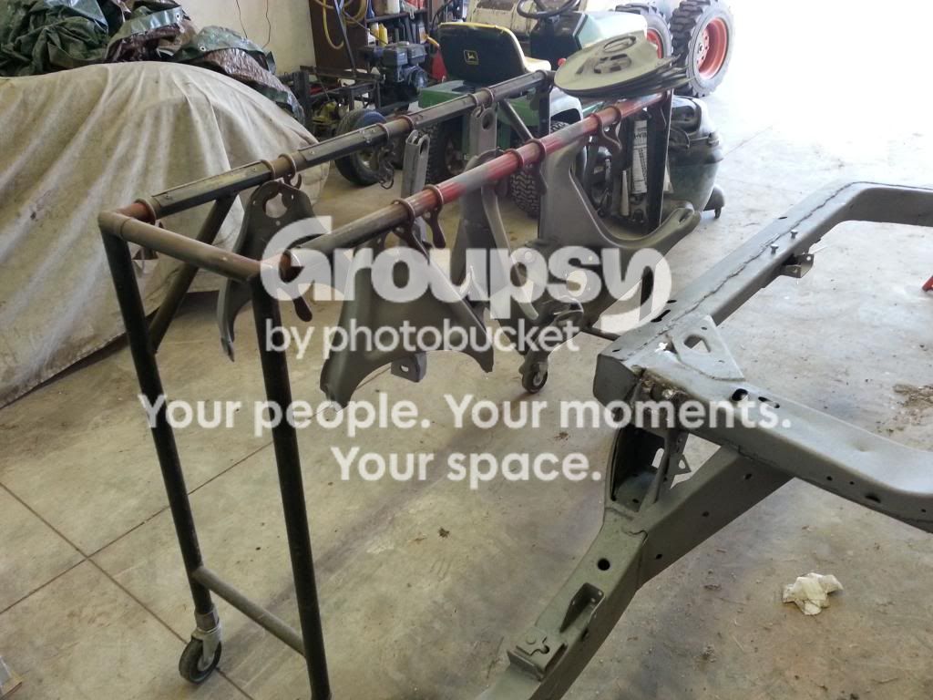

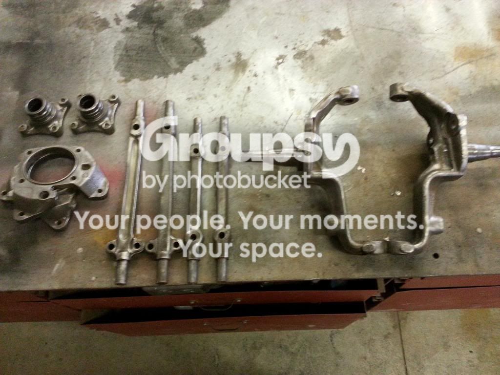

Well not painting yet but on my way. Chassis is blasted as well as some parts. Any parts with detailed or machined surfaces I opted to wire wheel myself. When I got the chassis back into the shop I noticed a few more fixes to be done. Nothing to major mostly small holes. I did however decide to redo the pass. side dog leg cap thingy. After blast it had plenty of holes and the welds were poor. So cut it off and manufactured a new one. Sorry didn't get a before pic this time.

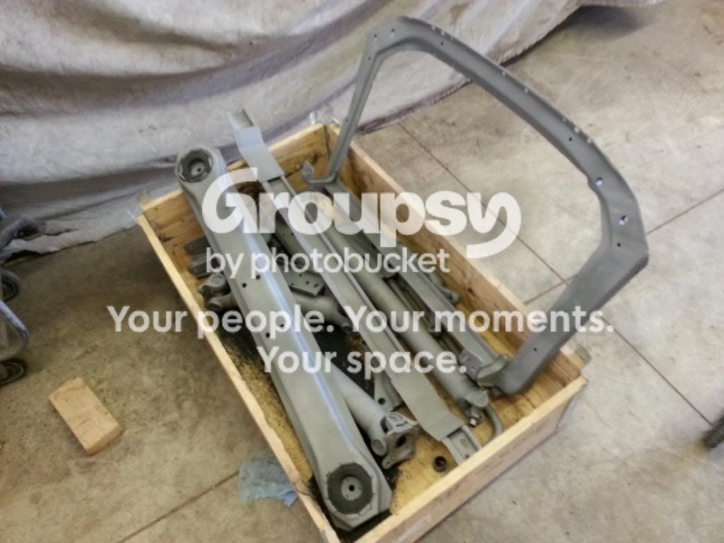

Before Wire Wheel:
Some parts after wire wheel:
It's funny how often I think to myself (while wire wheeling) how good all these parts would look just clear coated not painted. Then I do a mini debate convincing myself that clear would show all my hard work. Then I realize I am just arguing with myself and I know I will paint them anyway.
Anyone else ever thought like this?

beautiful job taylor....very professional looking. from what i can see all the bolt-on's appear to be in good shape. i don't think the clear coat would last like the por 15, do you ? a little anti-seize on the sombrero's will make any future removal of the rear c/m a bit easier. looks great brother !!! :D
Looking good Taylor. That will be one fine looking shark when your finished.
