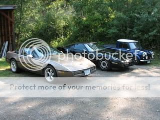

Don't get me wrong Alberta. Your 02 Z06 wheels look great but I'm thinking a change up for the 88....maybe a ZR1 look???? lol.... easy for me to spend your money....
And BTW.... I been following your build from the first post and it's time to change your signature line.... I don't think the 88 rates as "stock" anymore... just sayin'...:rolleyes:
I'm not sure what look you want to achieve, but I gotta say, please don't use a C5 Z06 wheel on your C4. If you want the size and dimensions of a newer wheel, there are plenty of other choices in the aftermarket available to you. You have put far too much time and effort into your car to settle for a newer Corvette wheel. I may have a biased opinion, but I think that wheel looks awful on anything except a C5 Z06. It is one of those unique things that is specific to a certain car and just doesn't look right on anything else.
I can appreciate that you want to have a newer and/or unique look to your car to separate it from other C4s. The five-spoke design lends itself well to your body style, and there are a ton of options out there. Eric's suggestion of a C4 ZR1 style wheel is excellent if you want to stay with a Corvette-style wheel, or perhaps even a C6 Dymag type, but not a Z06 wheel.
Give me a budget to work with and a size, and I can make some suggestions if you are interested.
PS. - Sorry I haven't contacted you yet, my trip to Red Deer has been put off for a while since I am down to one vehicle for several weeks. But I WILL be in contact with you when I can get up there.
I definitely like those better than the Z06 wheels on the C4, but why don't you want to use the stock wheels? I like the sawblades, and it keeps the 'sleeper look' going on. Put a sticky 275 on there and it should hook fine.
Oh god please no, not torq thrusts! I'm sorry, but that is just a newer version of the most played-out wheel ever made. It is a new design of the old Cragar five-spoke from the 60's. It looks great on an old car, but does NOT look good on anything built after 1973.
