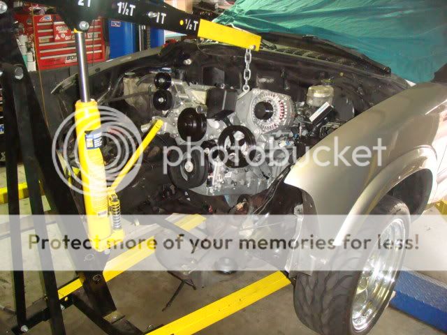

The heart is in

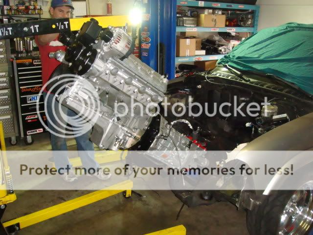

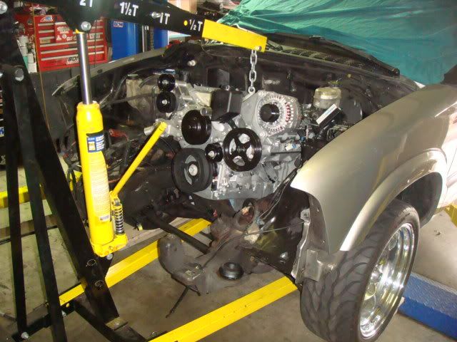

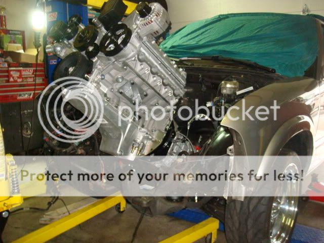

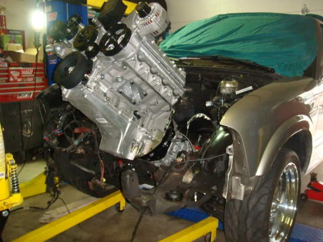

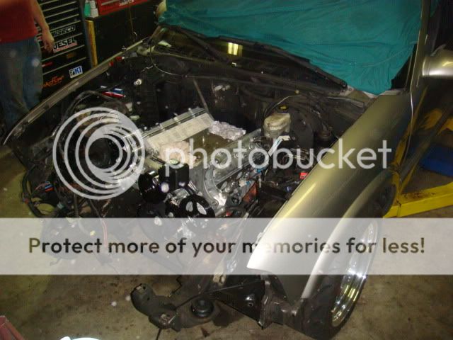

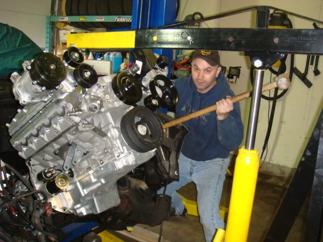

Well it was boxing day today , so we finally stuffed in the LS3

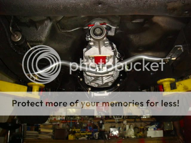

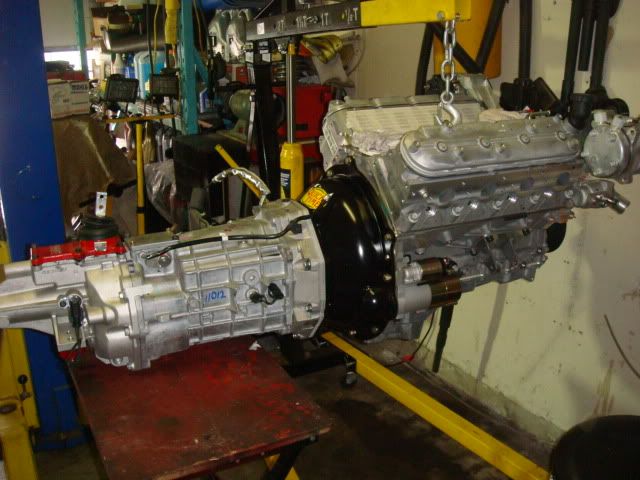

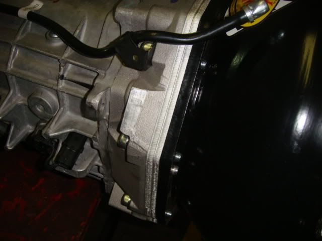

Here are the Quicktime spacers installed for the massive ZR1 clutch

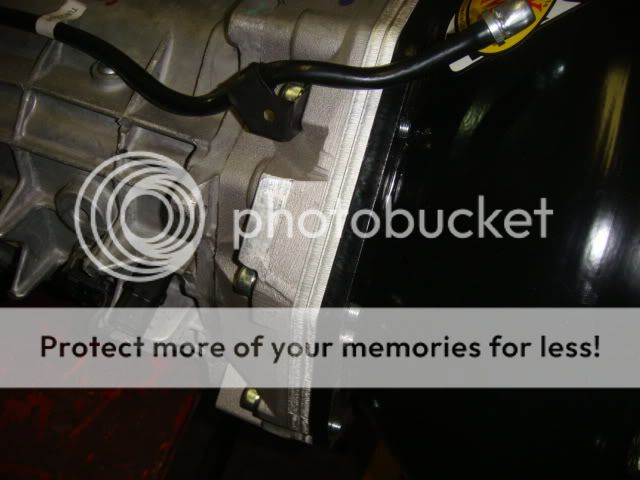

All bolted up.
It was a tough go , but I found a way to knock it in
We need more butter

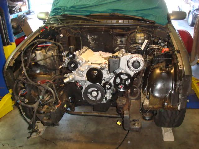

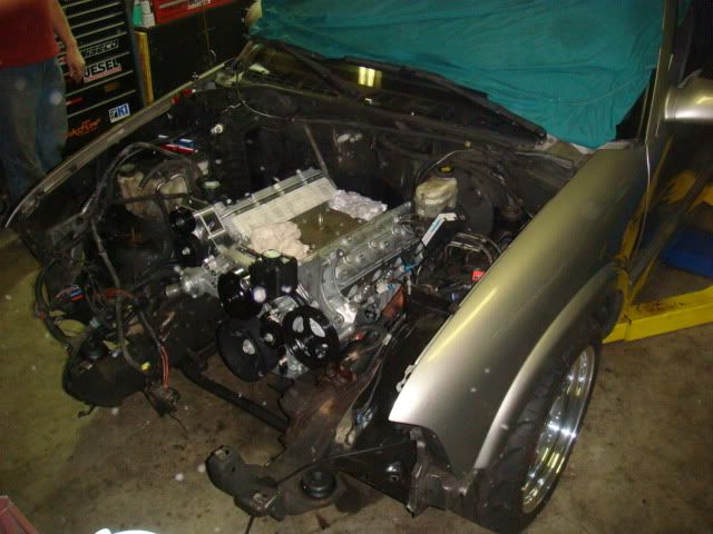

Almost there

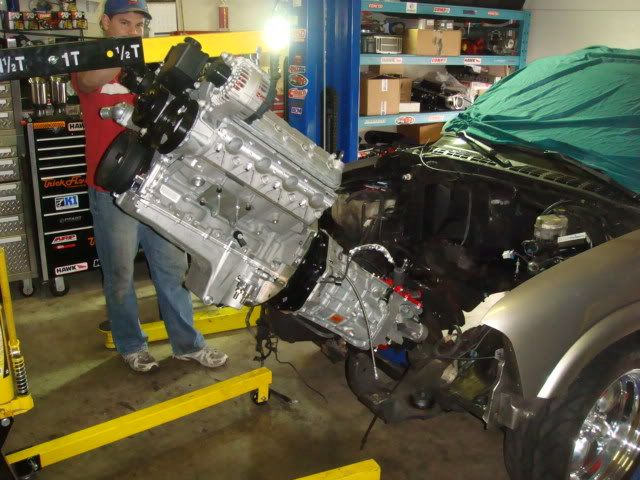

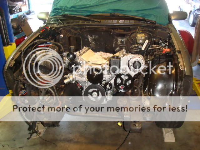

Home at last
That looks freakin awesome

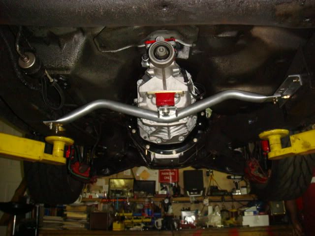

From underneath
More to come ...wiring , plumbing and some some custom parts
LOL, a 'BFH' works every time.:D -- and that quicktime spacer sure helped button things up a little tighter too.;)

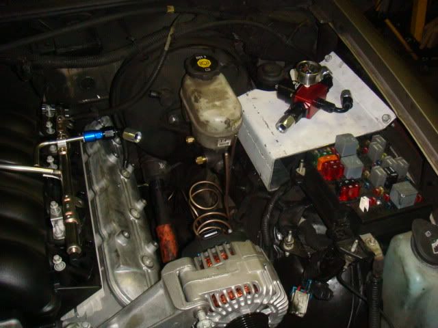

Now how about a few teaser pictures :

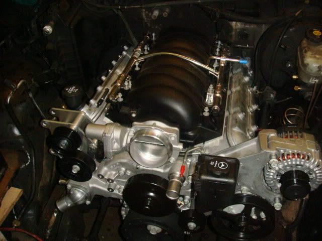

Intake on and looking nice
All new brake lines

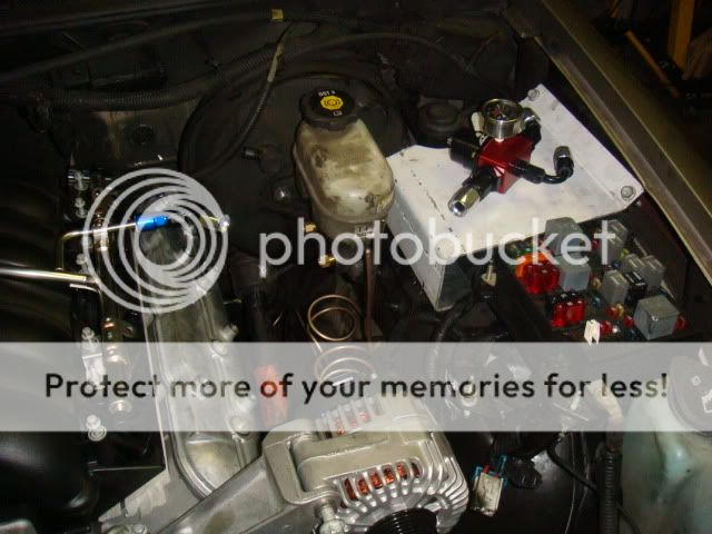

Custom bracket and fuel regulator
Line Loc and Wilwood P-valve
Fuel line mock-up
New wiring harness and fly-by wire accelerator pedal
