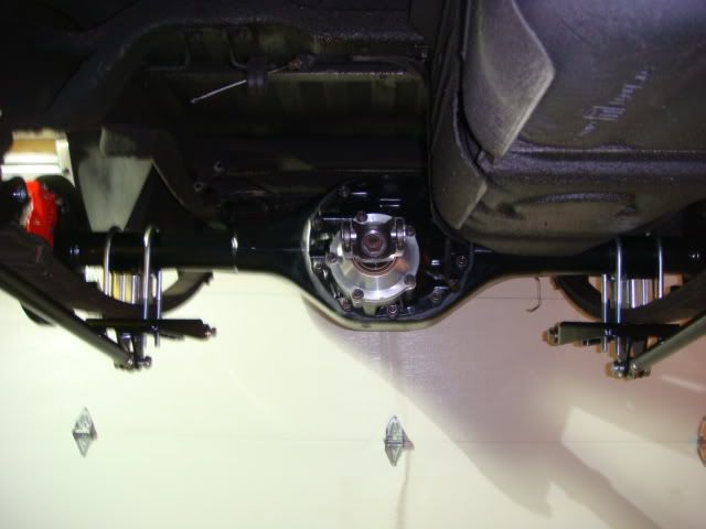

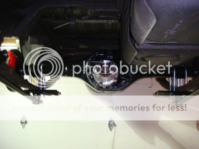

Today we were able to do the body bushings / rear diff and the caltracks trac bars . The 3" lowering blocks are in and the front suspension is partly disassembled .

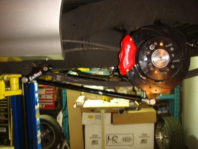

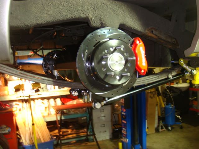

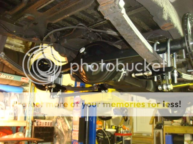

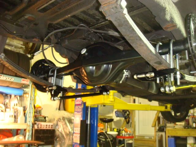

Ford 9" / Caltracks and lowering installed

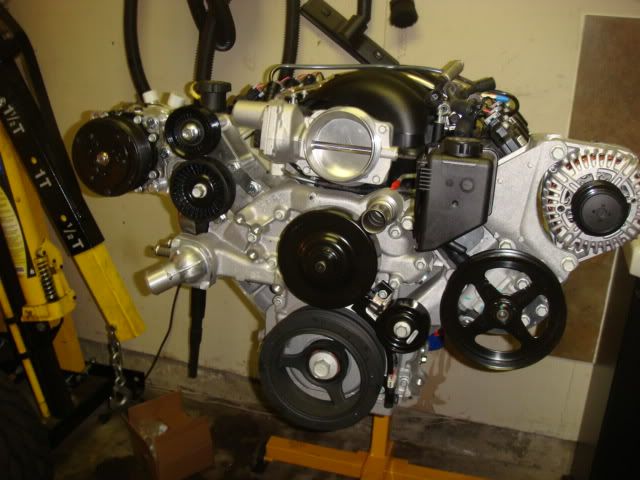

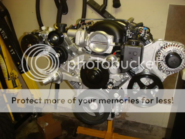

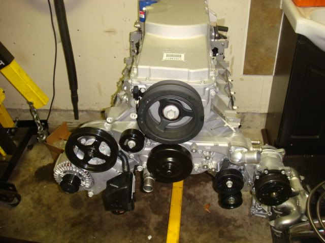

I worked over the LS3 and drive train.

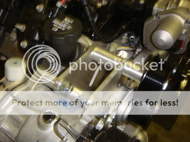

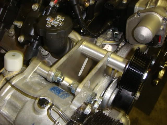

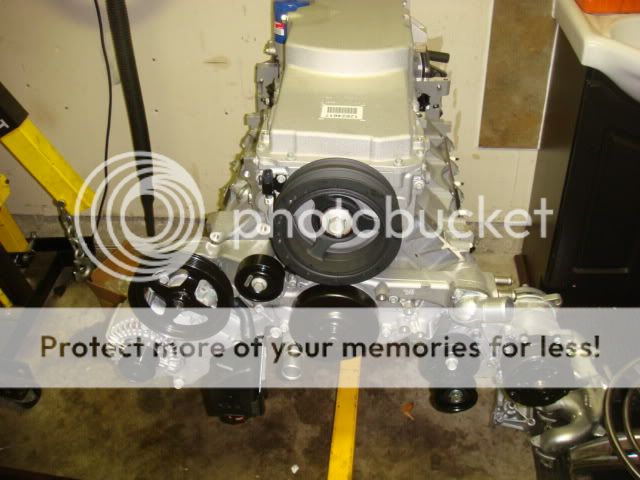

AC compressor relocate done .
All accessories bolted up .

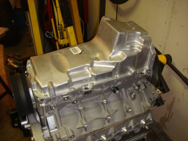

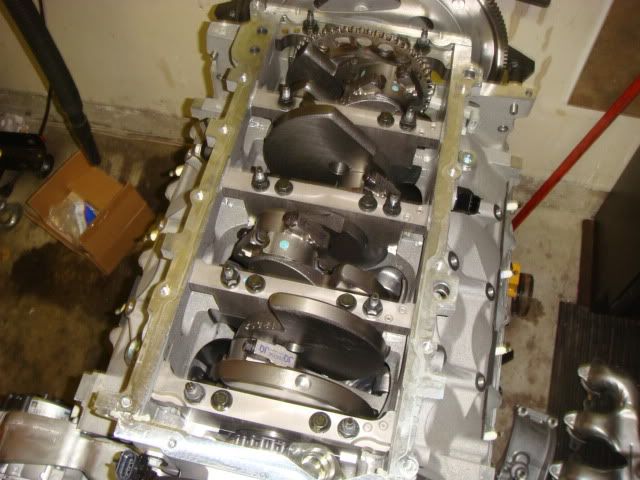

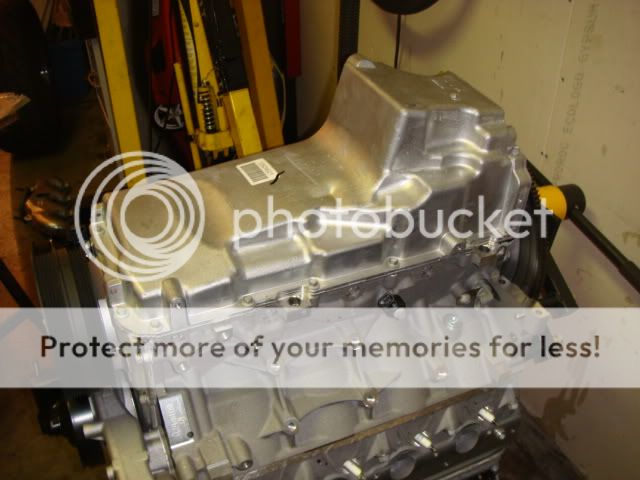

Removing oil pan to be replaced with Hummer oil pan .

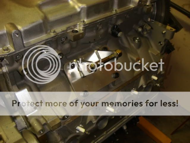

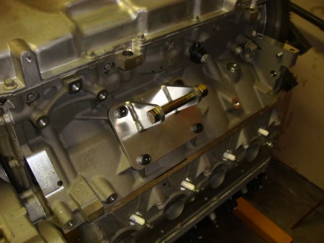

View of the new motor mounts on the block.
Hummer Alpha pan installed .

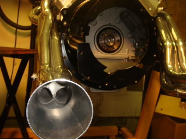

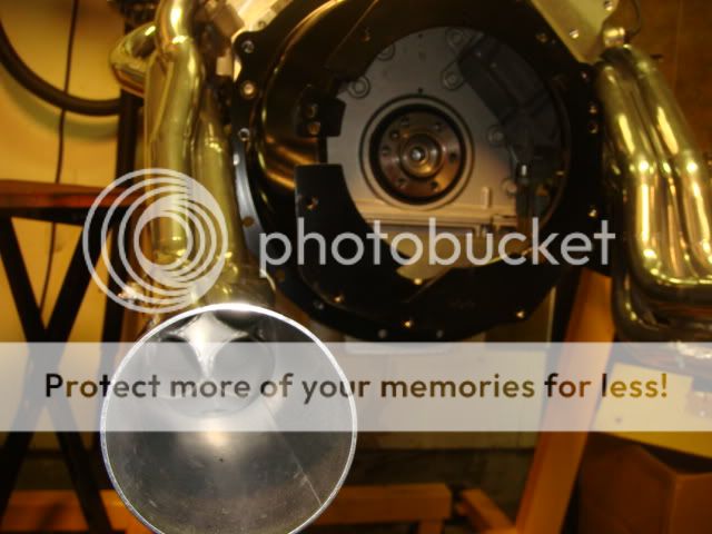

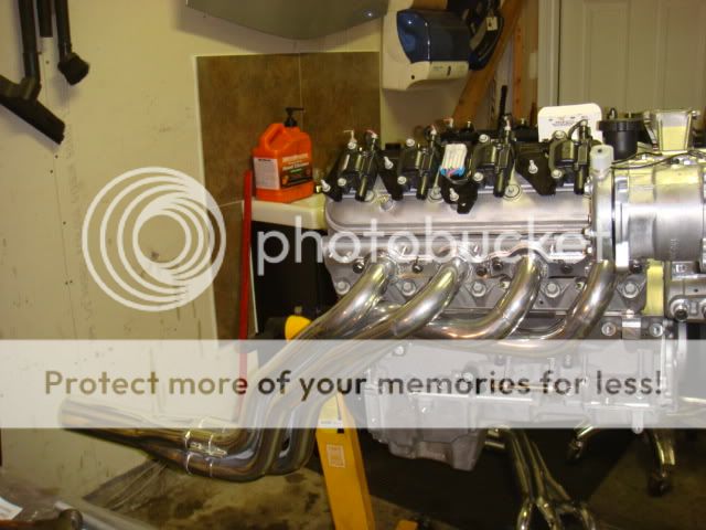

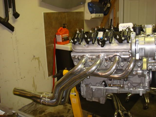

Headers installed for clearance check.

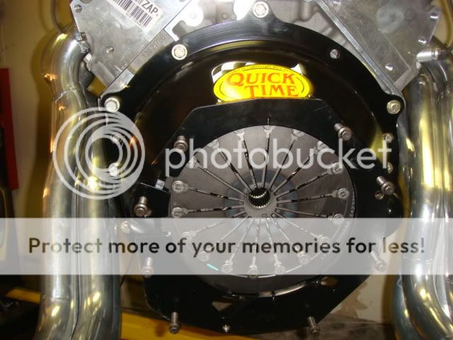

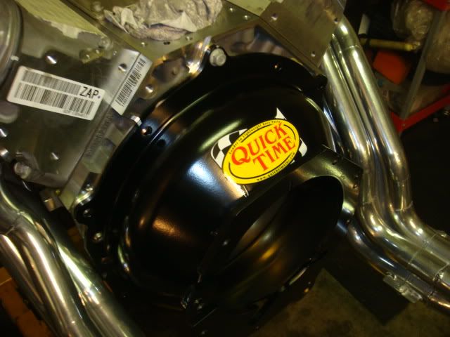

Quick time bell housing fit up with headers .
The business end of these monster long tubes .

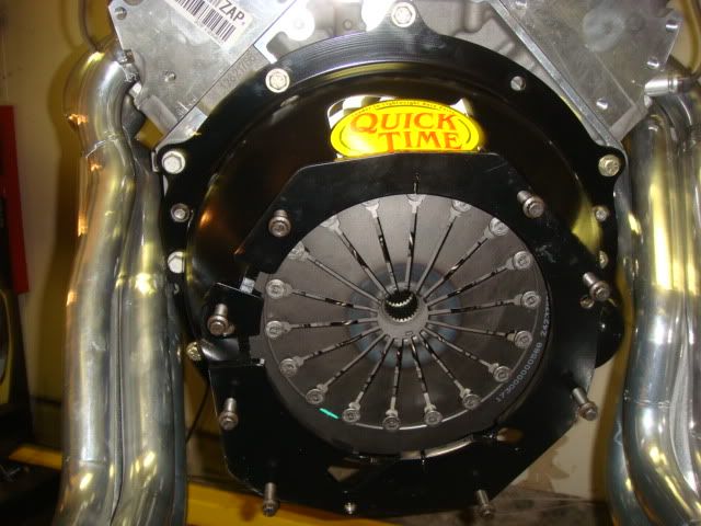

ZR1 clutch and flywheel .

New motor mounts all ready for the LS3.

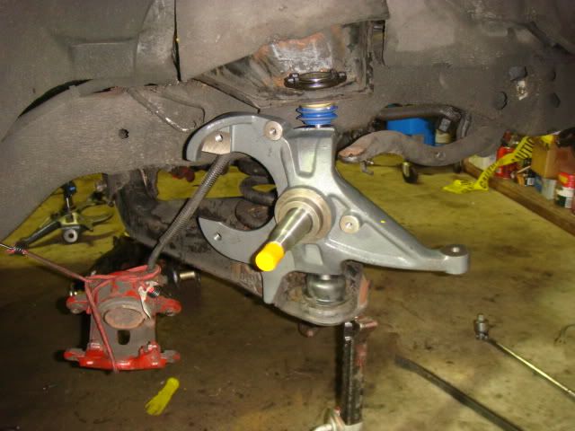

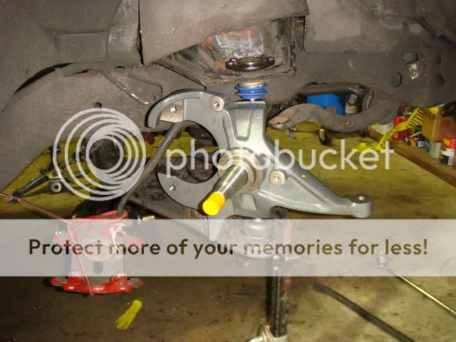

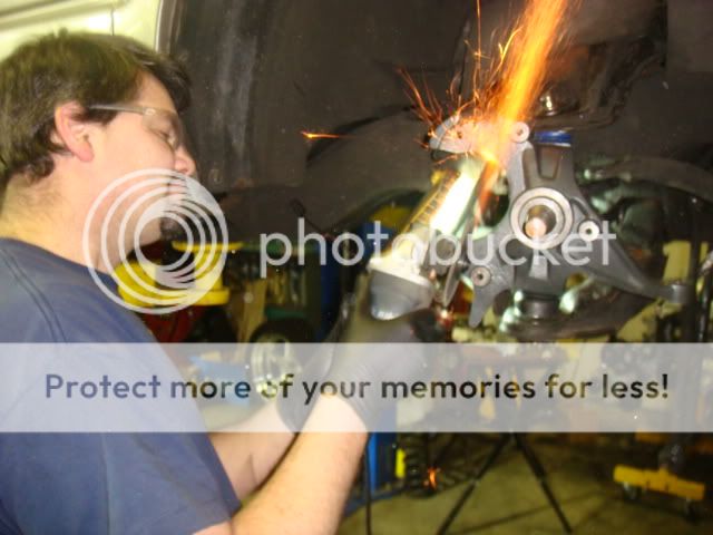

Belltech 2" drop spindles .
A little custom work .

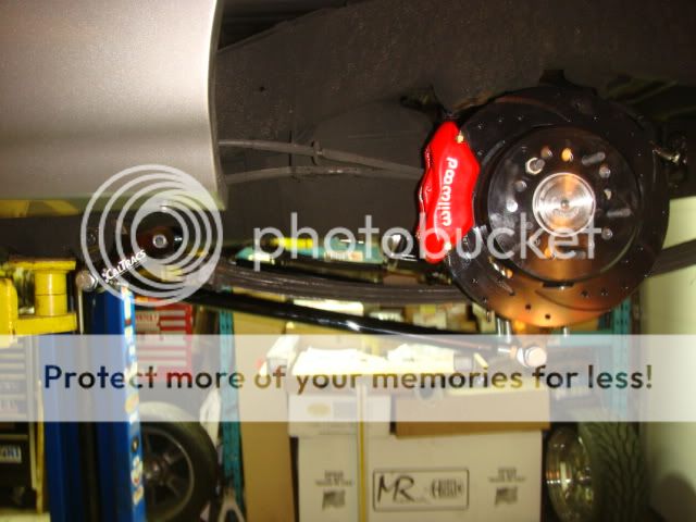

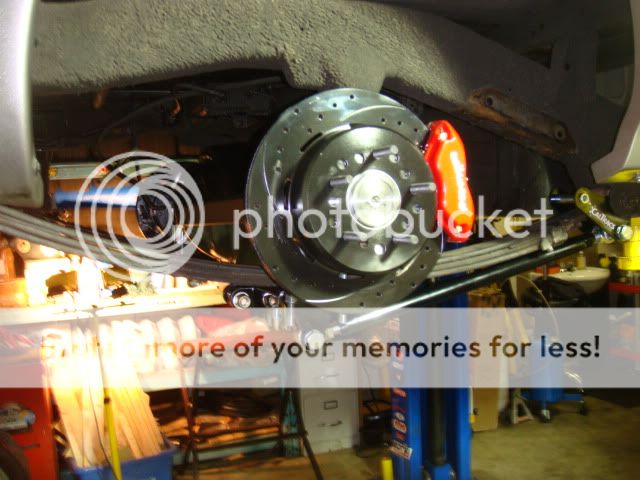

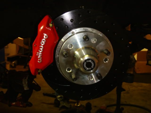

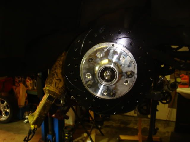

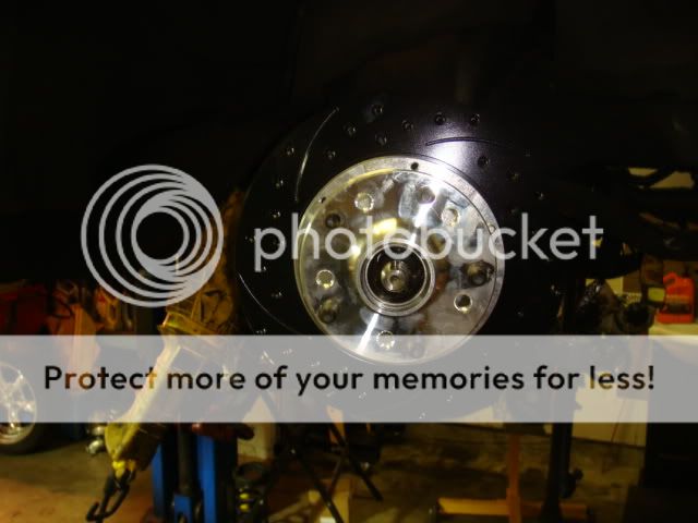

Wilwood hub and rotor assembly.

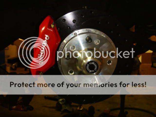

Sick Wilwood front brakes .

ZR1 Clutch and Quick Time bellhousing installed .

Front brakes done and looking awesome .

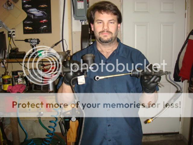

How's this for custom , adapting a Corvette clutch master to the Sonoma . Rob say's top that eh !
