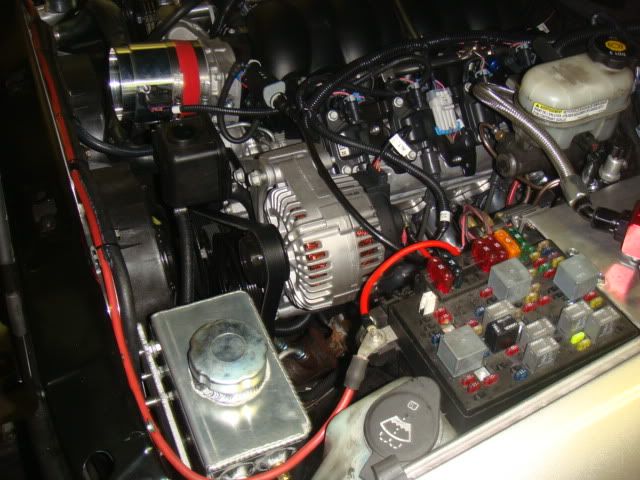

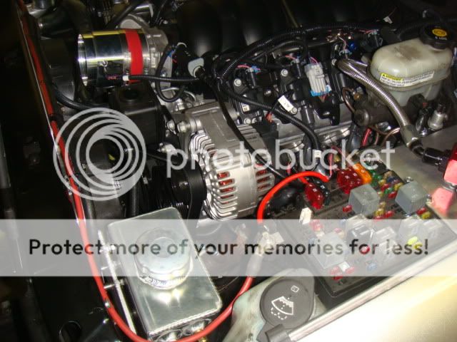

Thank's guys , to say that this has been a fun build is an understatement .
The truck is off to the exhaust shop Saturday , then to paint for the rear fender's . Once back we need to address a few small issues .
Brand new alt that isn't charging
Brand new oil pressure sender that isn't working
Need to break in the rear diff
Set up the brake prop valve
Caltracks need to be set
Relocate power steering tank
Dyno & tune
March , weather permitting it should be ready to go home :D

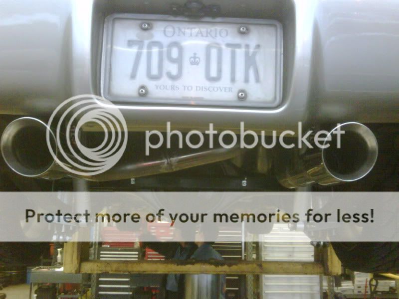

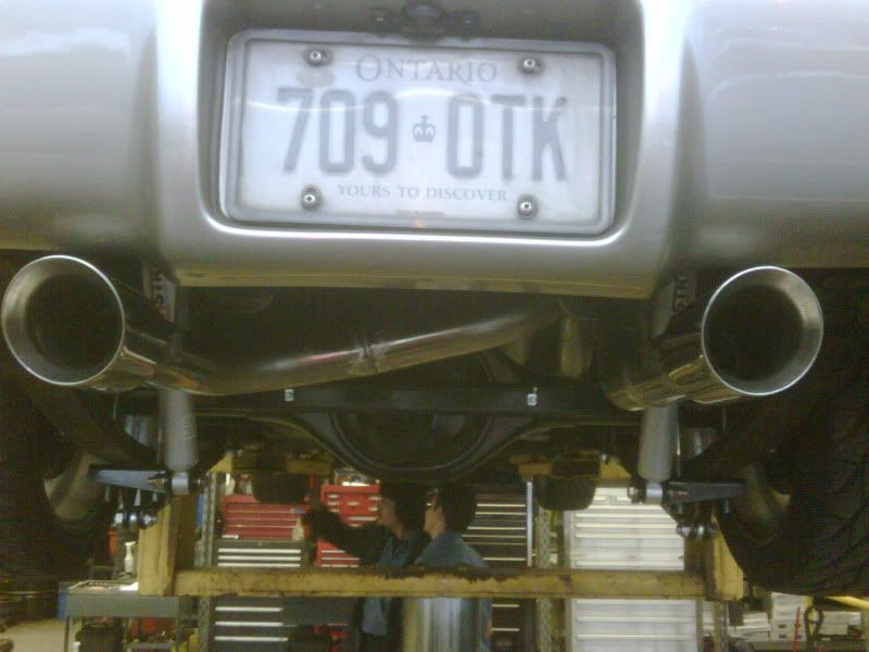

Full 3" Stainless Steel exhaust complete .
We are almost complete :D

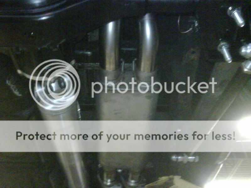

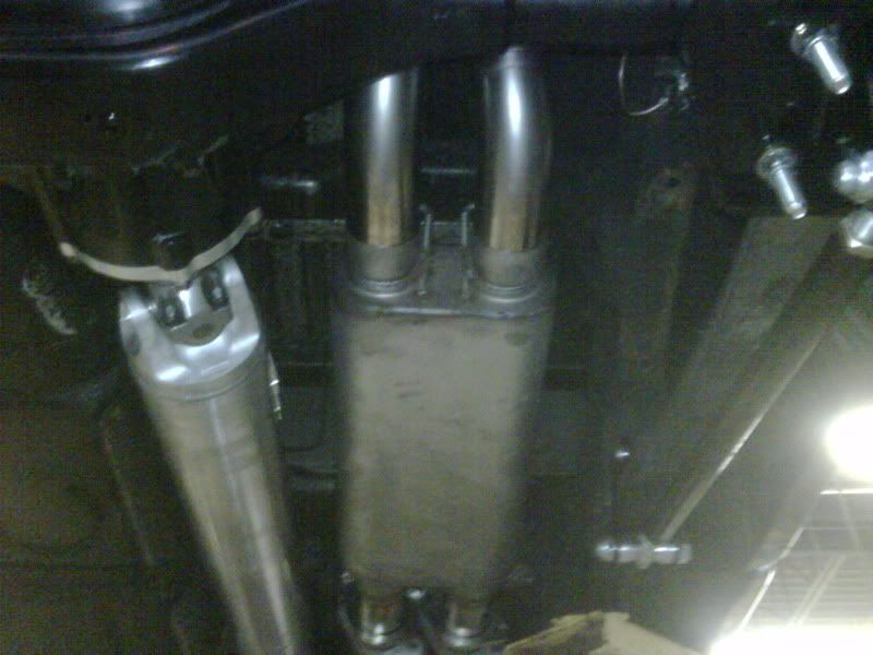

A fw more of the exhaust and the new stance :
The truck will be with us for a while yet . We are still doing a fuel pump and other upgrades . Testing will be done once the weather clears . Final tuning and adjustments will be done at the same time .
