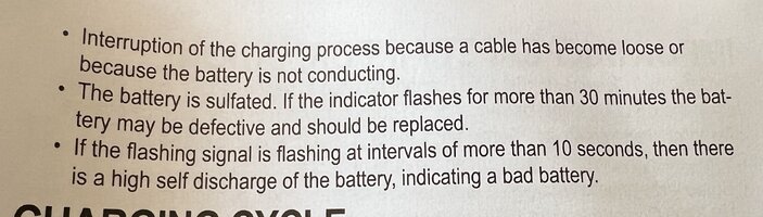

For enduring reference in this thread …
Here’s what the us3300 model 1051 corvette c7 charger book states for flashing yellow …
Glad you got it fixed ✅
