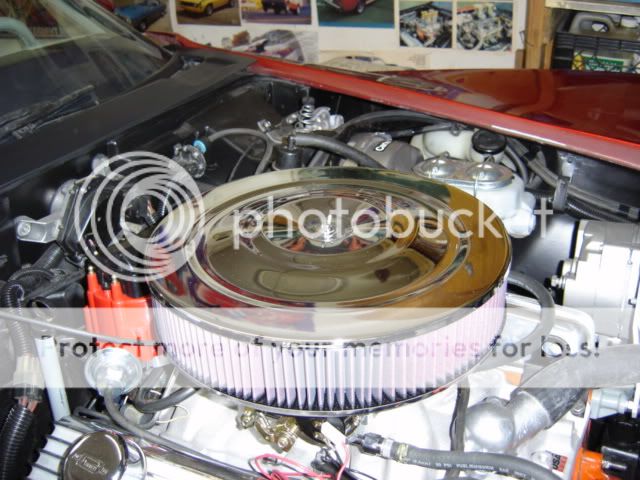

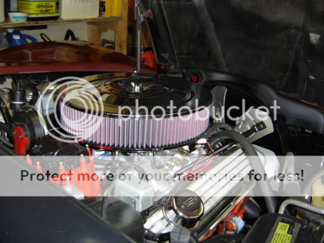

Thanks. Well we are not having fun lol every little thing that can go wrong is. The 3" airfilter will not fit under the hood, so will have to try a 2.5" paper one or a 2" then go buy a K&N and hope it lets enough air through.

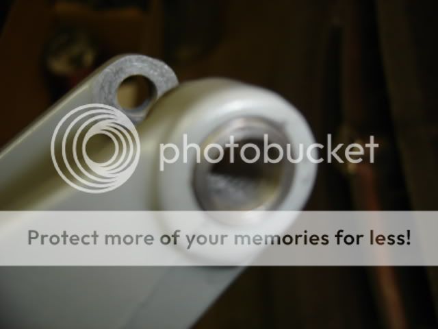

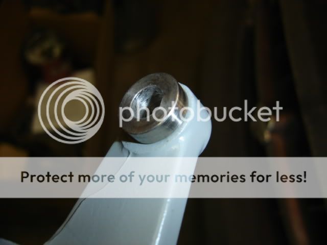

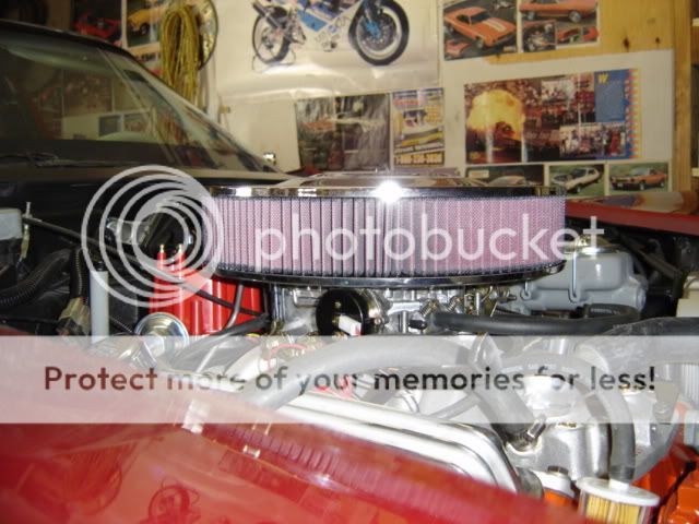

Ok a couple of things got finished this week. I got the lower alternator bracket corrected. I had Bernie machine me a bushing, and i got my air cleaner trouble solved. I ended up wit ha drop base bottom, a K&N 3" filter and a MR gasket flat top. Thats the only way to fit it under the hood.
Picture of flat top needed.

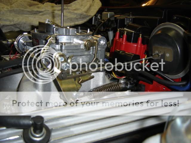

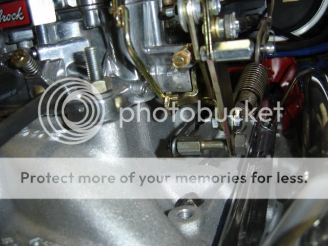

Dot all the carb linkage done tonight. That was quite the job, a little thought and it all works fine. The pain of using non factory parts in the name of a few HP.

if the 3" Filter fitted yours, perhaps I should try it too... I dont remember why I used the 2"...I think its because I tried a 2.5" and did not fit...but now I am not sure... you say you used the 2101 Elderbrock Intake Manifold?
I will post pictures today of the final setup, as the parts are on the way and still in the DHL truck. I used the 2701 intake which is 3/4" taller then stock. The carb is a 1406. I used an Edelbrock air cleaner, but only the bottom drop base the top will not clear the hood due to the rise in the lid. I ordered a FLAT top to go with this 3" K&N air filter as it will fit.

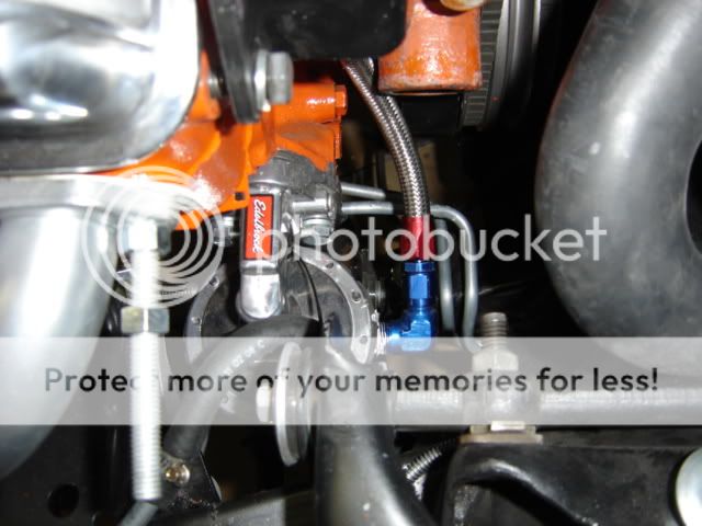

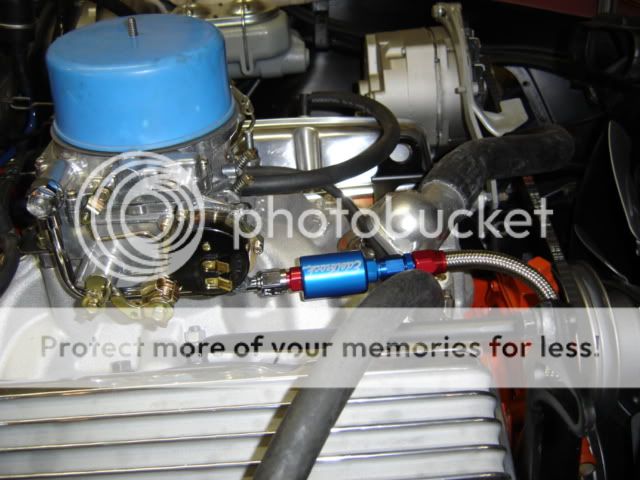

Once i started to assemble the air conditioning, i realized how bad the old fuel system looked, and how difficult it was going to be to get at the filter and line etc. So i decided to go with the Edlebrock deal.
