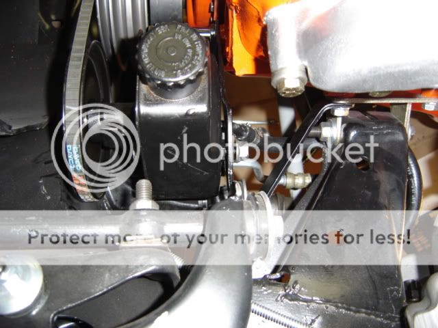

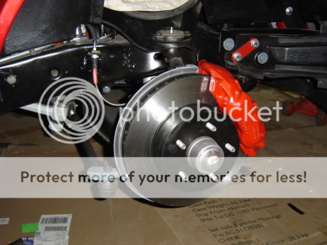

Well front brakes and power steering hoses are on. As well as the rad seal kit. I should of did that before the rad and tranny lines went on oh well.It was a pain but its on.

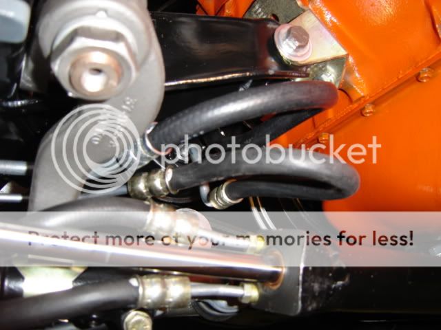

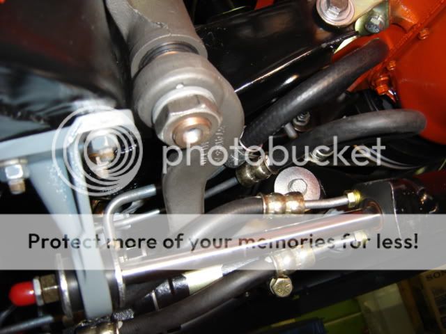

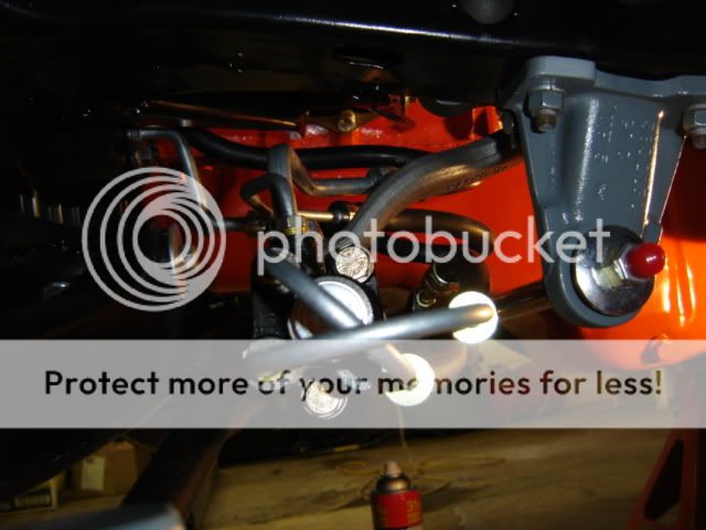

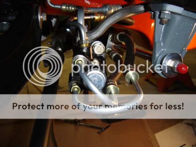

For those that have done this, the manual is sketchy at best. Can you tell me if i have the hoses routed correctly? Especially the hoses off the pump to the valve.
Well as of last night the steering is complete, and the brakes are bled. I also ordered a new set of headers last night, went with the Headman elites. Will let you know how they fit when they are installed.

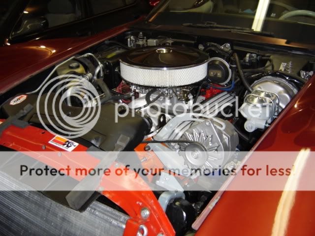

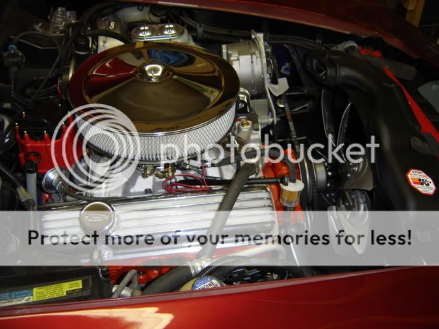

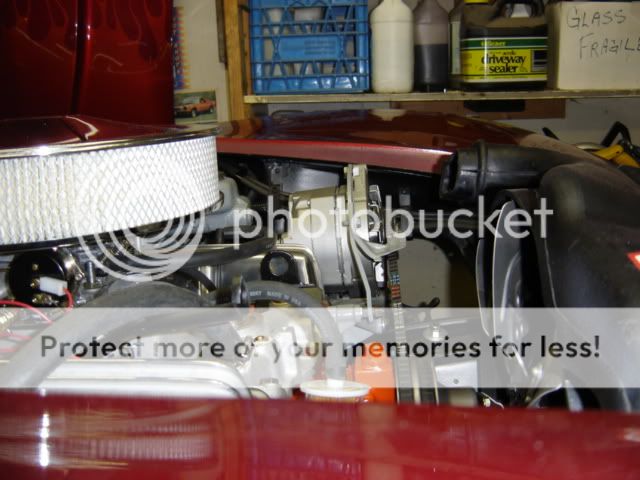

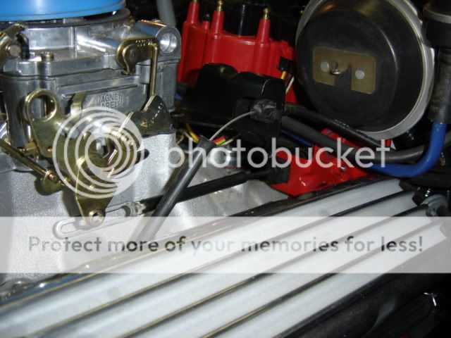

The engine compartment is coming along, just waiting for some linkage stuff to show up to make it all connect. Not sure if the hood is going to close on this? anybody have any thoughts on this?

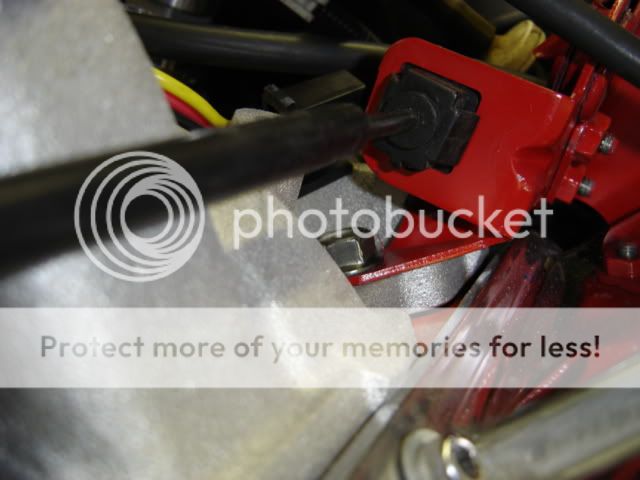

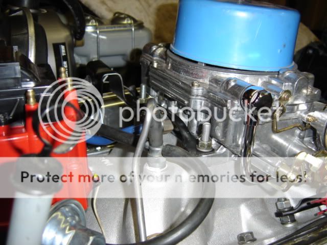

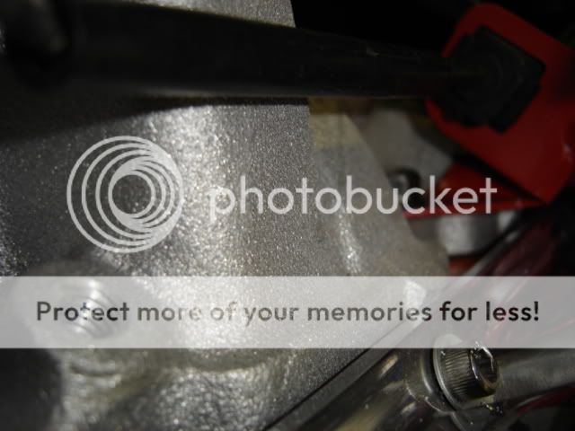

#1 Had to trim a casting flange to get the kickdown bracket to fit.
#2 Had to make Factory throttle bracket 1" longer to fit, cut it in the center and welded in an inch spacer.
#3 Not sure if the hood will close? Was hoping we didnt get too much taller with this intake and carb setup.
