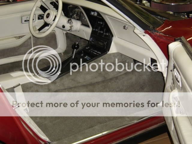

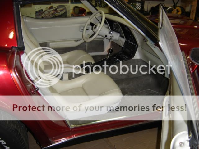

Well all the carpet is in, all thats left is the seats and rear compartment cover when it shows up?

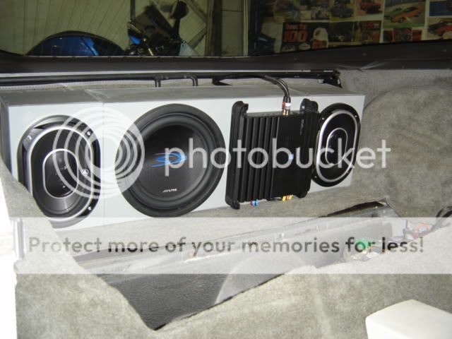

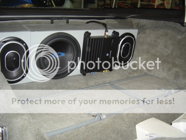

your sub is probably also then playing "stereo" and not mono... you have to connect the sub amp to the "sub out" RCAs on the deck. These will allow you to adjust the crossover frequency of the sub and the gain control.
If your deck does NOT have these, you'll need an electronic crossover and then route the pre-outs from the deck to it (probably 2 pair if you DONT have sub pre-out) and it will give you 3 pair on the out side (Front/Rear/Sub). You can then adjust to your heart's content.

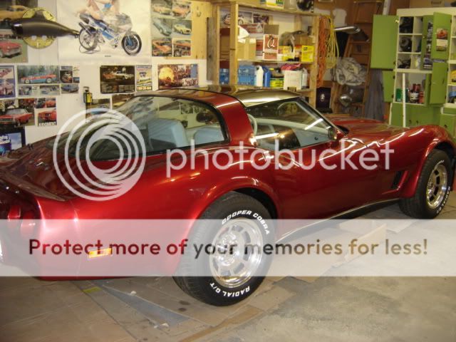

well its done. i fixed the hood release cable made my own out of steel. Fixed the thermostat leak and replaced the tranny pan and gasket. We are leak free thats not like any CheVy i have ever owned lol. NOW TO GO DRIVE THE THING AND ENJOY IT.

Well its coming together. I was able to get Stated value insurance through CAA. They went through SMI and i have full coverage for $299.00 a year. I plated the car as an antique and we are good to go. I solved the off idle stumble, and the stat housing leak. Tonight we found the tranny leak. The shifter shaft seal is leaking, so that means another mess as i dump it all over the floor trying to get it into a drain tub.
None the less, the car is a blast to drive, 340 hp and 390 tq gets the car moving and around corners. I can squeel the tires agian like a teenager.lolol
