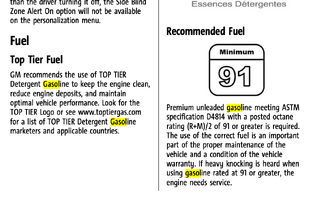

From the 2023 owners manual.

As I pointed out in Post #2, the C8 originally required PON93 or higher. Unfortunately California has a limit on octane rating of 91 so that let out a huge market. So GM changed the fuel requirement for 2023. The change is likely just software (fuel mapping) so no need to change anything in the actual engine. I don't think it was an OTA so if you are pre-2023 I would stick with PON93
