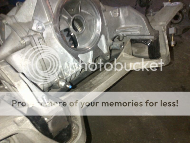

Put on the Hinson trans mounts and hope to put the trans back in next week..

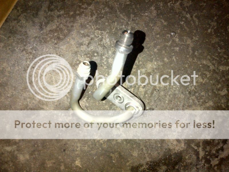

Welded AN fittings on transmission lines.. from there I will run braided lines to the cooler....

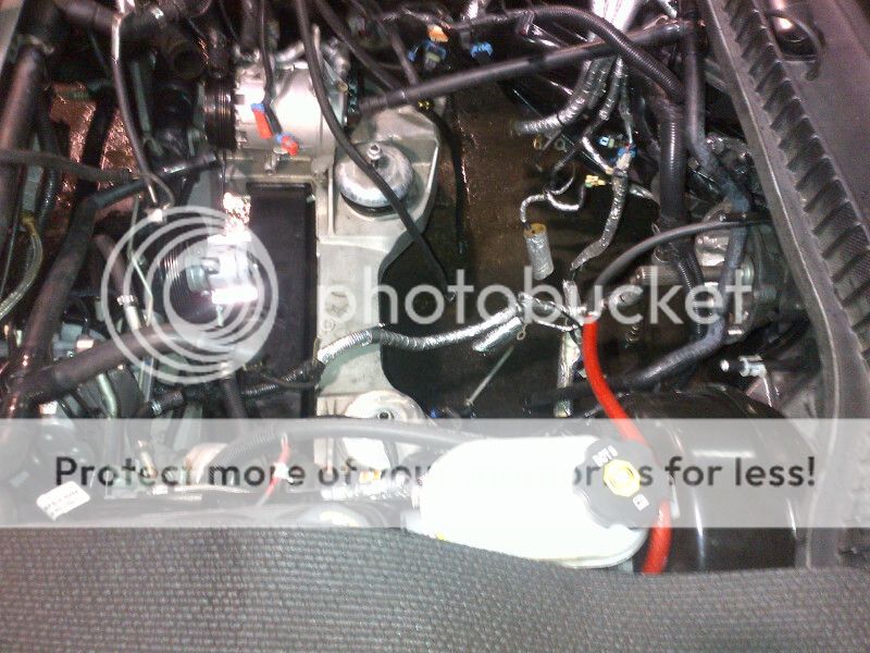

Modified and fit the Moroso tank which will replace the Eforce coolant tank for more capacity...

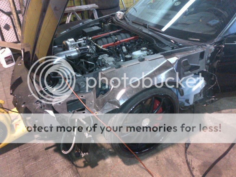

Some more build updates...

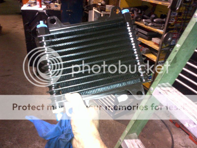

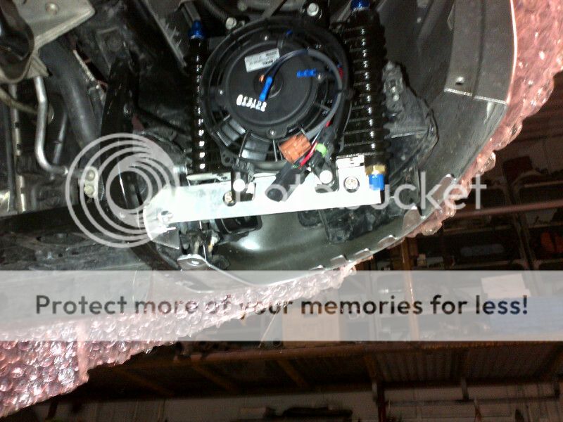

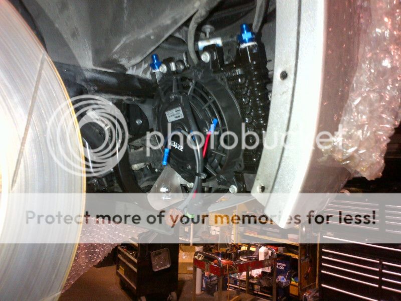

Made brackets and installed B&M transmission cooler with fan. Still have to do the lines.

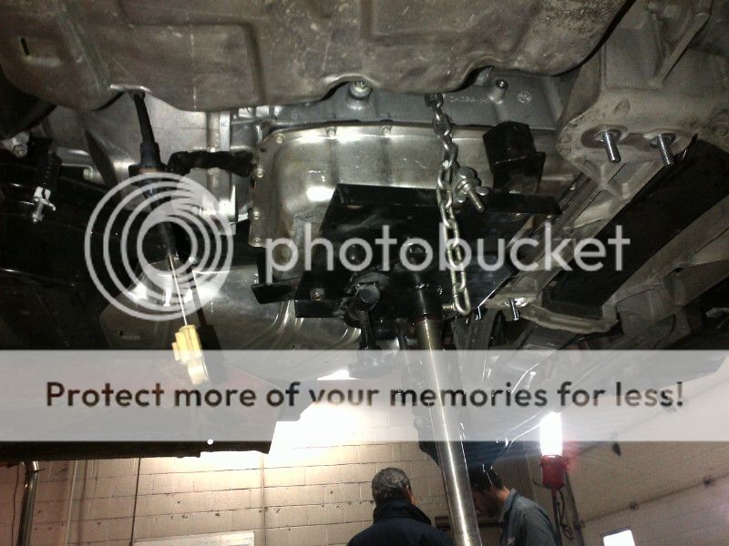

Diff and Trans back in....

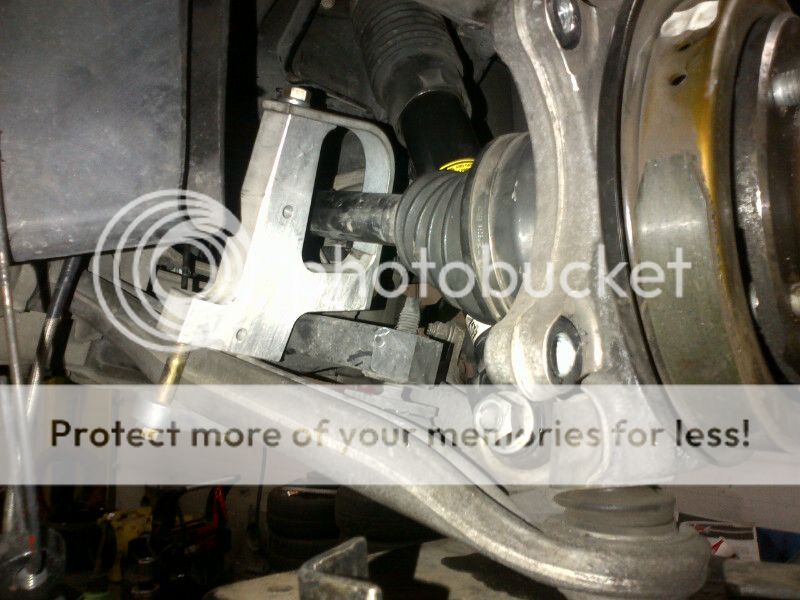

ECS axle loops.. Safety is No. 1.....:D

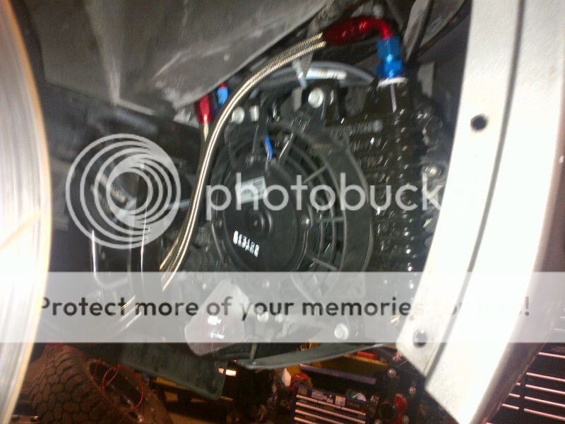

Today I finished the trans cooler install....ran braided lines from front to back...
