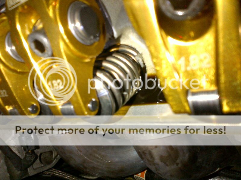

On my last trip to the track this season I started having some transmission issues and also broke a valve spring. Since I started....I figured I might as well go for it. So much going on my head is spinning. The disassembly in these pictures took place in 1 day, with my tuner/mechanic and myself working at a great pace. The list of parts is a mile long... I am scared to add it up. :confused:

Wiesco coated pistons / gas ported / steel top ring

Comp 926 valve springs
Ferrea Competition Plus valves

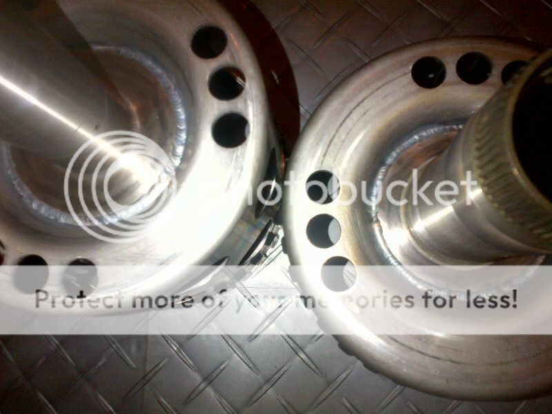

I agonized for weeks researching and trying to decide what to do. I thought some hard parts broke but upon opening the tranny we found everything was fine exept the 4,5,6 clutch pack had burnt and welded together. Seems to be a weak link from the research I did.
After reading everything I could find and talking to many people, (Chuck at COW,John at Century, Rob at Champion, Rossler, etc etc), I did what I usually end up doing. Making my own decision which I will live with, right or wrong.
What I found is that even those with built 6L80's seem to have problems. I believe this is for 2 reasons. First is that although they add more clutches and steels, they are much thinner and therefore have there own issues. Secondly, there seems to be a lot of confusion over tuning of the builds. How much pressure for all these changed clearances, etc. I decided that rather than spend 4000+ and having more issues, I would justt rebuild it for less than half, and if I have to do the clutches every year, so be it. Stock it lasted 10000 miles and many mid 10 second runs with 600rwhp. Actually the day it blew I was trying different things iin the tune and probably caused the blowup myself.
:swear:
Anyways, all that said, I worked with a local guy who has been building racing transmissions for 35 years. Although he hasnt done much with 6L80's he has done tons of 4L's and i let him go at it. Rebuilt with stock parts, but adding an extra clutch and steel to the 4,5,6 pack. I also upgraded the front pump to the new model and added a wide mouth filter. I also welded the drums myself as that is apparently a weak link and it cost me nothing.
This will go with a Circle D triple disc converter and hopefully it lasts the season. I am convinced its all in the tune !!!
