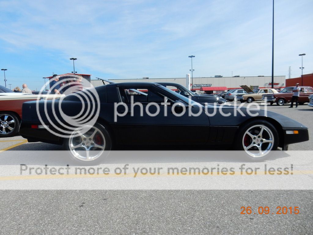

Thanks for the input guys! I went with an aftermarket rim and some goodyears. I will post pics next week.
Thanks again guys ,
Bryan
There it is pretty much like the rest of them lol
Thanks for the input again guys!

Sorry, I win the Internet today...C6 Speedlines.......until someone puts C7 rims on theirs.
Just for clairity, 84-87 have different backspacing and require HUB ADAPTORS, not SPACERS, not the same thing. In the above, 19" rear has a 1.25" adaptor front 18" has nothing...'88 Z51
