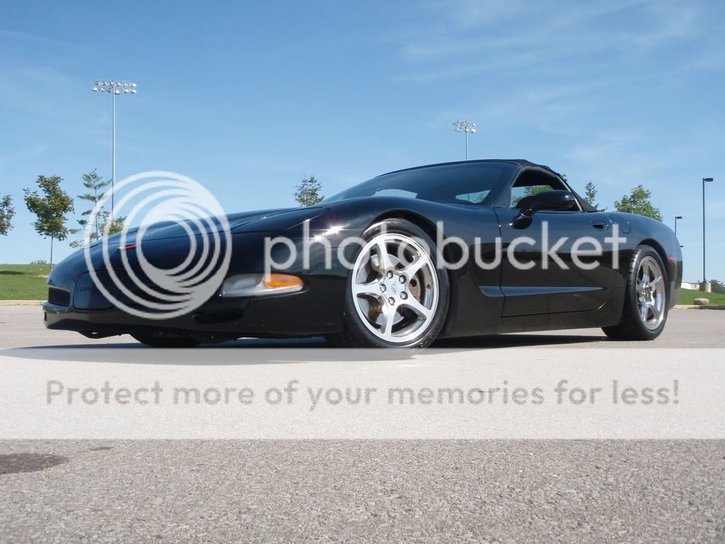

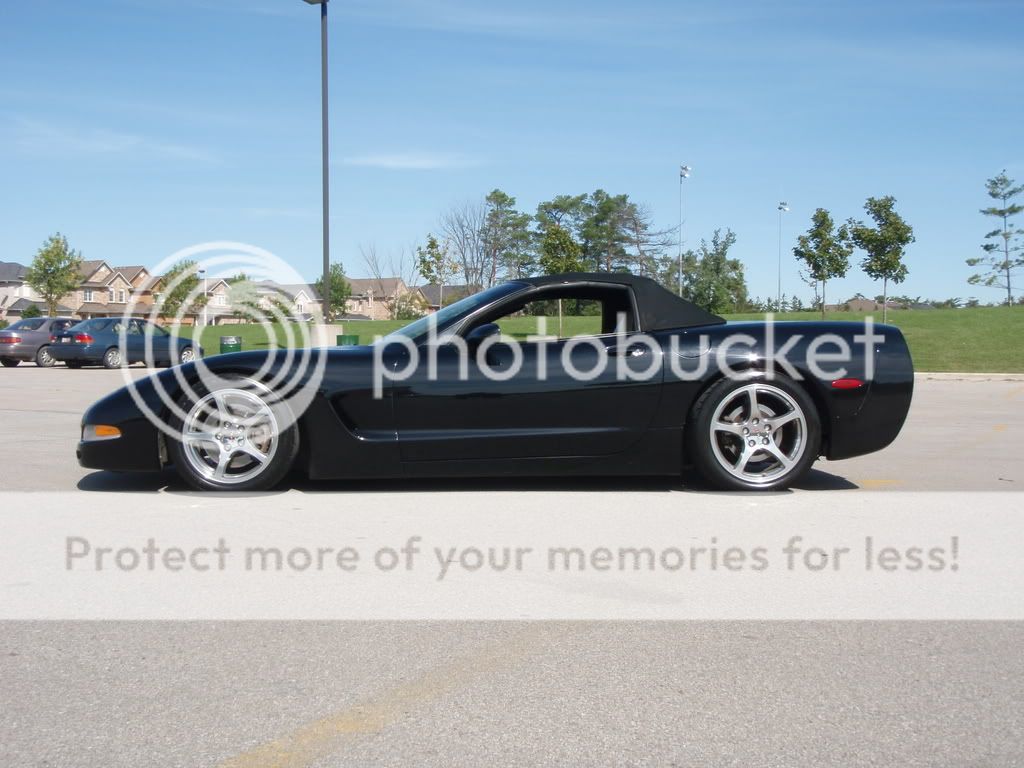

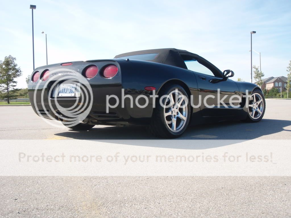

i cut my bushings and dropped as much as i could without removing bolts, and as far as stock bolts allow in the rear, it is no problem to drive around at all. but i am no longer able to park in any underground parking lots, so downtown toronto is out of question unless i know exactly where i am parking/going. thats my only issue. any driveway thats a little steep i take at an angle and sometimes i still scrape, but not a bg deal unless you're going fast. ( i also removed my front air dams, so i am scraping the metal frame pieces that stick out )
love the look, i would not raise it back up ever again.
- Kons
Here is my car lowered last year on stock bolts only, no problems with clearance other then on high speed bumps
you have to go slow or the headers just clip a bit. I did trim a bit off the front bottom air deflector.
