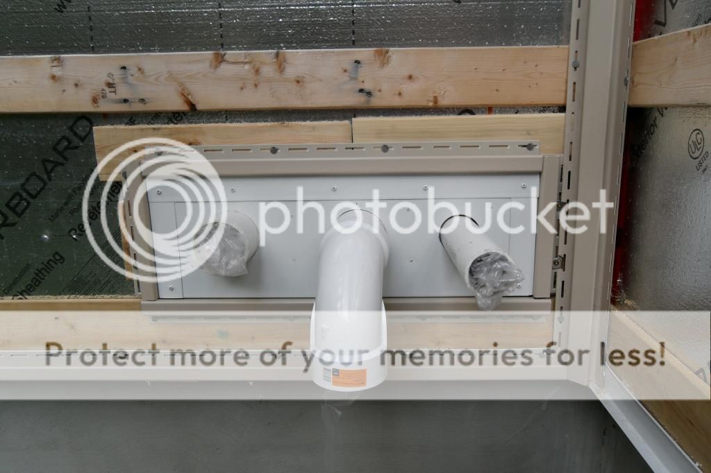

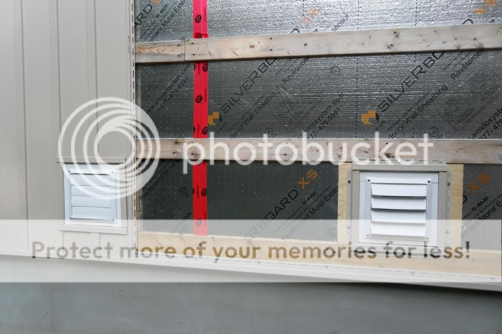

Doug, she's looking mighty fine!! Siding is probably one of the most PIA jobs building your own house, especially with vertical siding. Windows aren't bad to go around it's all those vent openings that are tough and I see four in that one corner. The other thing I see is the ledgers are installed for a serious square dance area right outside the garage doors or is it just a sitting area for a geezers luncheon! Looking good tho and are you in for this winter?

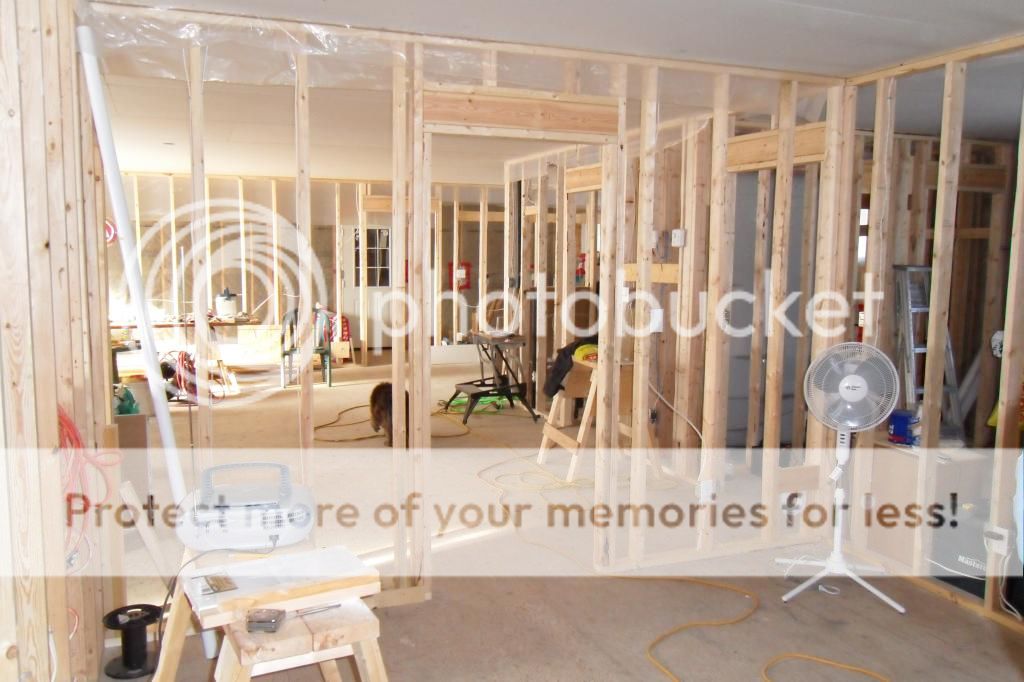

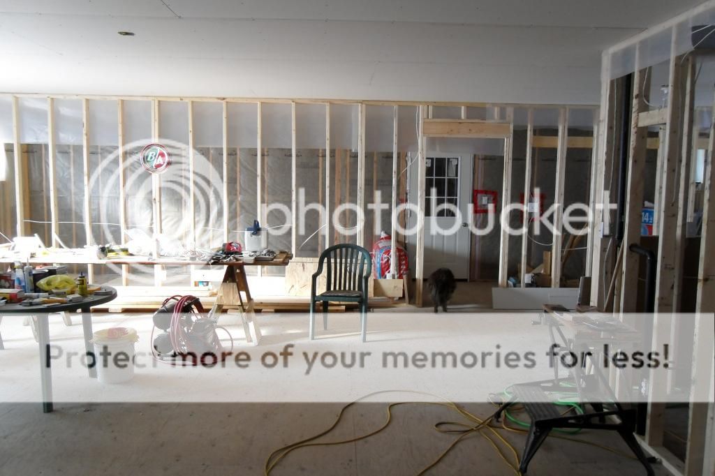

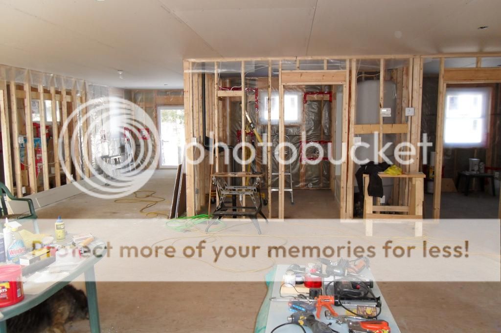

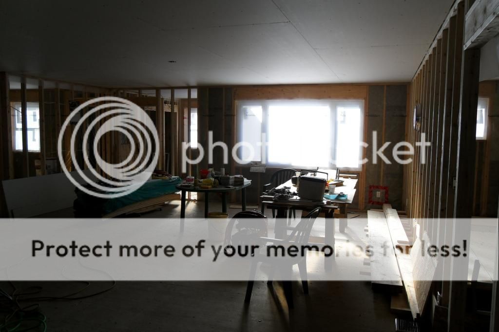

now i'll be back to the construction. we were able to get the vapour barrier and strapping on the ceiling by the time the crew came to blow in the attic - just. helen and i have about 70% of the walls insulated with roxul. i prefer using roxul as it is mould resistant and has a higher r value r22 as opposed to fibreglas r19. i also clad the exterior with inch and a half silverboard which adds r7.5. the propane tanks arrived and hopefully it won't be long until we have a hook-up and some heat.
Sounds like you are making headway Doug. Having some heat will make a big difference in the progress department.
Again, sorry about your mother. RIP.
well the insulation and vapour barrier passed inspection and we have the ceiling drywalled. after doing the insulation, poly wrap and strapping the ceiling, i realized that my shoulders and knees were'nt going to hold out for drywalling. i hired my two pals and i'm glad - they are real pro's in construction and happy to be working indoors in the winter. i leave the thermostat set at 50f which makes it quite pleasant for working and the propane use is pretty good. the house is well insulated - r30 walls and r50 attic. the goal is to have the lake house sold this summer and move summer/fall. no matter what,this summer, i'm taking weekends off to get to some events with the racecar. :D

Progress is being made. I know you know this Doug but protect the furnace at all costs from Drywall Dust. Apparently if they find drywall dust in the components no warranty.
