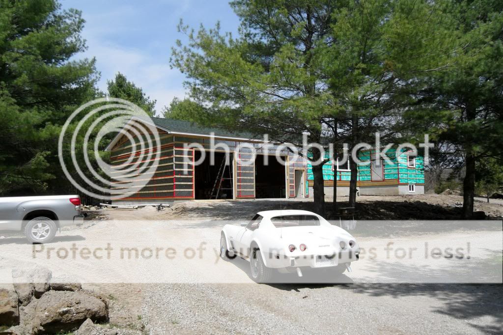

Doug, what a mess. Is the flooding the result of the snow pack melt or is it coming from another source? If there is any good news in all this is that it happened before the house is finished. At least now you can take appropriate measures to minimize the flooding in the future.
Good luck and I hope for the best for you. Just don't back the Corvette out of the garage just yet.

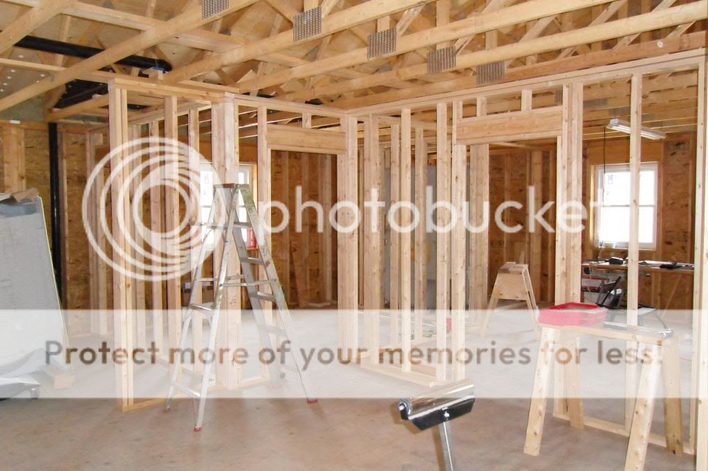

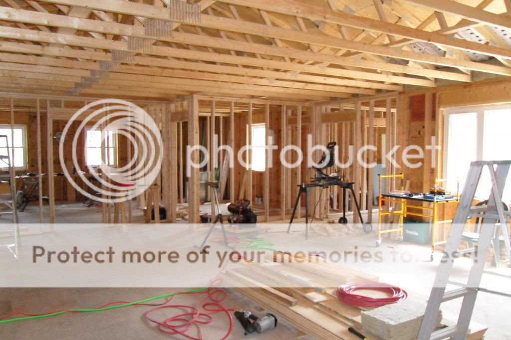

the water finally stopped flowing on sunday so now we can address the problem when the ground dries up with some gravity french drains. they're all the rage in paris :rofl: actually they are named for the inventor - henry french. when framing without a helper, measuring is a real challenge. i have decided to bite the bullet and buy a good laser measure - a bosch unit. will be very handy for a multitude of things. :seeya:
Not sure if I can see the pictures right but you should have vapour barrier between your top plates on inside walls and where the inside walls tie into exterior walls......or possibly you are spray-foaming the entire home??
