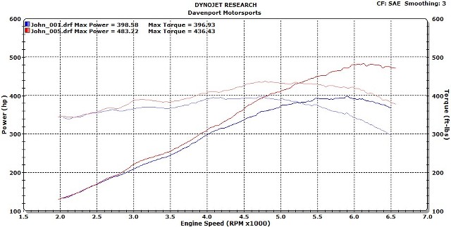

Here you go AlbertaZ06:
2014 C7 Stingray Z51, M7, NPP performance exhaust done by Davenport.
Before: Stock with Halltech Stinger CKN CAI: 398 rwhp 396 tq
After: ARH headers/cats x-pipe, heads, cam: 483 rwhp 436 tq
Details:
- ARH 1 7/8" long tube headers with catted x-pipe and stock NPP axle back
- Lingenfelter ported heads with dual valve springs and titanium retainers
- Vengeance Racing Stage 1 cam (DOD delete cam)
- Katech DOD delete valley cover
- GMPP lifters
- Halltech Stinger CKN CAI (was on car before heads/cam/headers)
