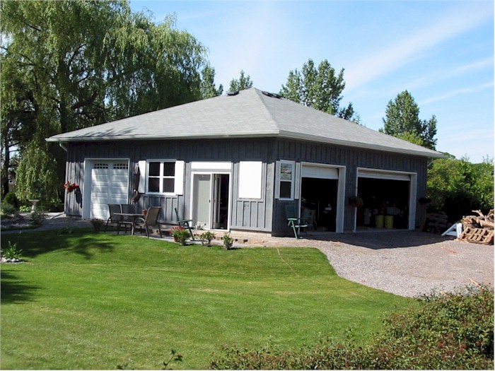

It's now paying for the shop I built for it. ;)
Seriously.
If you do most of your own work, get a hoist / lift.
You sure aren't doing much work under these new ones without a hoist. I wouldn't mind an inch or two more clearance some times. Perhaps air ride? Raise it too much and it would look goofy. I'll have to re-engineer some trusses over the one bay to get enough height. I only have 8 foot ceilings. I've pretty well figured out how to do it now.

On the matter of ceiling height, I designed the shop with the lift in mind and ordered vaulted trusses that give me 13.5' (minus about 6" for the fluorescent light fixtures). Even my Z71 Tahoe can be raised high enough to walk upright under it, and it's about 6" taller than a regular Tahoe.
