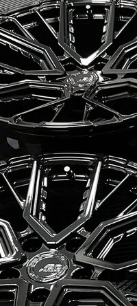

Here is a photo only of an option that one owner is apparently going with except in black and with an added protective coating of some sort.

Which style of wheel/rim do you have on your car? Was it a front or rear? I have a perfect condition rear , black y-spoke design.
Ordered new rims today from MRR... they are forged ZR1 replicas
