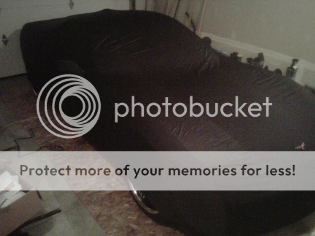

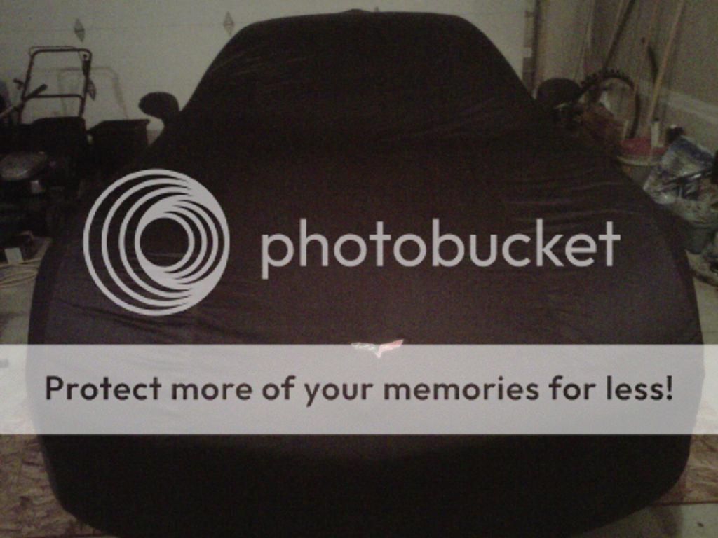

A couple pics of the sleeping beauty.
Note the C-Tek on the floor and the OSB board. Thanks for the suggestions in this thread. I think I did almost everything mentioned.
Hibernate gently, my love. Be well rested for the spring--the headers will wake you up in the spring!
