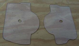

From a bit more "research" I see some recommended the tried and true duct tape solution. A different DIY fix was posted by “MNVETTE” on midenginecorvetteforum November 9/20:
Too much time on my hands last weekend, so decided to try to find a solution to the front shock tower water issue. I had this same problem (water accumulating). I could not find any drain water holes to glue shut and did not want to do anything to modify the shock towers (drilling) or any other OEM part. I looked for existing plastic covers (Tupperware, food container, etc.) that would just cover the shock tower but nothing seemed to fit.
I did have a few scraps of 1/8" thick polycarbonate (Lexan) so I made a paper template, cut the plastic will a saber saw, then sanded and polished the edges (see photo).
To attach the covers I started with a 2" length of 3/8" fuel line, two spring clamps, a 1 1/2" long 3/8-16 stud, and the nuts (see photo).
To assemble, just pull the rubber cover off the shock stud in the middle of the shock tower. Then push the fuel line over the shock stud, adjust the length of the 3?8" stud so enough of the stud goes through the cover to put the nuts on (see photo).
I have not washed the car or been in the rain to see how well it works yet, but with about two hours of work and some scrap supplies I thought it was worth a try.
Hope this helps out and my thanks to "MNVETTE".

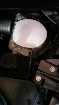

Don't waste hundreds of dollars on a plastic shock tower cover no one will ever see because its covered by the plastic trim 100% of the time. Shower caps and tennis balls from the dollar store. Tennis balls are only there to give it a little elevation so water doesn't pool.
Note the leaking brake fluid from my front end lift. A trip to Wilson-Niblett for the blue cap is in my futre.
Good fix. Blue cap arrived at my dealer today😀
