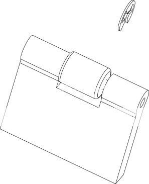

    My '05 didn't have the popping of the roof panel until I drove over some rough construction areas.
    I read all the threads, and it seems the culprit is [mostly] the roller in the latch.
    One recommendation is to jam in a small nail or staple to prevent the roller from moving. I did that and it seems to work, but I frankly could not see why preventing the roller from rolling would eliminate the noise.
    I experimented, driving the car with the latch totally disengaged, and also engaged with the latch stopped on the tightest point, just before the final latching. In both cases, there was ZERO noise.
    I believe that maybe it is the axial movement of the roller as the body flexes that creates the noise - either the roller moving on the pin, or actually bottoming out on the latch cradle.
    [​IMG]
    [thanks to Y2KC5NBM for the original picture]

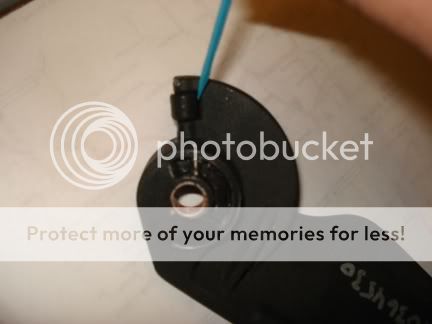

    [​IMG]

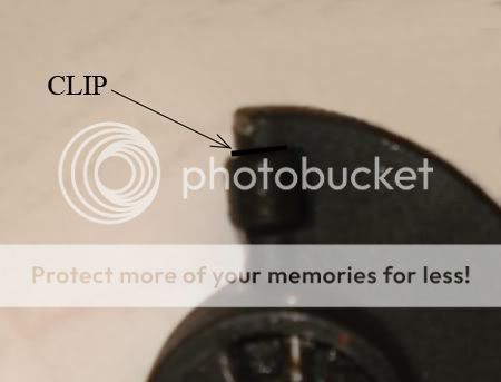

    I installed one as shown:
    [​IMG]
    [​IMG]
    The thickness takes out virtually all the end play, but the roller still rotates as it should.
    So far, no noise after two days - easy install, don't really have to remove the latch, but that makes it easier......[​IMG]
