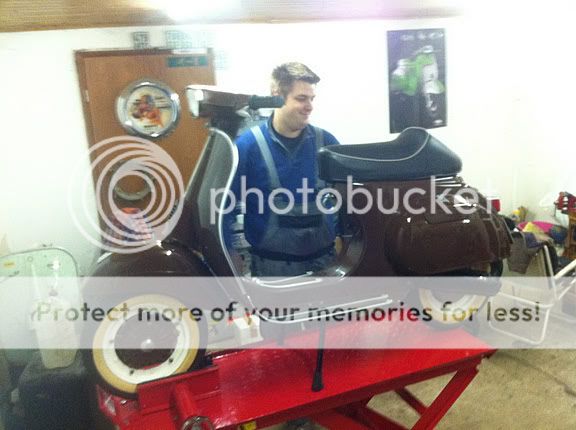

yesterdays work on my chocolate

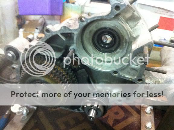

build a new engine
the old one was to slow ;-)
also only 50ccm but the original high performance with 3,5hp
and 70kmh not 45kmh
original racing exhaust called banana
original racing crankshaft
original ignition (only a third of weight)
original hp cylinder made from alloy

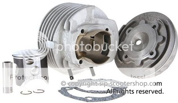

no more 112ccm engine - i bought a 130ccm ;-)
called falc racing an the best what you can get (without membran injection)

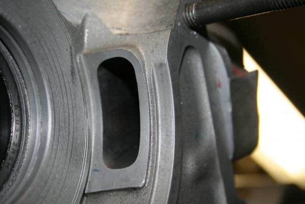

the engine case is a special one
Normal
Larger very rare
so i can make the intake bigger = more power ;-)

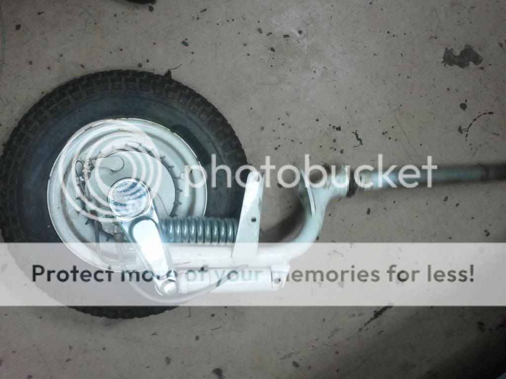

for better braking i bought a steering tube from a other piaggio scooter called skr
with disk brake ;-)

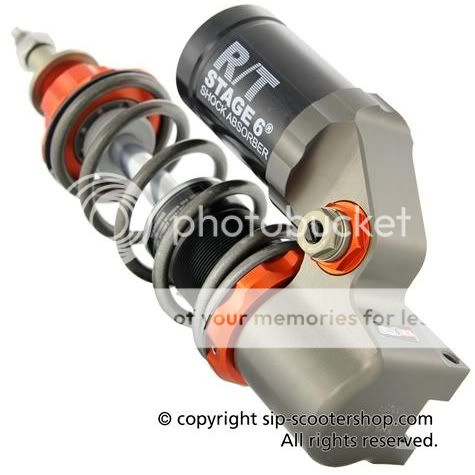

ill change the suspension and need this one
much expensive for a vespa - standart is 25€ - this one cost 350€

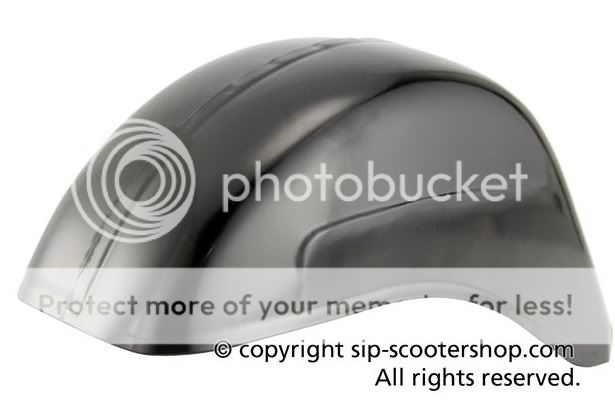

the mudgard i allready have - in gfk
standard
and mine
with space for the compensation tank of the supsension

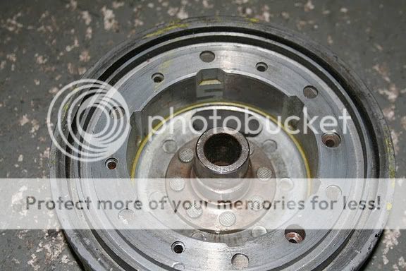

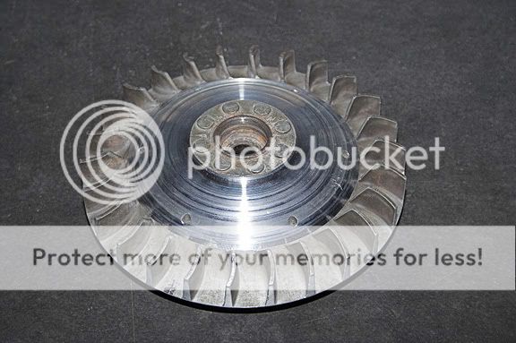

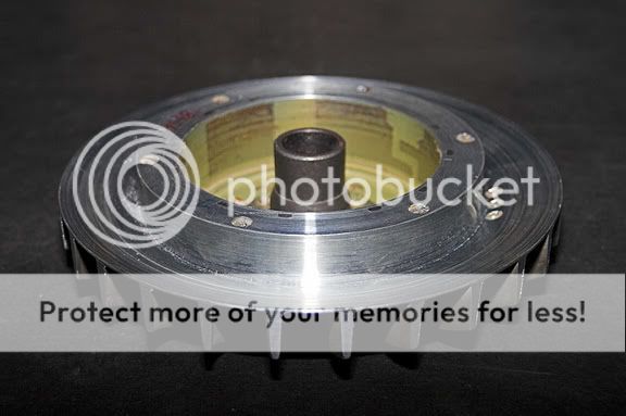

for better ignition we reduced the flywheel
original 3,2kg
mine 1,3kg

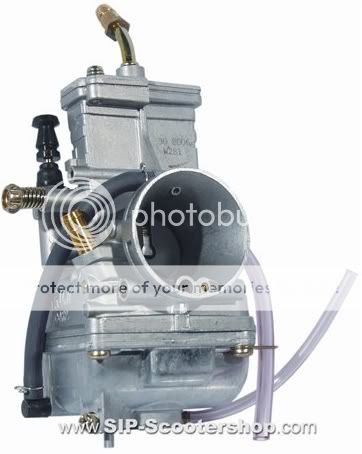

my new carburator
standard 10mm
now 30mm

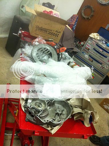

allready arrived

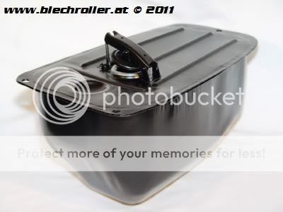

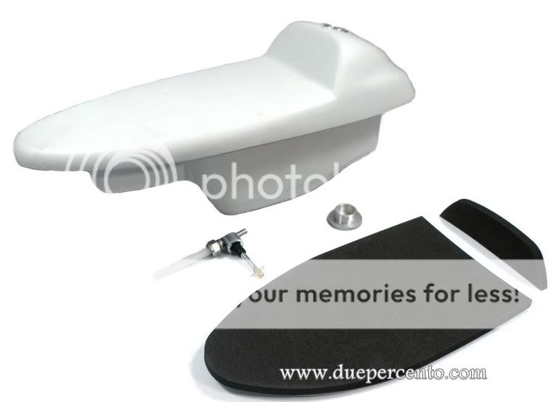

for more range i bought a combined seat-tank
Original 5 Liters
the new one 7,5 Liter
also allready arrived

the stage 6 suspension - 350€
