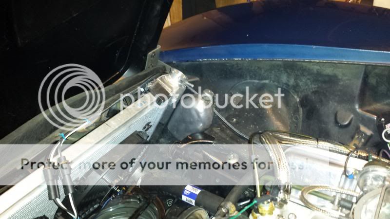

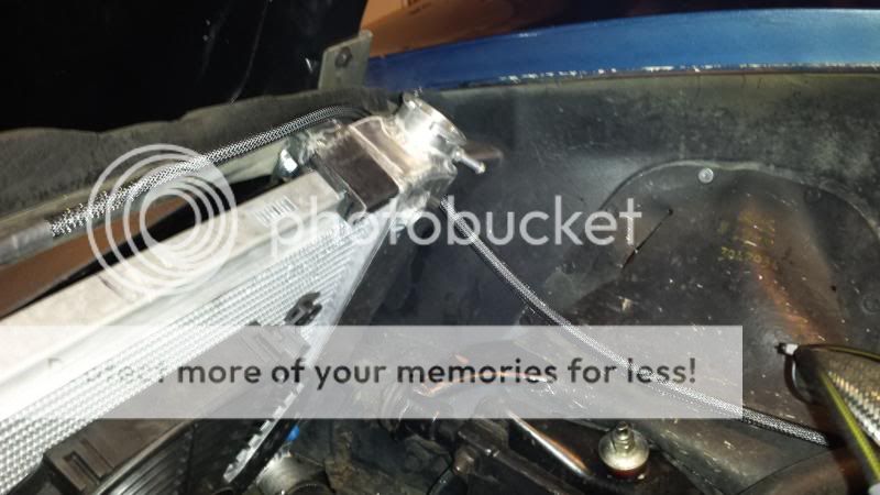

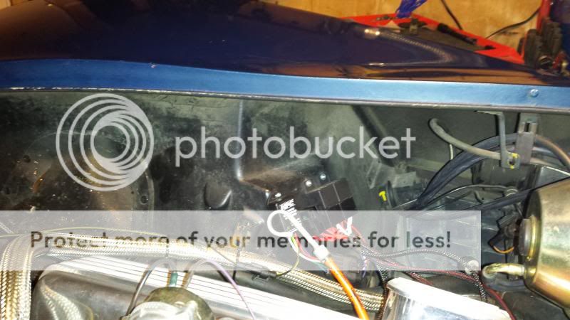

Ive been making plans for another mod I want to do.

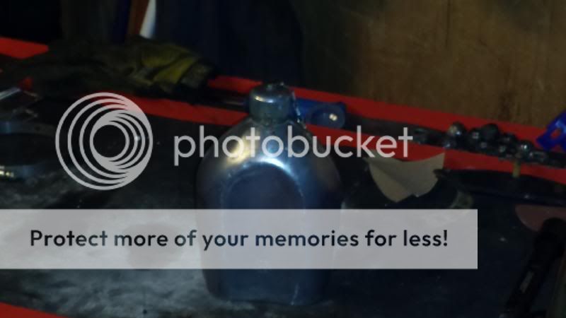

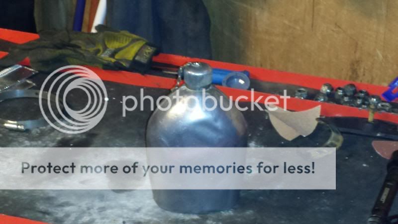

The LT-1 car apparently never had an overflow bottle for coolant.
I want to put an overflow in but Ive mounted my fan controller to the spot where the stock one would have went.
So my "rat rod style" solution is to put this in to catch overflow.
Some of you know what this is.
its an army water canteen. its aluminum and has some interesting patina on it. I still took some metal polish to it and I have to decide how to run the hose off the filler neck to it. and also I have to mount it some where.
I need some input.
There are a couple of spots ive been looking at on the inner fender to mount it.
one is right above the fan controller and relays.
The other is just between the rad and upper control arm.
What do you guys think?
Have a great day all...
Dave
After being an electrician for many years I can safely tell you water and electricity don't mix. I think as close to the rad as you can would be best. Also make sure the hose to it goes right to the bottom of the canteen so it can draw the coolant back, cooling down.
Cheers Rob

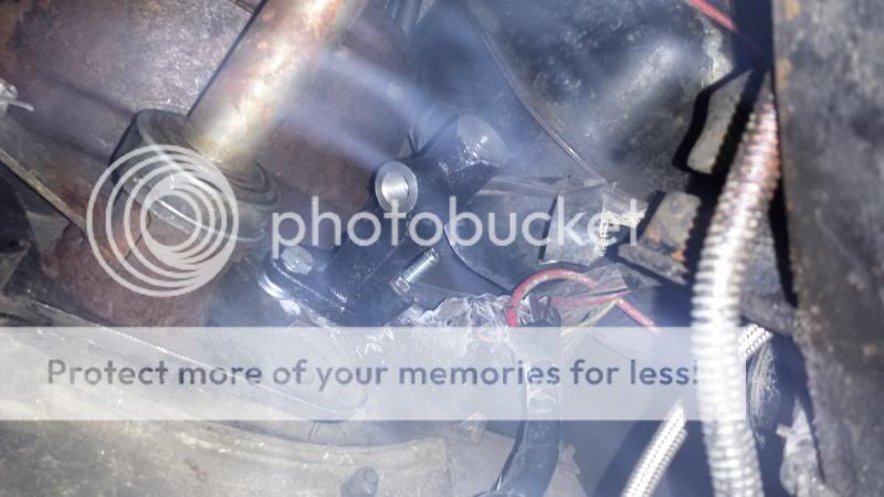

there we go. finally!!!
works great. BIG smiles today
Thanks Don
the header flanges are no more than 2 3/4" off the ground. at best. lol
heard them scrape lightly once. Ill have to be careful.
What a blast.
After we bled the clutch it operated so nicely I said the hell with it. put the tires on and pumped them up. and took it around the block. Then took the boy for a spin around your area, all with no licence plate. lol
just a blast. feels good to know I can be at the meet and greet with it under its own power.
Brakes need to be bled now. very soft. easy to do though..

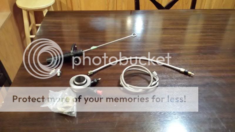

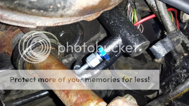

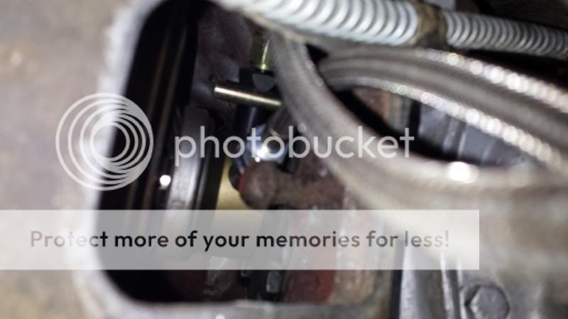

The hydraulic clutch...
I had doubts it would work at all.
in the end it cost me about $250 +- to gather all the pieces.
Hydraulic release bearing w\lines 170
mid 80s chev half ton master cylinder 35
reservoir 16
AN 4 to M12 adapter 6
easier than I thought and is so smooth.
