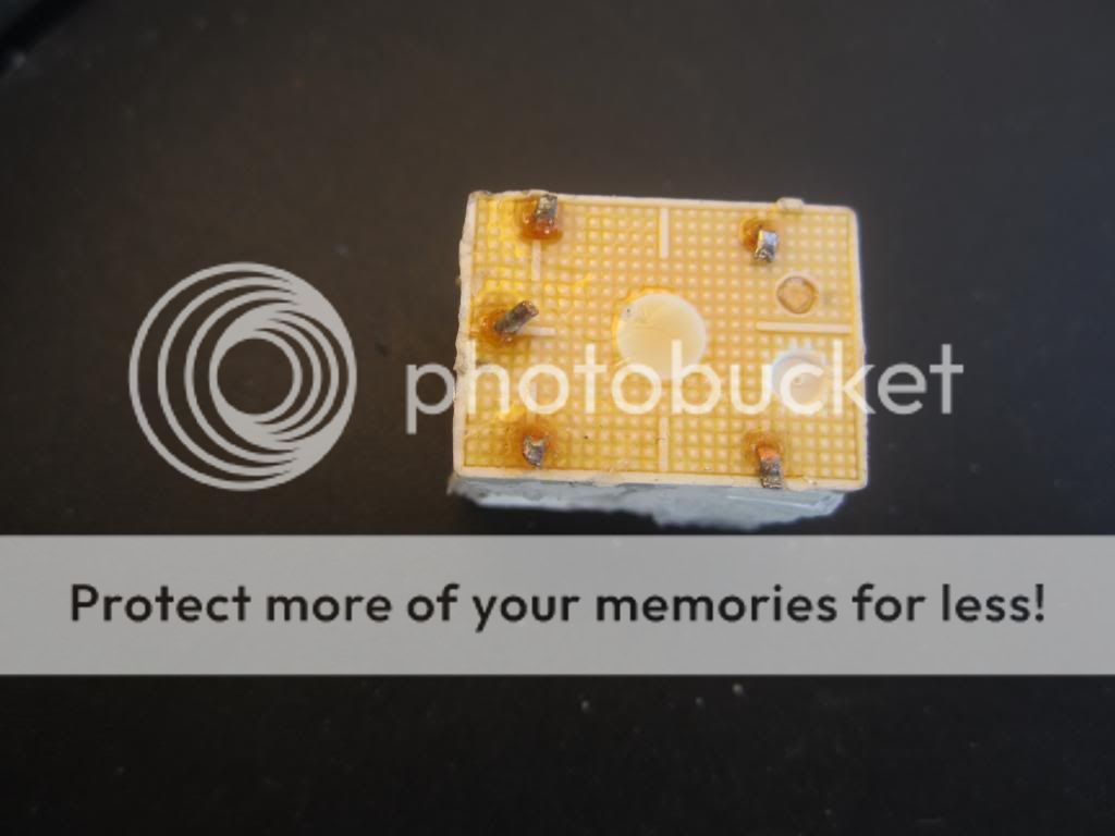

take off your EBCM from the car ..open EBCM FROM HIFE SLOW WAY so you dont break the seal ... you be see the relay inside take that off and order new one for 2$ only and put that new relay back by solder and buy some clear silicone for over heat and that all your EBCM FIXED
