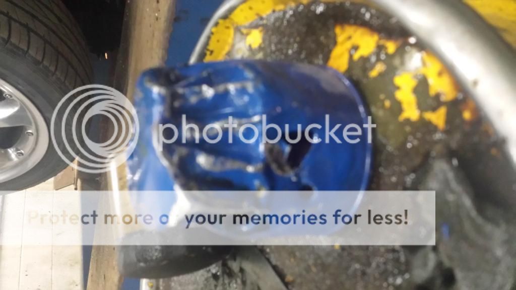

Got the car up no problem. Got the drain plug of--again no problem. But here's where the fun started. The damn filter wouldn't come off. I used several filter wrenches to no avail. My headers made it tough to get any grip on the filter. I resorted to poking holes in the filter with a screwdriver to turn it. Here is the end result.
![](/proxy.php?image=http%3A%2F%2Fi1147.photobucket.com%2Falbums%2Fo543%2FVincheese%2Fimagejpg3_zpsf9d3fc3f.jpg&hash=cbc4d98158ff4982fe0a3647351bec11)
After an hour, I found a tool that looks like a grail to finally break-free. It took two seconds, and things were back to normal. On a side note, I purchased a K&N filter which has a screw on the bottom. I will be ready for this next time. I have to admit, I was getting kind of grouchy, as the clock was ticking on my hoist time.

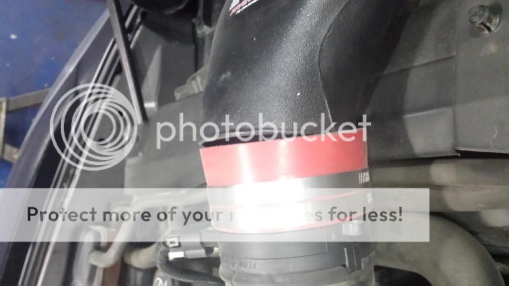

While under the hood, I noticed something wrong with my air filter....have a look.

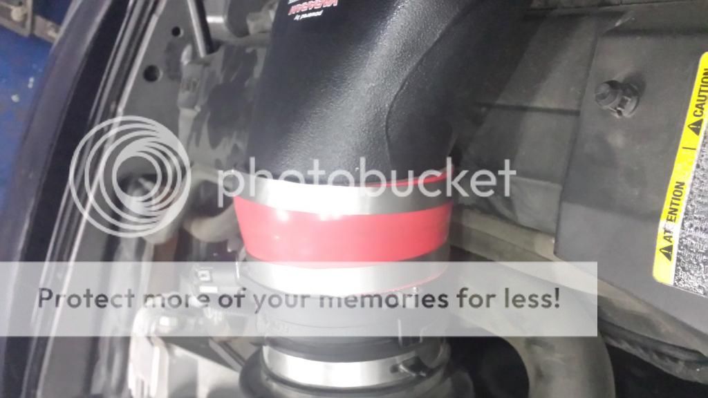

This was loose for a day or two I think--and that's because the engine even sounded slightly different. I realigned, and now it looks like this....
![](/proxy.php?image=http%3A%2F%2Fi1147.photobucket.com%2Falbums%2Fo543%2FVincheese%2Fimagejpg5_zpsd4a0925f.jpg&hash=8e8bdaf5a7bc830a267931f4f145cf42)
Sum as a bug in a rug!

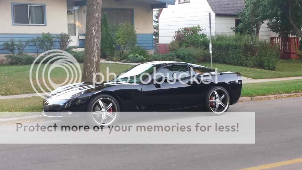

Now I'm out driving and getting ready to add the Stabil!
