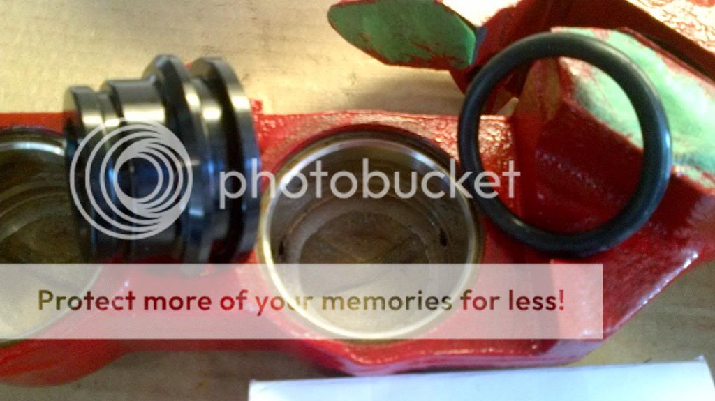

The calipers look the same but the seals and pistons are different internally.
I just did the front calipers on my '75 with 'O' ring seals and pistons.
I was going to write a photo-blog on the process soon.
I hope this helps. Are you planning to rebuild or replace your calipers soon?
I hope this helps. Are you an planning to rebuild or replace your calipers soon?

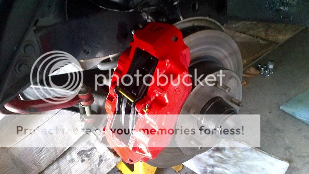

Just got back from a business trip to Windsor, stopped into Corvette Depot and exchanged my lip seals for four o ring calipers.......$616 CDN out the door. Dropped into NAPA while I was in town, as they have their Dupilcolor caliper paint on sale for $14.99 instead of $26.99. New Raybestos hoses from Rock Auto on sale for $3.99 each. Pads are still about 85%, and finally a new master cylinder from Parts Source $29.99 after the core. Gonna be a busy weekend, now that I've finally got her home. My Motive power bleeder, and new torque wrench should come in real handy.
P.S.
Just a quick note to let you guys know that the calipers that Corvette Depot sells are from Lonestar. Real nice piece of kit, Delco Moraine cores that look like they just left St. Louis.....and they're already painted at the factory.
