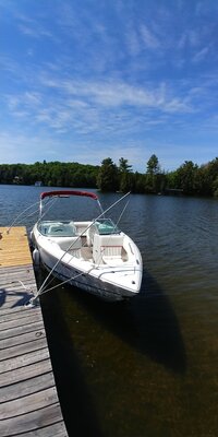

At the cottage near Parry Sound.
2 x Sea Doo RXT 300 HP
Cobalt 220 with 496 HO
Must admit, I like Horse Power.

Give us a breakdown of the buildup, block, internals, etc.
Have you baseline dyno'd?
Really nice looking.
The boat is a 18’ Catalina jet boat.
This model is their bubbletop
It’s from late 70’s early 80’s.
The Catalina is a Canadian boat built by California Marine in Richmond BC.
These boats gained a lot of fame back in the drag boat racing scene.
The engine is a
I just replaced the crank and bored out .40 over.
Keith Black flat top pistons all balanced rotating assembly done at D&W Racing Engines in Calgary.
The heads are Darts with 68cc that have been ported and chambers able to flow 200cfm.
Comp Cam cut for a cut jet
Edelbrock 650 carb manual choke
Basset Racing headers and over $1500 worth of an fittings and hoses.
It has not been on a dyno but should push this boat up close to 60 mph.
Today I’m shampooing the carpets and will be taking it out sometime during the week for a cam breakin and timing and carb set up.
I have another one of these Catalina‘s that I will be dropping its bbc 454 bored 40 over as soon as I have this one finished.
More to come
Cheers 🍻

This morning I took the boat to the lake to break in the cam and set the timing.
I left the boat on the trailer to break in and timing adjustments.
Ran it for a half hour with the idle turned up to 2200 rpm blipping the throttle the whole time.
After I was happy with everything I took it for a quick rip around the lake.
GPS says I hit 87 kph so I’m happy with the performance,I’m sure as things loosen up over the next few hours of use it may pick up a couple of klicks.
