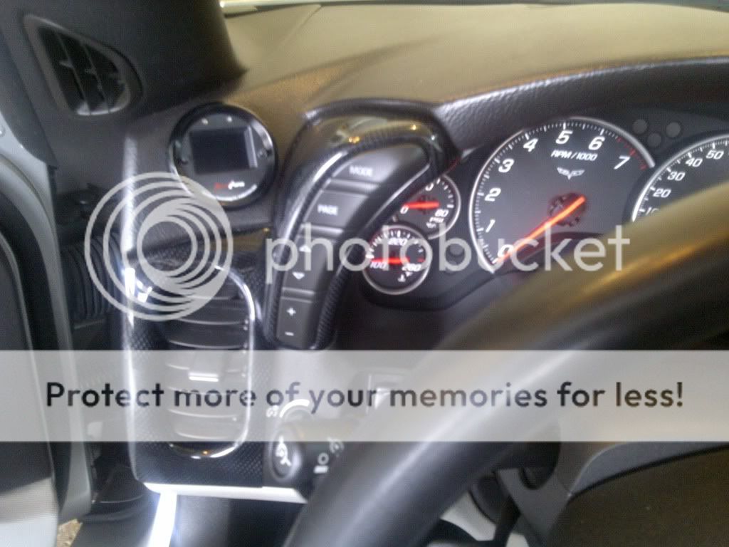

its true that under hard acceleration with boost, there is no way you will be reading a gauge, which is why alarms are important. I set the alarm in the aeroforce to go off if, for example, boost is over 3lbs AND afr is over 12. You can set it for anything you like.
As for the meth, gauges are available but I just have the LED from the alky control kit right beside the gauge. If it doesn't go green, I'll back off as I would know something is wrong. Safer than trying to watch a gauge when running 10's down the quarter.. :eek:
Aeroforce Technology Inc | Products - Interceptor

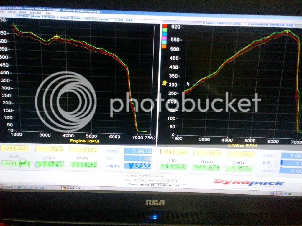

That is one speedy car you have! Any idea the final dyno numbers from the build?
That is an interesting gauge that you have. It sounds very versatile. I can't see the Alky Control light beside the gauge yet, is it that subtle??? It sounds like something that might be a good compromise, especially nice to be able to set an audio alarm rather than having to eye the gauge itself. Something sounds so you don't have to look at what but immediately back off.

That picture was taken just before I installed the Alky system. I can take one with the LED if you like.
It makes 615 rwhp and 640 lbs of torque. Many changes coming over the winter to try and see a 9.99999999 lol

Thanks for the reply. That is a very impressive piece of work for a 6 l LS2. I makes me excited if Manny can get my engine in the same range. There is a sports car club in Grande Prairie and one of the faster cars is a SC'ed Mustang what can run just under 11 sec. If you're running about 1/2 second faster than that car then I might have to take a ride there to see if I can de-thrown that old horse!
I'm glad that I didn't miss the Akly Control light! I looked at the picture for a long time and kept telling myself "why can't I see it?". Then I told myself well I just have to ask him about it. It made me feel better to know it wasn't in that picture.
Which two perameters do you normally display most often??

It really depends what I'm doing. Its just a push of a button to toggle through parameters. If I'm driving hard I'll watch boost, afr, and sometimes watch for knock. If I'm just cruising around I'll play a bit and check on my fuel trims, for misses, and a few general things just to see that everything looks normal. It always does but I'm anal that way.
Keep in mind all dynos read differently and it just a number for reference. The track times really tell the story.
