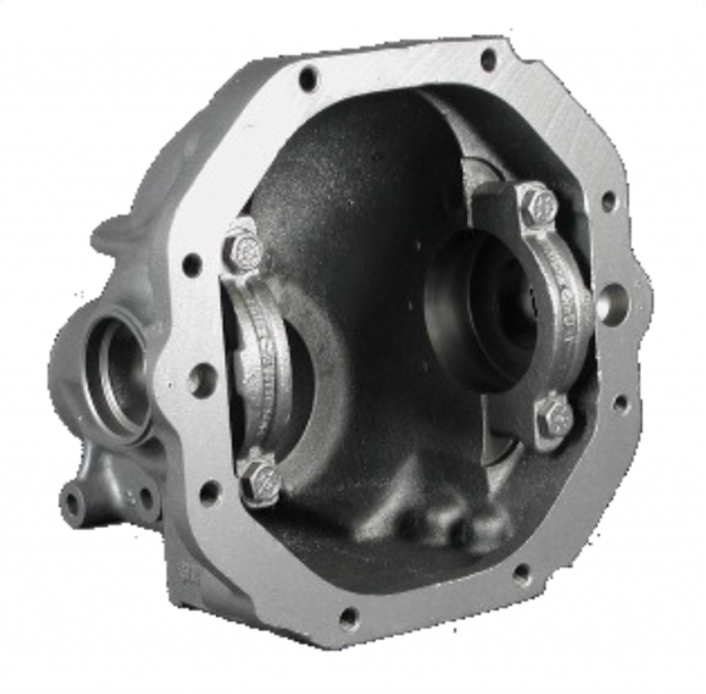

Bro - depending on your budget and what type of power you want to run through the rear differential, there are options out there. Sometimes I wish mine blew up so I have a reason the change the gear ratio :) There's a lot of stock replacement options there and maybe that works for you.
Budget has been taking a hit! Lol the carrier is really the big issue. Gears and pinions are everywhere. Its finding a replacement carrier that seems to be the problem!
Hmm - Have a look:
It's the Canadian Vendor but I don't know any history on these units. Also - I bet if we stick our feelers out someone would have a used one in good shape?
Im all about feelers now! The crate engine and custom built 700r4 ate up a huge chunk pf my budget! Lol the case is good. All the bearings are good. Even the seals were good. Just the carrier and a broken clutch plate.
Just cant put all this work in to the build, just to put a semi repaired carrier back in!
Everything i have found so far is ridiculously overpriced
Yikes - that’s a pretty big investment there. But having said that, you have a OD trans and would want to change the ratio anyways..... yea?
3.55. This puppy was stock front to back. Numbers matching all original, right down to the air filter, all neglected to the point of no return! Lol
You have your work cut out for sure.
Looks like 3.70:1 is the "Lowest" gear ratio you can go with out serious modifications.
