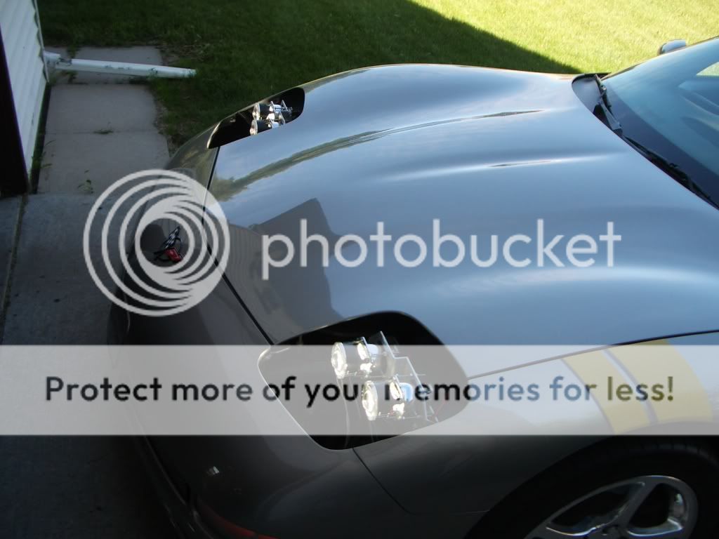

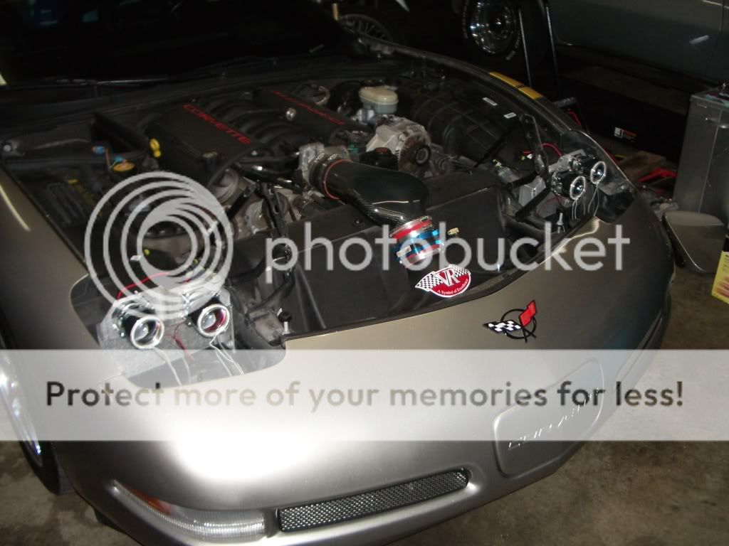

Lights mounted
Testing the lights.
Shrouds on
Terminators on. :D
Lots of light now with 4 bi-xenon projectors!!!! 12,000 lumens compared to the 1,600 or so of the stock ones. My only problem was aiming them. Very easy to do but getting the height set properly so I don't blind people yet still have them shining down the road was a balancing act and took about 4 rounds. It's actually really good. You can adjust each one's rotation, left/right balance, and height individually. This summer I plan on playing with the distance from the reflector housing to the projector lens to see what effect that has.
:agree: Those lights look really nice....but just one question, are they legal ? will the police hasel you with this..?:(
I definitely can't drive around with the terminators on! I imagine the cops would have a big problem with me having red lights on the front of my car. I only flip them on for fun when I am parked.
The shrouds are custom designed around the lights and it all comes as a package. I have all my stock headlight equipment in a box in case I ever wish to go back to stock or try Radioflyers pop up units.
