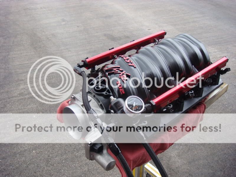

Here it that white beauty:
On the lift ready for a little HP injection
Ah the tear down
You all know this look , a great evil is about to be unleashed
Where else would you see an engine getting vacumed

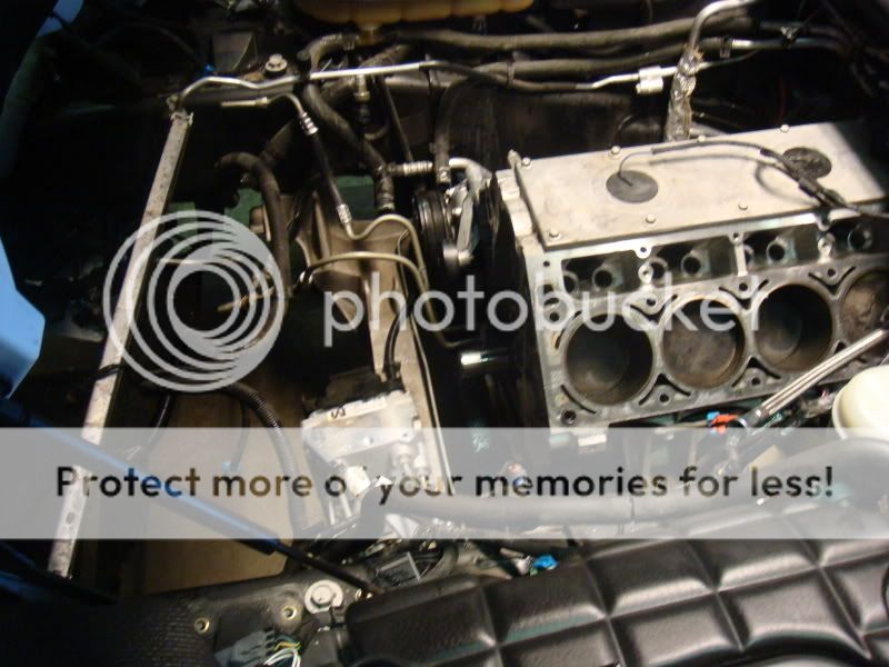

All apart now
Ready for the big stick
Ok does anybody have any idea's as to how all this goes back in :confused:

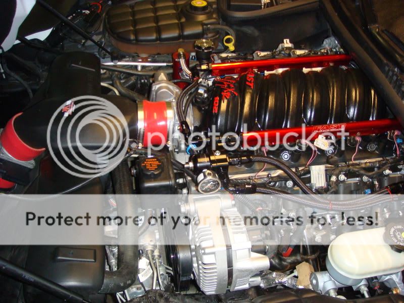

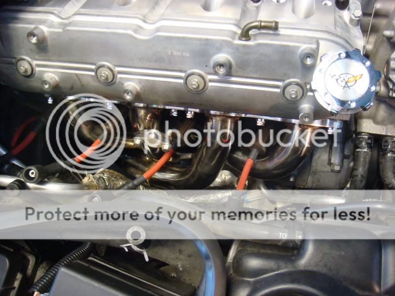

Who Manny, you work fast ! What are the two wires going into the top of the block for ??
Myself and Rob have built 1 or 2 of these before:rofl:
The two wire's on the valley cover are the knock sensor's.

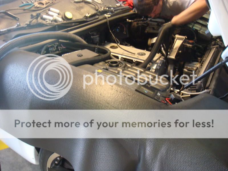

Well its 8 am here on Sunday, Rob has arrived with the Timms , so lets get this build moving :driving:

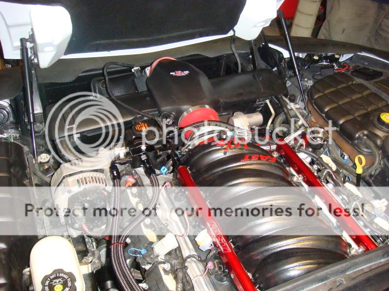

Yet another late finish, but we got it all done !
Video is kind of crappy , but you get the idea .
Ok off to the dyno, see you later this afternoon with the report.
