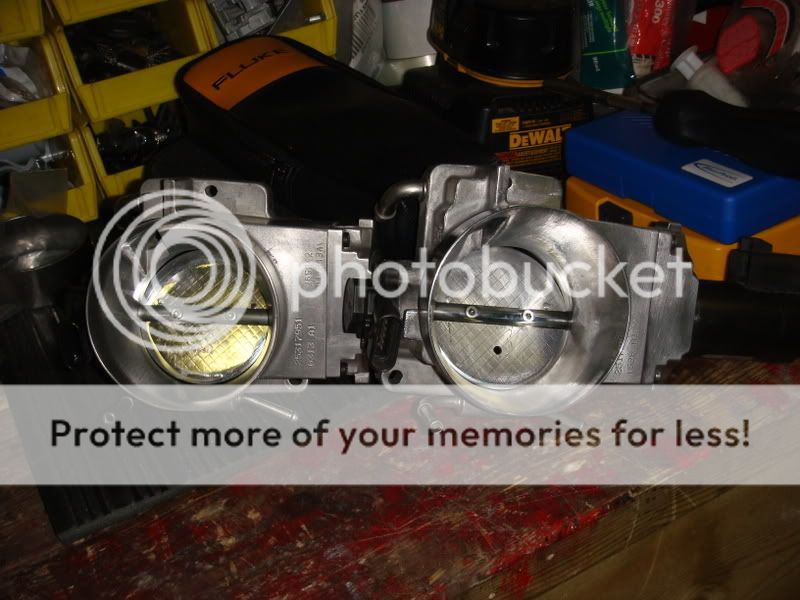

Tell ya what Howie I have a few spare's here , I can do one up for you for $50.00 exhange . Here are a few pictures of some I have done .

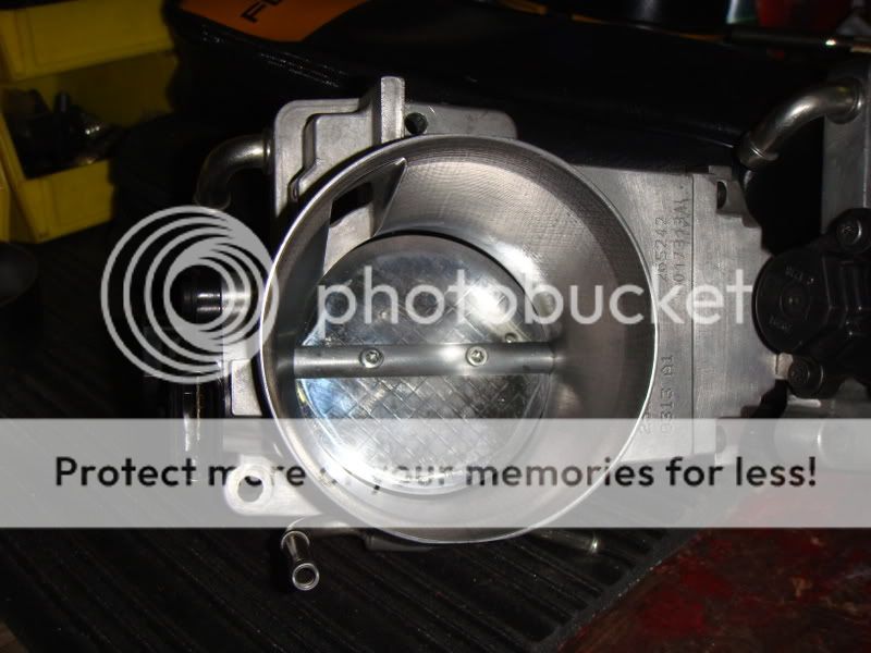

This is one of the LS2 90mm

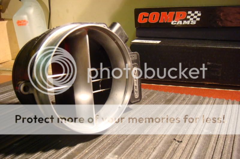

I have also done some MAF's

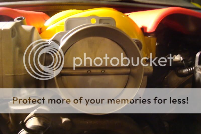

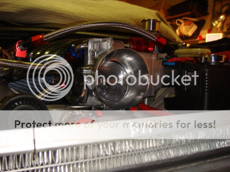

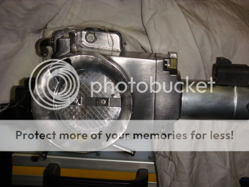

Some C5 TB's

Isn't filling the PVC area inside the TB and then drilling a quarter inch hole to allow the PCV to function part of the procedure?

You can fill it with JB weld also, but it is not nessacary .

You can use your stock MAF with the ported TB 76mm or the 78mm C5 Z06 one.

The 78 mm refers to the actual throat area , which I do not touch as then yoiu would need a larger butterfly . There are some that have done it , but you run in to problems with the Drive By Wire system in the vettes. Not2melo had an 80mm he bought on ebay from a shop that does them . Now they will work on a cable driven tb, but not so good on the DBW system.The tbs I use are 78mm and there is no gain in going to the larger Z06 maf with your set-up .

As Manny said, I tried to get a 80mm ported unit that was welded in the thin areas to get that hole diameter.
They used a brass throttle plate and the unit was a good piece, but in making the opening wider
they mill out that oval or stepped slope in there that allows the airflow to slowly ramp up
when first opening. This in turn caused all kinds of problems with the car and we had some DIC
errors going off that cause the Reduced Power Prompt.
I would suggest getting one thru Manny and enjoy the quicker throttle response, if you feel like going all out
then get a ported FAST 90+ off him and add in a LS2 TB and a Z06 Maf for 20+ rwhp with a good tune.
