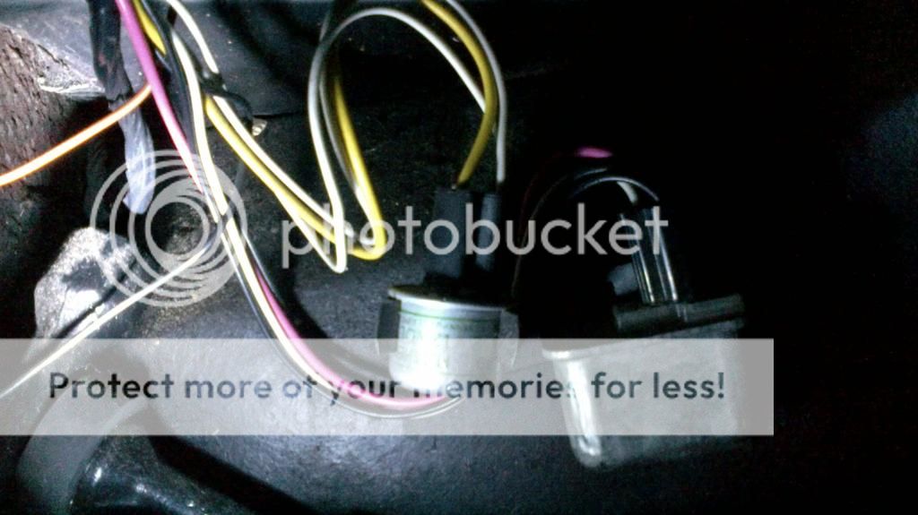

maybe part of a "once upon a time" behind the seat sound system ? where does the harness trace to ?
I didn't have the time (or sufficient immediate interest) to trace them forward but I'll see if I can determine that next time I have the center console pulled apart.
I do have a wiring diagram that might provide a clue as well...
VV
Hey VV....
I suspect they are for seat belt interlock wiring...
Although in my '75 jack compartment I only have wiring/relay/flasher related to the alarm system.
This can also be found on page #434 of the Corvette Assembly Manual.
I don't have connectors like in your picture in my compartment. I wonder if someone pulled them from under the seat into this area?

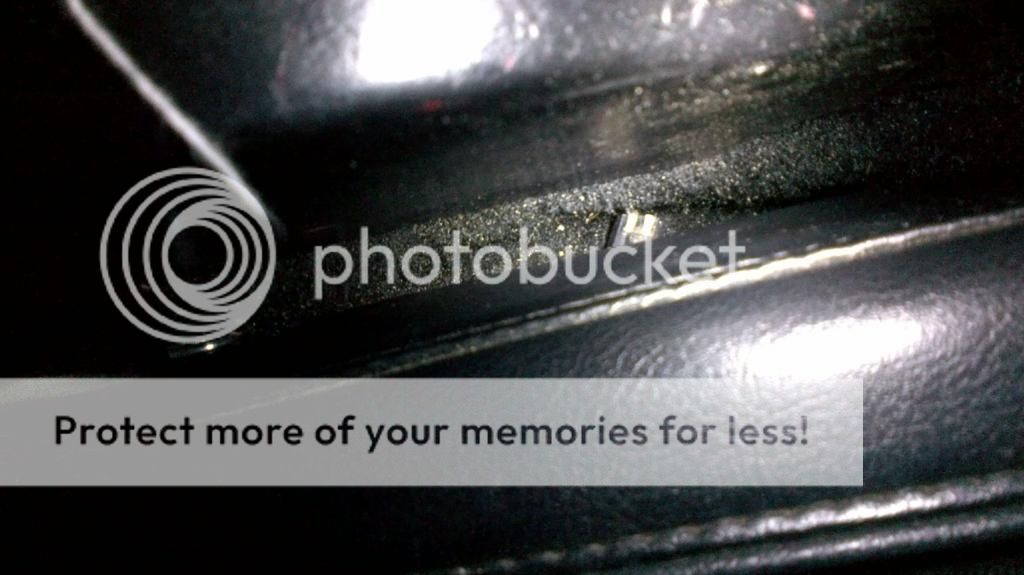

Here is a pic looking down between the passenger seat and the console..
You can see the seat pressure sensor wiring/connector. I believe it looks like it might be the mating connector for the wires you found in the storage compartment??
Look under your seat and see if this connector on your car is unused.
The black/grey wires come out of the bottom of the upholstery from a sensor switch in the seat.

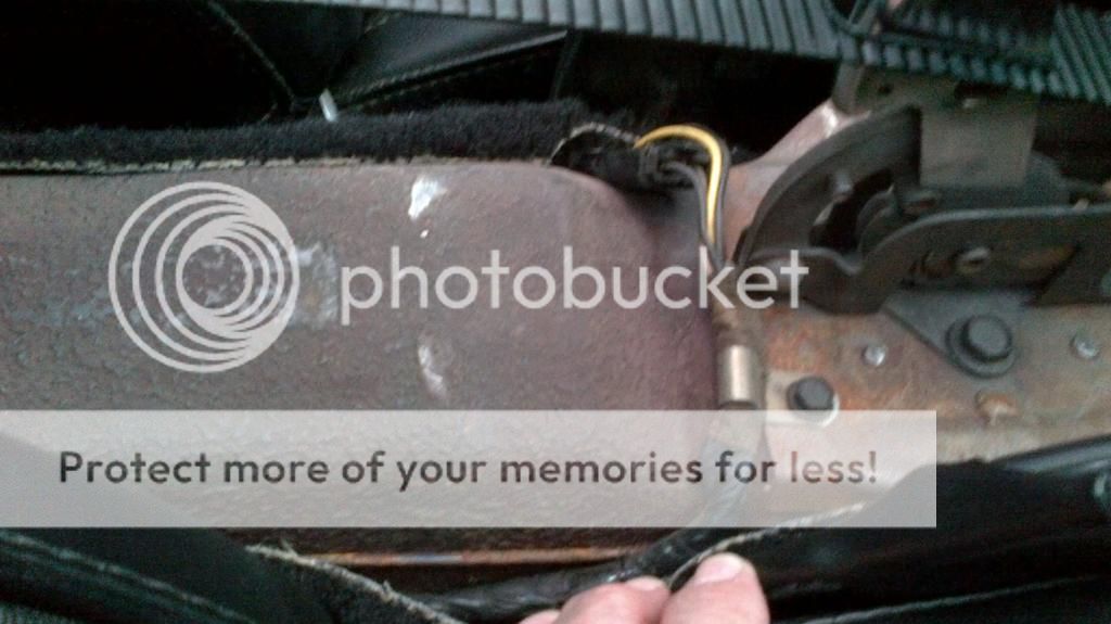

There are other wires that go to the seat belt assembly as well..

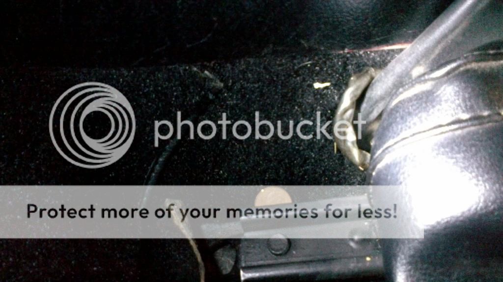

Here is a shot with the seat moved forward and you can see the tape-wrapped wires going up into the seat belt plastic...
(oh look!...I found a penny!)
I think the wires you show with the clamps are for the seat belts..

I looked at the pax seat and saw a clear tube coming out from under the seat next to the console with a couple of wires inside. All had been cut and taped off. Sounds like someone's home made solution...
