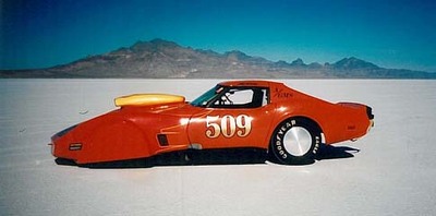

always loved that look, thinking of the full sized spun aluminum ones for when we run at Bonneville this year. Brian has also promised a set made out of balsa as we try, once again, to kick start our wooden spoiler project.
This is the look we are going for
