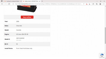

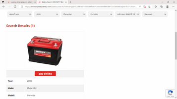

I looked up Odyssey's website and shows this battery for your car. The BCI # of this battery is group 90 so if you find a group 90 battery it should work on your car (just make sure the battery terminals are in the right place so why I suggested you pull your battery if it's dead and bring it in somewhere to compare to the new one).

  • Battery Search _ ODYSSEY® Battery and 1 more page - Profile 1 - Microsoft​ Edge 2022-06-21 5_4...png
