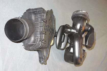

This is stock unit GM stuffed in front of the LT1. Part of why I went with a CAI was to improve the look in the engine compartment. IMO, GM used a big ugly stick on the stock intake.

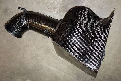

This is the Halltech unit sans small bridge that hooks to throttle body. The Halltech uses nomex sandwiched in the carbon fibre to combat heak soak, and a K&N filter. Halltech says tuning isn't required to run it.

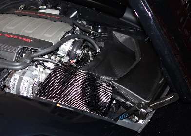

You need to tie the top rad hose to the bottom rad hose to make clearance for the Halltech box, which is quite a bit bigger than the stock air box. A heat shield is provided to help avoid heat soak from the rad hose. You also re-route the coolant overflow from above the stock box, to this same area under the box. Although you could leave the coolant overflow hoses up above the box if you wanted to, I thought re-routing them would clean up the look once the Stinger was installed as the lines wouldn't be running on top of the intake anymore.

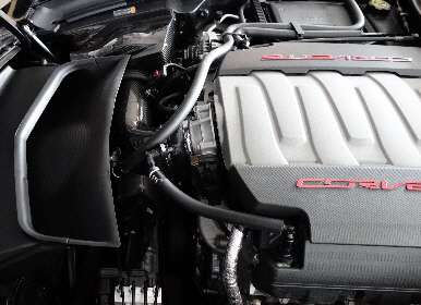

Here's the Stinger installed, again without hose clamps on re-routed coolant overflow.

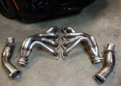

Next up are these American Racing Headers mid-lengths (with cats) that the UPS guy just brought to my house. Maybe too nice this weekend to be putting them in though - I want to drive!
Those look like shorties!

Yep, shorties - the American Racing Headers mid-lengths. According to ARH's site they are designed to "dramatically reduce" the chances of a CEL without a tune. Vengence Racing in the U.S. sells the Halltech CAI and ARH mid-lengths as a package that doesn't need a tune (the VR500 package) - this is where I got the idea for this set up. I'll see how it goes.
