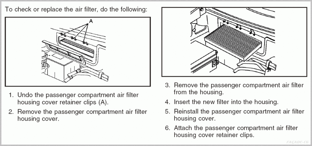

Very easy to do...Thanks for reminding me..will probably change mine this week :)...Its in the owners manual
There is an access door directly above the battery with 3 spring retainers.
Open the door and slide the filter out towards the front.
NOTE: There is a FLOW arrow on the filter, so it is installed the correct way
