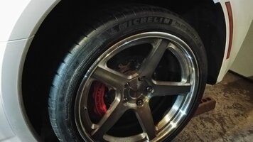

Yep, did 325/30/19 PS4S on 12.5" wide wheel (Forgeline).
Looks good and no problems at all. I know 325/30/19 is listed to be mounted on a 12" max wide wheel.
I'll find a pic or two and edit this post with them.

You will be fine, my pic and videos of my Forgeline wheel shows exactly how the tire will fit on the wheel.

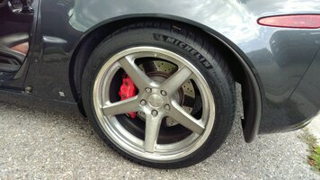

The Apex rear wheel is actually quite conservative when it comes to what offset they go with. I can't remember the offset of my Forgelines but it is slightly more aggressive (I have specs at home and I can post it up later when I'm there). My rear RSR wheel is very aggressive with a +47mm offset on a 20x12.5" wheel and fits no problem.
Tony
Checked my rear Forgeline wheel specs that I had written down before I sold them. They are a 19x12.5" +52. The Apex 19x12.5" wheel is a +55 offset. Basically if you could overlap them on your car they are very close as illustrated in this site I use when I spec wheels:
Compared to the factory 20x12" rear wheel here is what the Apex wheel will look like:
The Apex wheel to my RSR wheel:
Another better picture below:
