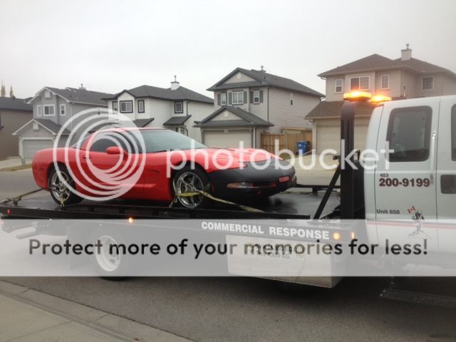

YUP , here is yet another Corvette on its way for the Dasilva Motorsports treatment .
This one is going to be a monster . I will post up the details later :canada:

Ok kids , here is the build sheet for N20's 2002 Corvette :
1. ECS Novi 1500 CS kit
2. Alky Control Meth Kit
3. LG Super Pro Headers
4. 160 Stat
5. Dasilva Motorsports stage 3 Blower Cam'
6. Brian Tooley Double Spring Kit
7. 383 Forged Stroker kit - Weisco Blower pistons / Callies Crank / H beam Eagle Rods
8. C5 Zo6 Rear Diff - 3:42 gears + Hardend Hi-PO short & Long shafts
9. Pfadt Rear diff Brace
10. ECS trans & Diff girdle
11. RPM Level 6 4L60E
12. 3200 VIG Stall
13. FAST 92MM INTAKE
14. GM ported 90 mm TB
15. LS7 Z06 MAF
16. FAST Fuel Rails
17. Lingenfelter Mini Tub Kit + Custom stands for the top
18. Flip Drive
19. ECS Stage 1 Secondary Fuel System
20. Racetronix Fuel Pump
21 Dewitts Blower Rad with built in Oil & Trans coolers
22. Custom widened Rear factory wheels
23. Michelin Pilot Super Sports 335/35ZR18 Rear + 255/ZR17 front tires
24. Dasilva Motorsports Installation
25. Dasilva Motorsports Custom tuning
I think were there and on our way to oooooh 700ish RWHP :D
