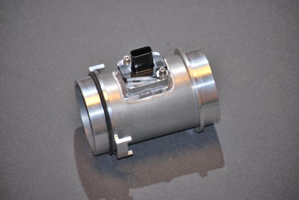

8. Installing a Blowerworks MAF system:
Replaces the GM expensive and delicate "hot wire" one with a 2005+ Ford Blade style MAF. Cheaper to replace (25 bucks), easy to find, very robust (drop it and no damage, try that with a GM Hot wire one) and higher flow rate. Also future proofs the car from early GM MAF being discontinued or needing to use "cheap" reproductions that set all kinds of fault codes. Does away with Burn off relays. Integrated IAT in Ford MAF if desired for logging, tuning or eliminating "heat soaking" the current MAT sensor in the plenum. Currently just installing a 3" tube, but easily scaled to bigger if more air needed. Bigger than 3" is not really required until getting into forced induction.
9. Custom BIN file to remove the cap on injector size and to read the MAF higher that 256 Grams/Sec (GM limited to 256 in the ecm hard code). New BIN goes to 512 g/sec. Can deal with turbo or supercharging as a "blow through" MAF if wanted.
