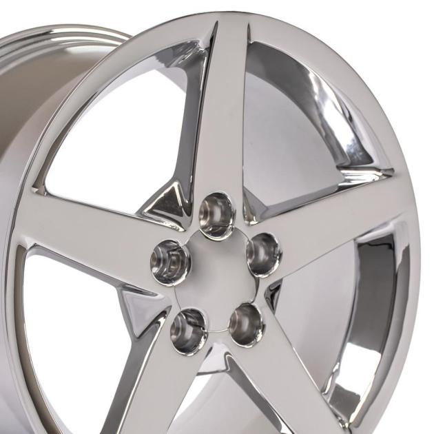

I have chrome spiders on my 09 c6z and would prefer comp grey spiders or 10 spoke, proving very hard to find, new or used.

Thanx again for the info, you may be correct, buying wheels may be a better plan. Factory wheels appear to be discontinued, so replicas is an option.
My concern about replicas is balancing, I read somewhere that the wheels in this link are lug centric, not hub centric, which to me
seems like a bad idea, not sure if the factory wheels are hub centric , more research required. These wheels are reasonably priced and shipped from Canada and available in comp grey.
