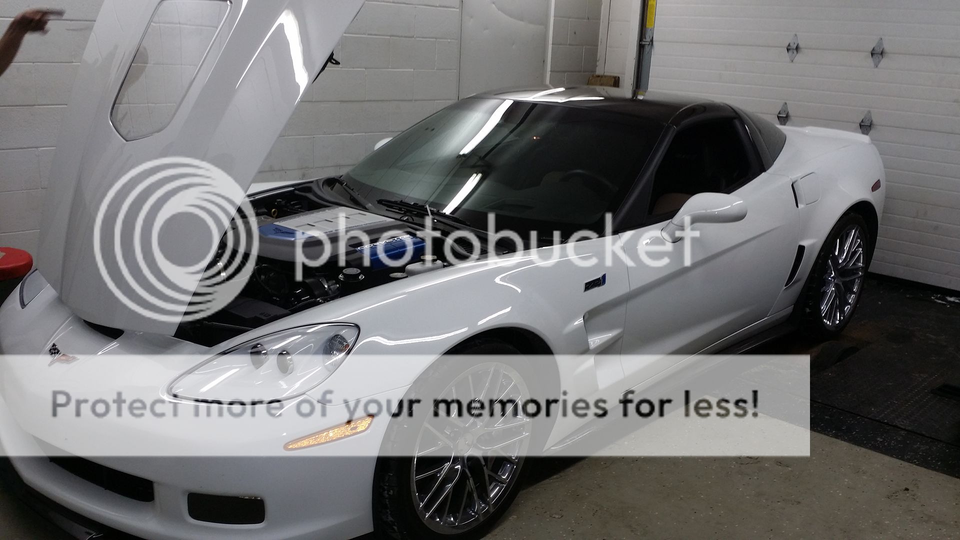

Well , if your Dasilva Motorsports .....you get up @ 5am , drive to Maple ,Ontario and pick up a 2012 ZR1 :canada:
Love a white ZR1
For this project 2012 ZR1 will be getting the full Dasilva Motorsports Spa Treatment to :D
LPE 710 Kit
ARH 1 7/8" headers with high-flow cats & X-pipe
Halltech CAI
ZR1 Track Wheels & Michelin Sport Cup tires
Baseline Video :

On some other forums I saw these kind of mods often + porting the snout, the throttle body and the top part of the blower. Approximatively how much more power will the porting gets to the wheels?
2012 ZR1 have 4 cats, does performance exhaust system have 2 or 4?
I am planning to do these mods in 2015 so I am starting to pick the best possible infos. Do you think these mods are the best to get good power, keep the car reliable and still get a good fuel efficiency on normal driving?

You are planning ARH exhaust, why not Kook on Pfadt or other brand?
These system are probably 3'' but the inlet of the mufflers are about 2.5'' is it really creating a restriction at this level of power?

The ARH comes with 2 cats ,and I perfer the ARH over the Kooks for fitment as well performance .

Will the job mean another tune do you think or will the 'puter be able to handle it without?
Just have to ask what may be a naive question. If a vette as new as 2012 has mods as these done to it would not most dealers void the warranty on the car???
