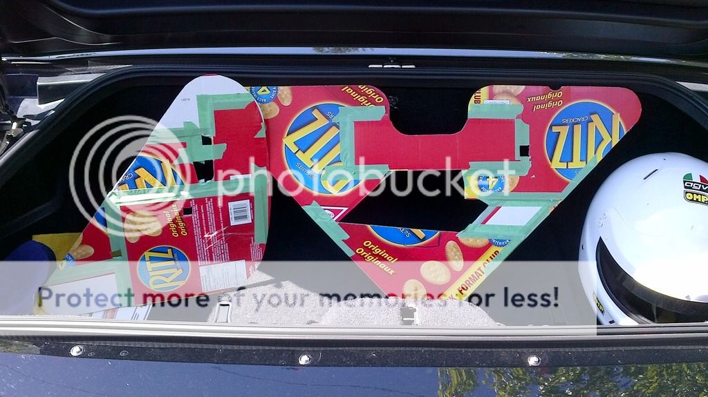

First made some templates..thank you RITZ..

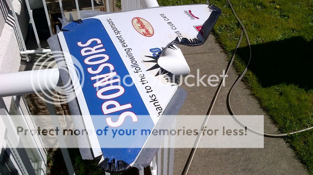

Then cut-out some corrugated plastic sheet to size..
(I used some old car show signs, this was my first prototype..)

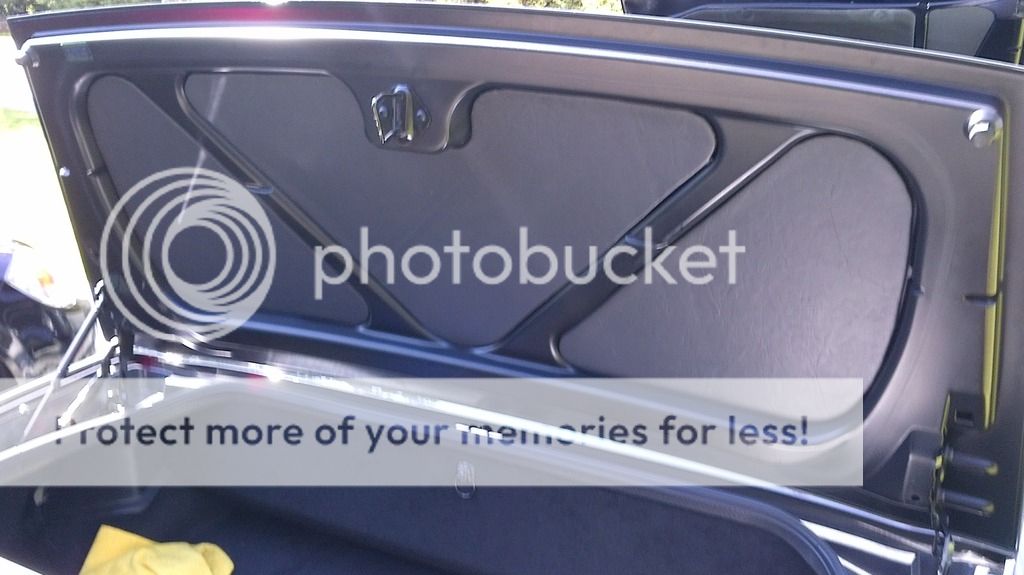

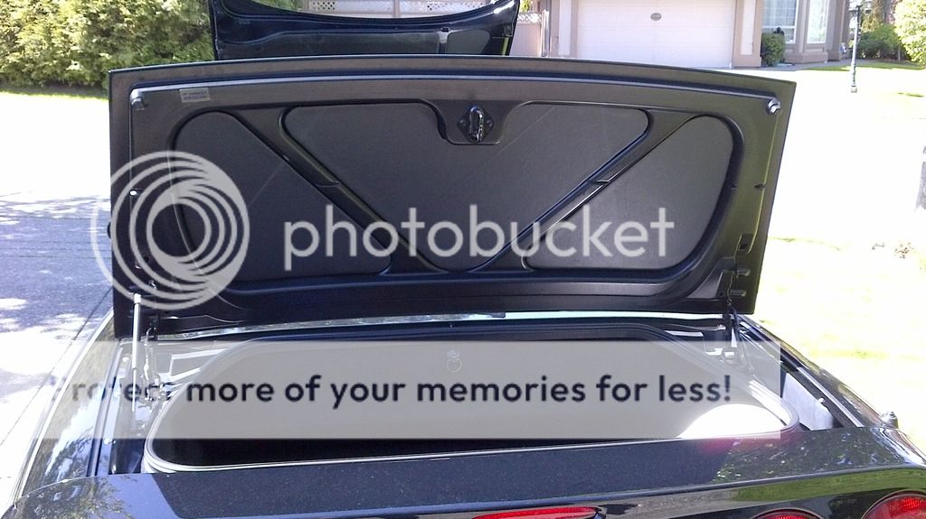

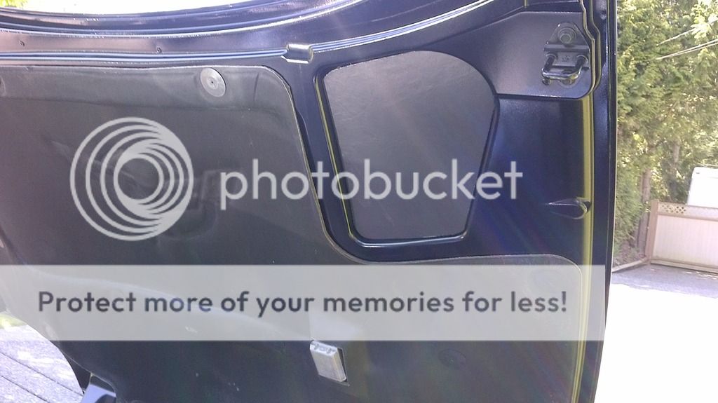

Add some velco and then insert panels....!! Done.
![](/proxy.php?image=http%3A%2F%2Fi216.photobucket.com%2Falbums%2Fcc184%2Fnascarmonte%2FCorvette%25202003%2FIMG_00001509_zpss9xu3xhs.jpg&hash=edf7ebf3e73f8c8851bca8c35cbb2d78)
![](/proxy.php?image=http%3A%2F%2Fi216.photobucket.com%2Falbums%2Fcc184%2Fnascarmonte%2FCorvette%25202003%2FIMG_00001508_zpsznt1i5ny.jpg&hash=ad32f36d0c1204a1fb5beaad4457443f)
