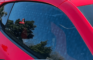

Anybody have this issue on any of their windows, if so was it covered under warranty? Not my car in the photo but mine is similar, I don't think it looks very attractive 🤮

It looks like it's delaminating! That would be a safety and a warranty issue.
IF it's only visible on certain angles and certain situations. If it's always visible I'd be concerned.
Generally most visible at 56 degree angle. I can see it in the side windows of my Tundra at a lot of different angles not just 56 degrees. Especially if the sun is hitting them .
If its daylight its visible but i don't want to look at it lol
Have you tinted your windows ? Might mitigate it somewhat. Just a guess.
But now that I look closer at that photo it appears you do have tint so maybe that makes it more noticeable. Bit of a conundrum, lol .

Funny, if it's that common you'd think you'd see it more often. All car glass is laminated so I guess a certain percentage would have it visible. <shrug>
So you think a guy should have to live with it? 🤔
If you take it to the dealer and it's clearly visible you can argue the glass is delaminating, but they'll likely ask the GM district manager for their opinion and you'll likely be denied judging by the info 1stvette provided.
My side windows have it, at certain angles and under the described conditions viewing angles and polarization, doesn't really bother me, and I just ignore it, as suggested by our resident "Pilkington Glass aficionado". Kudos to 1st Vette (also a glass nerd?).

You are absolutely right. Normally I cannot see it with the naked eye very well, but it shows on cameras and with my sun glasses. I have seen this with ceramic tint all all my last 4 vehicles that where tinted with XPEL CS.
When wearing my polarized sun glasses and I can see it in other cars on the highway as well with or without tint.

I have noticed that as well when wearing sunglasses. Really stands out then.
